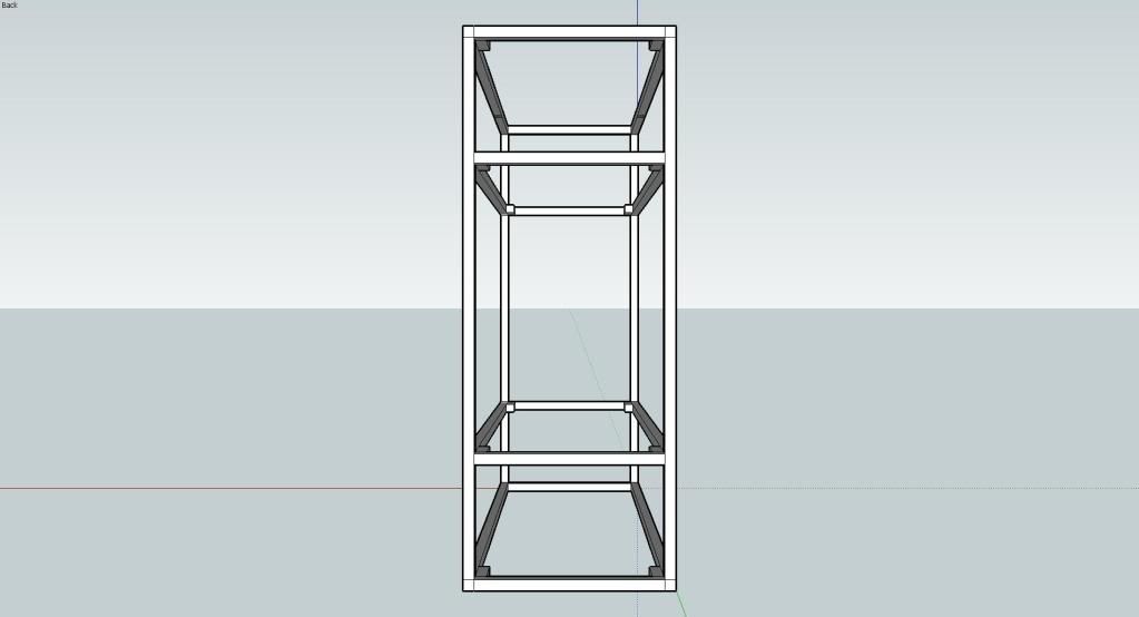

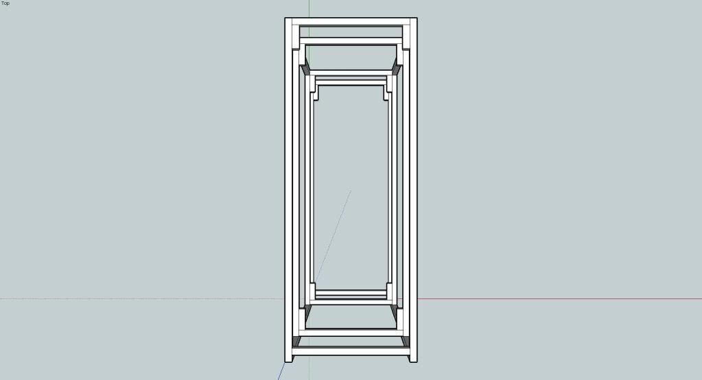

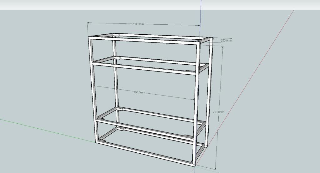

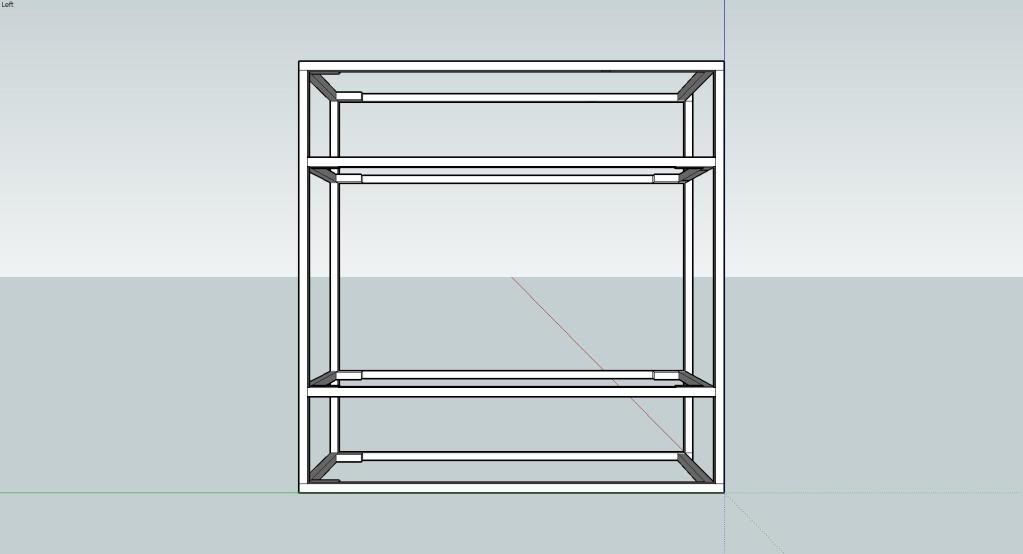

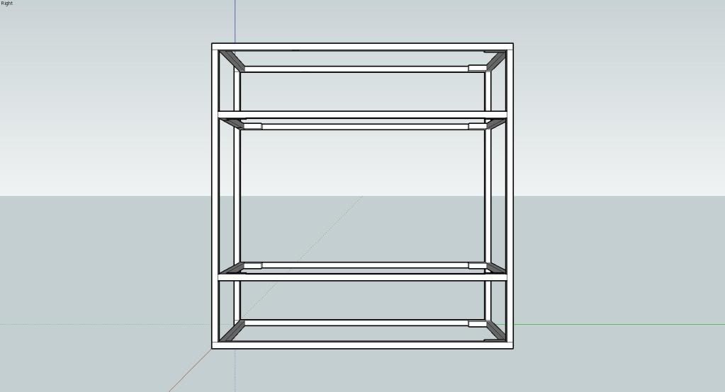

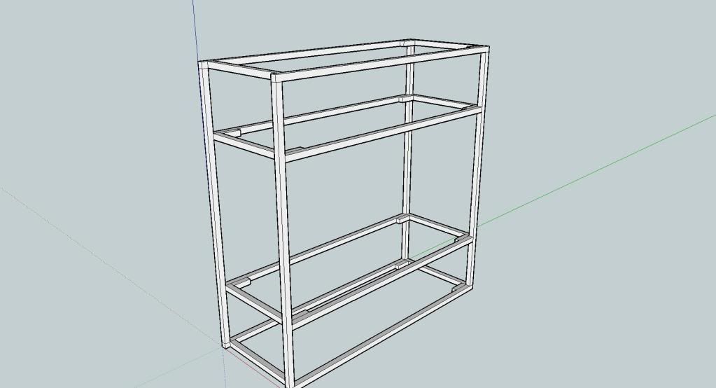

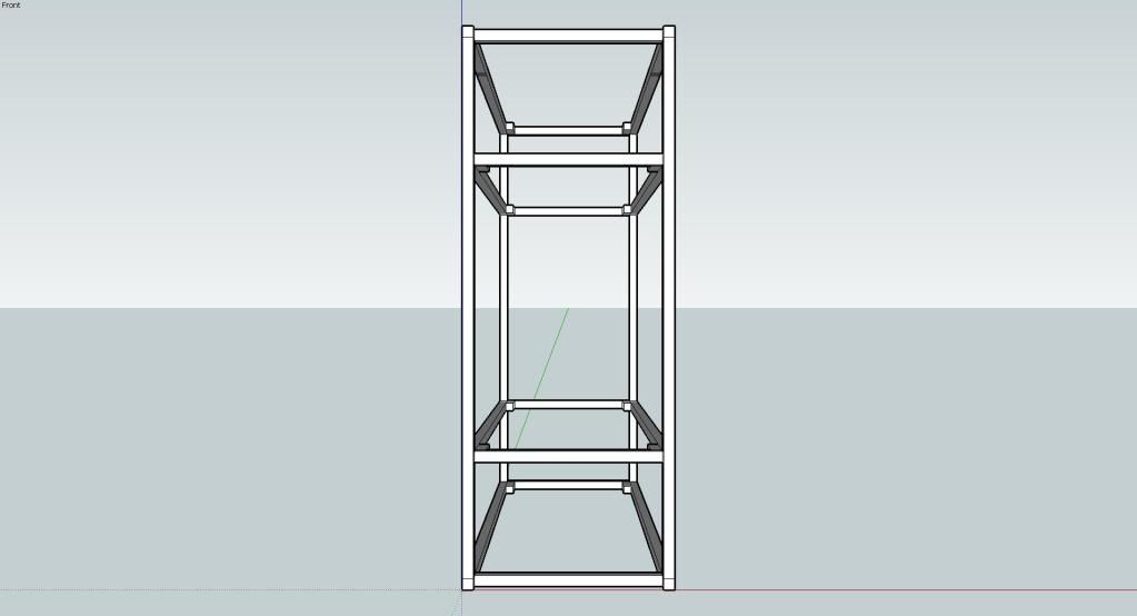

    These are the Frame Plans:
    Back:
    Front:
    Isometric
    Left
    Right
    Top
    Dimensions

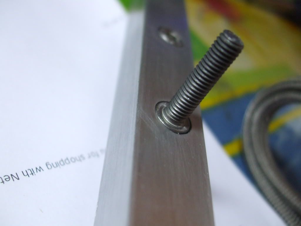

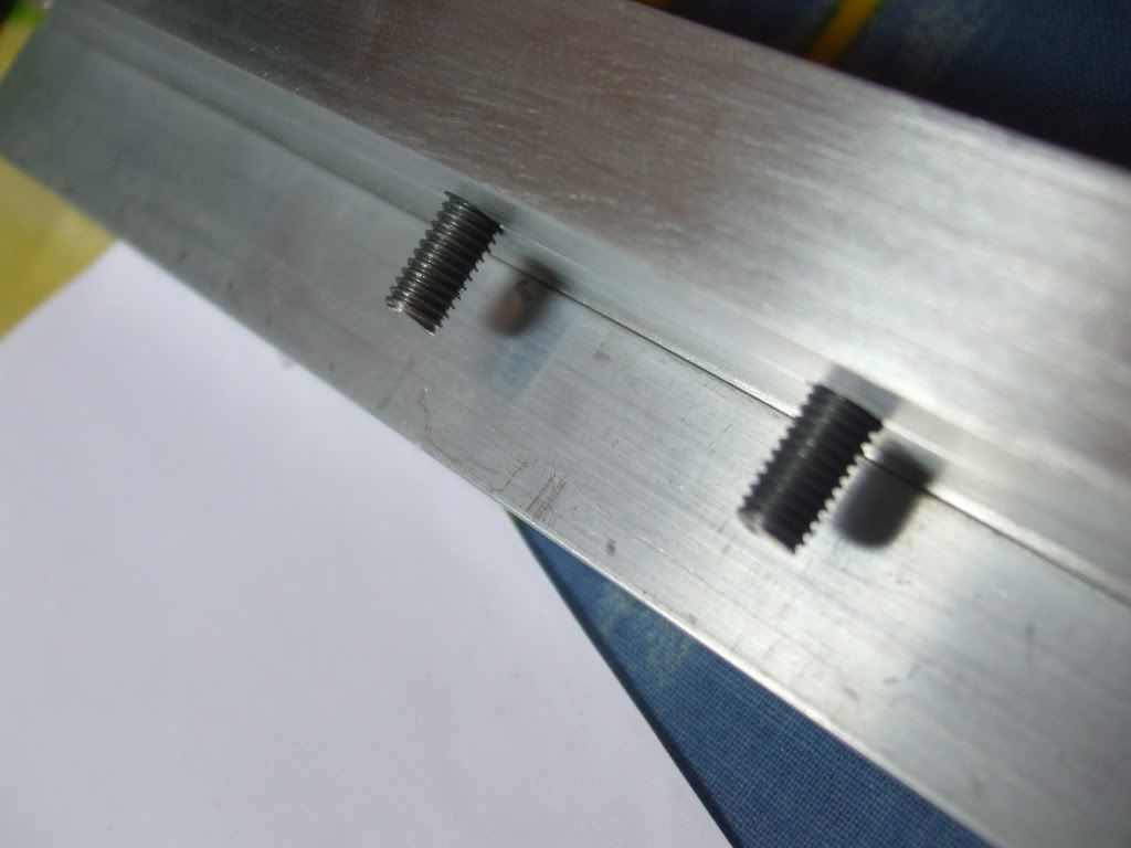

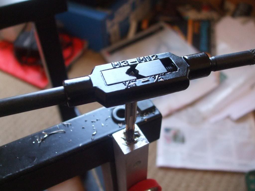

    As for many things there are certain ways to go about doing them and not all of them work so this is where my prototype’s come in, I had many ideas that I would like to implement into my design some have evolved from my design board to actual life (with the help of my Design Teacher & My Step Dad), these range from very small things to large things, also some of them a secret to surprise you all later on in the build.

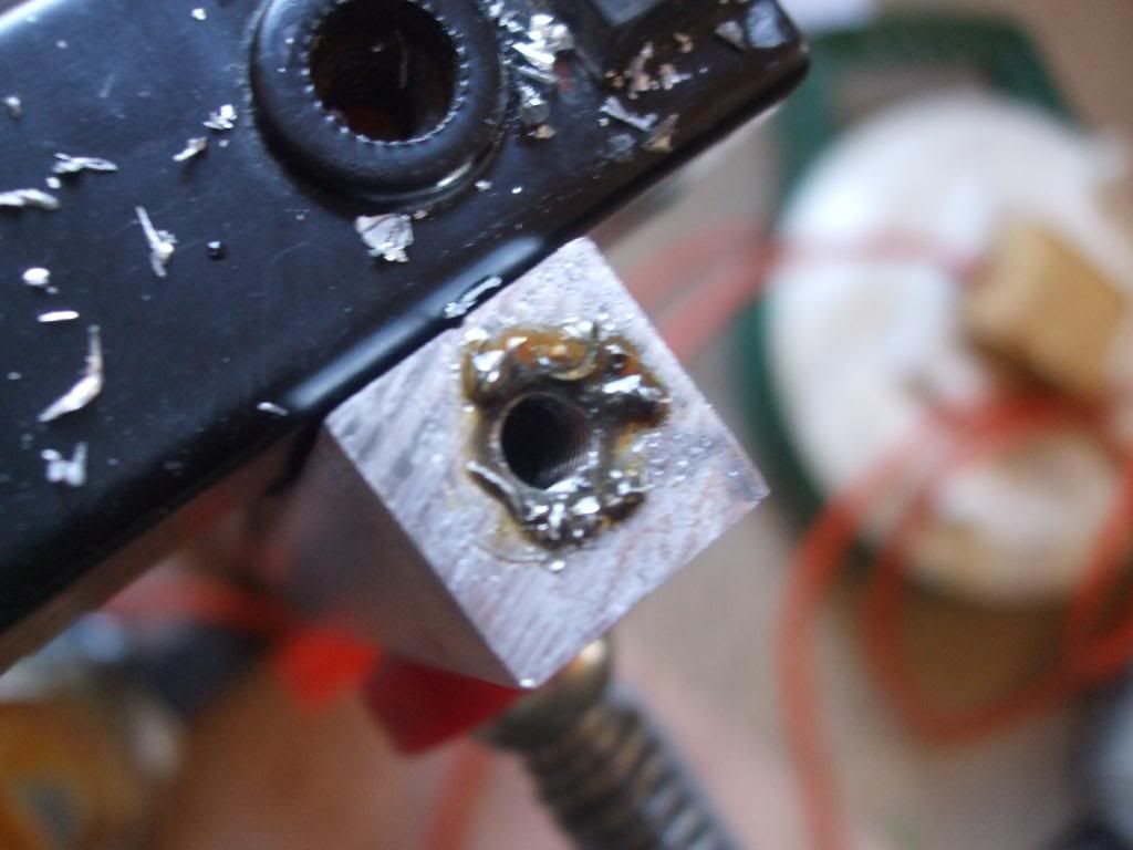

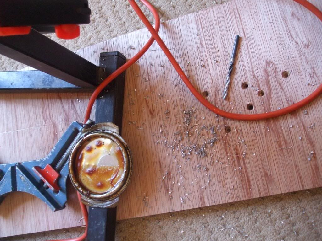

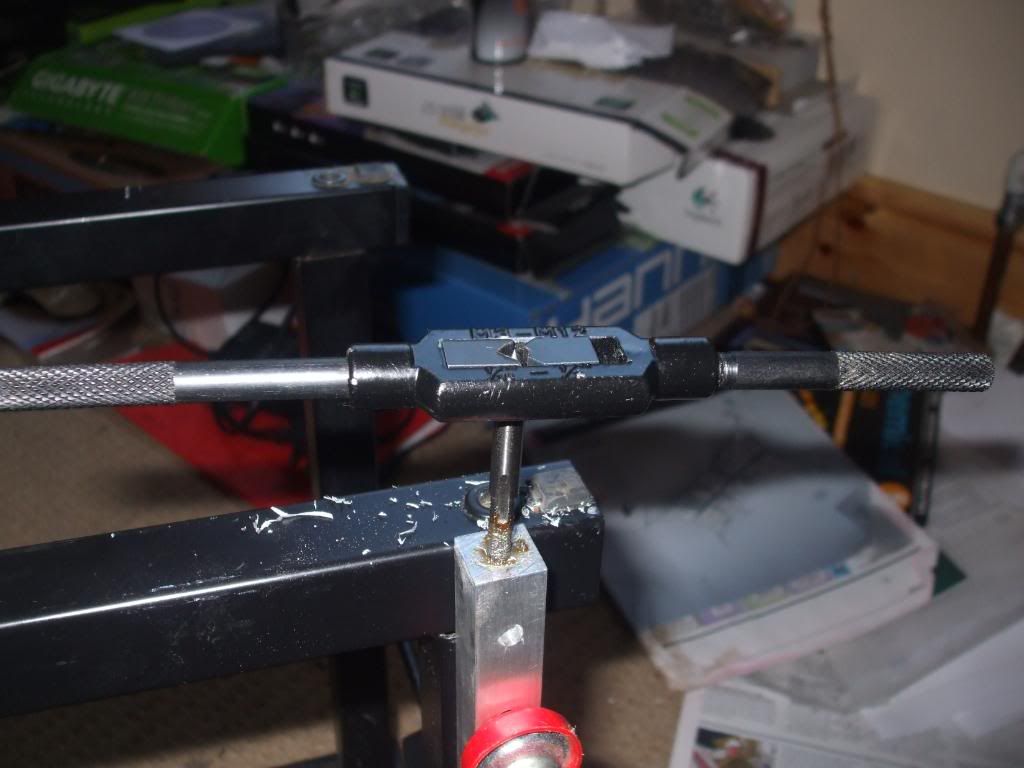

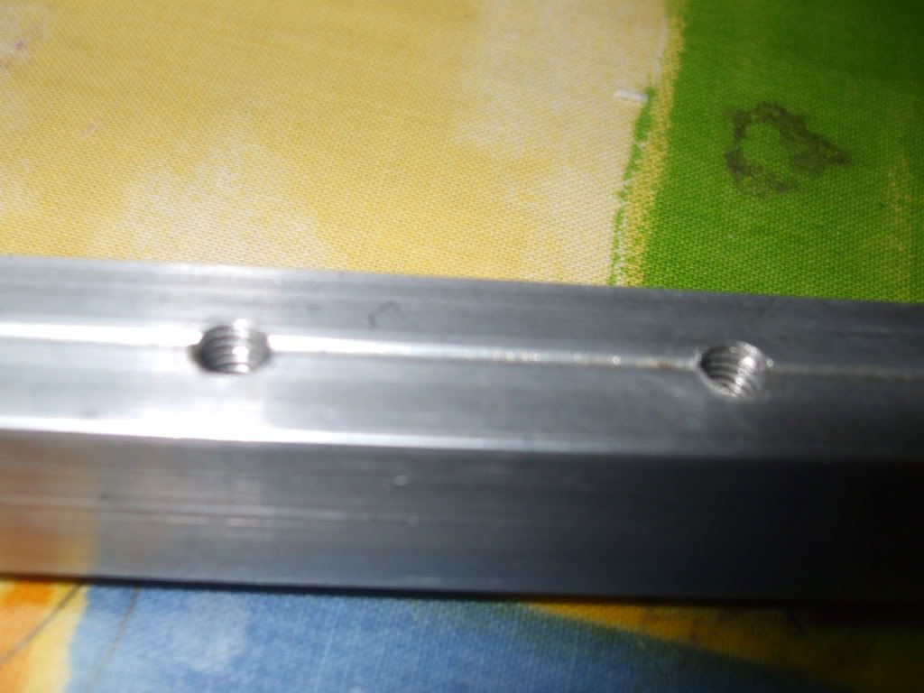

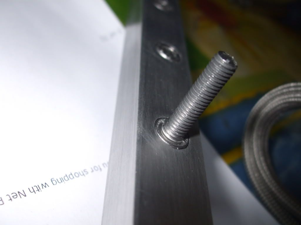

    Aluminium Joint’s/Cuts/Tapping/Drilling:

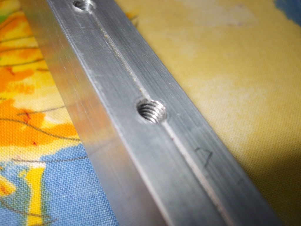

    But here is the prototype for the aluminium joints. I ordered 500mm bar of 5/8” x 5/8” square bar, to start testing the joint’s/cuts/taping/drilling to see if was actually possible, and it was here are some of the results:

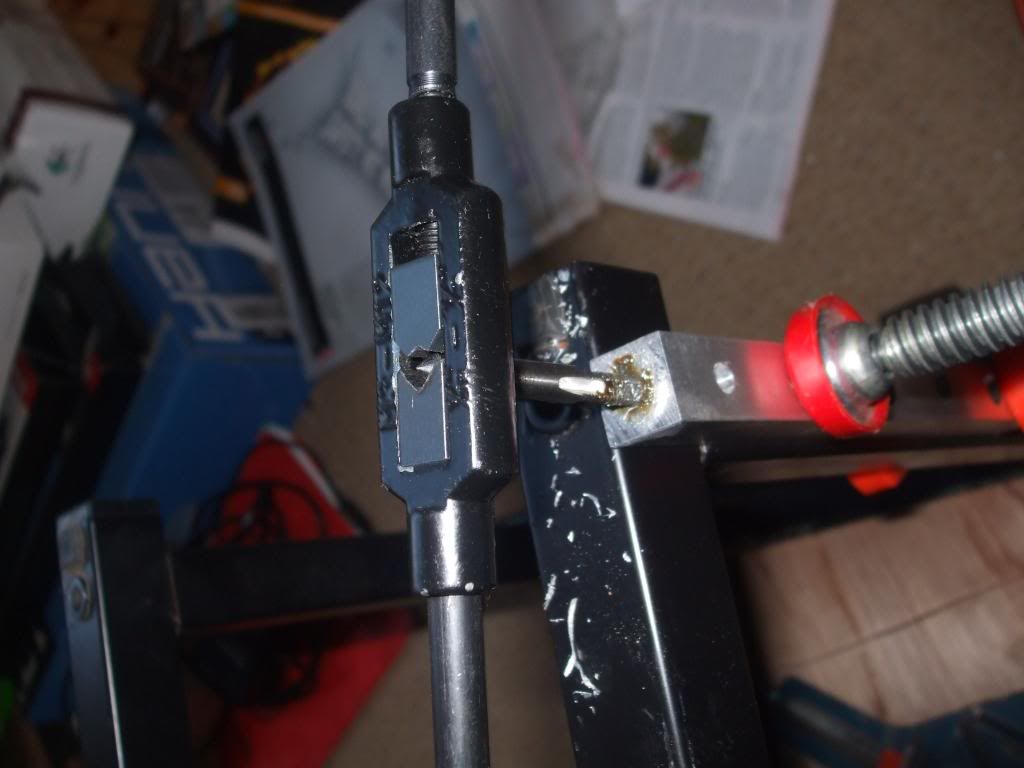

    My First Ever Taps (Took a while but was well worth it )

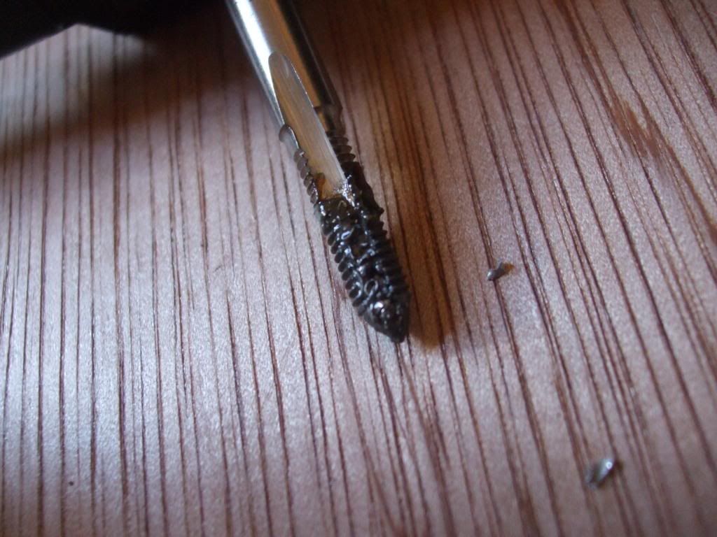

    Starting To Tap The Holes (hardest bit)

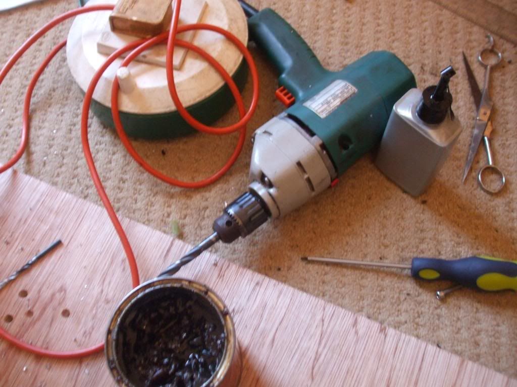

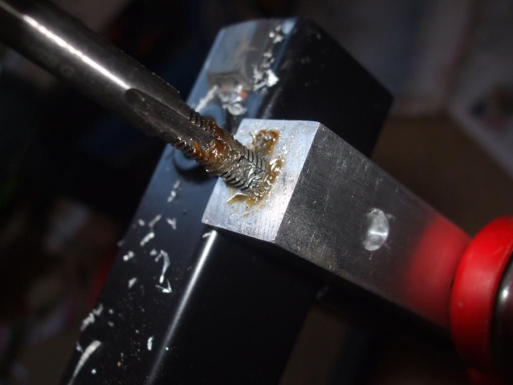

    Mess Made From Tapping
    Selection Of Tools Used, The pot of black/brown stuff is metal cutting lube
    Horrible "Gunk" that appears while tapping
    Closeup of "Gunk" on the tap

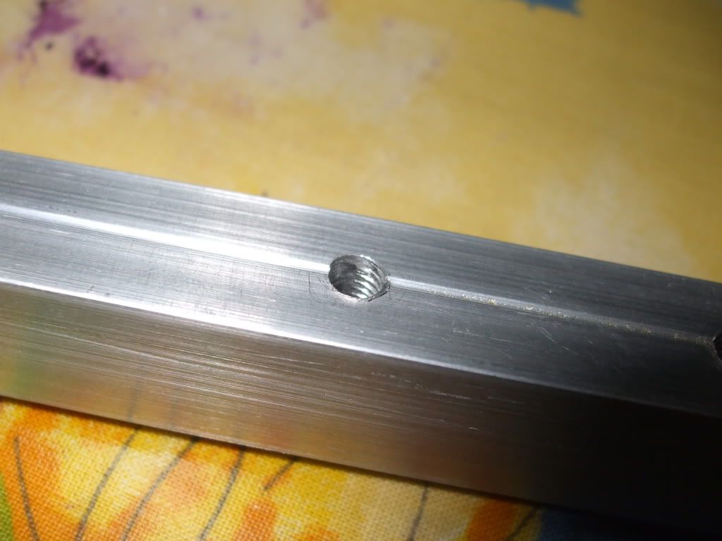

    "Gunk" on the bar and the nice clean-"ish" threads in the hole
    Checking The M5 Bolt fits in the thread

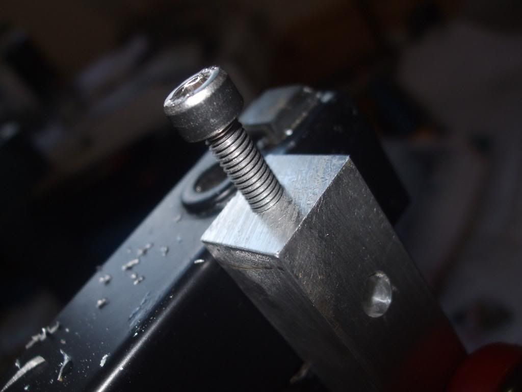

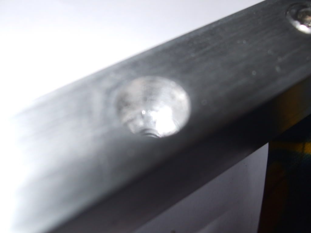

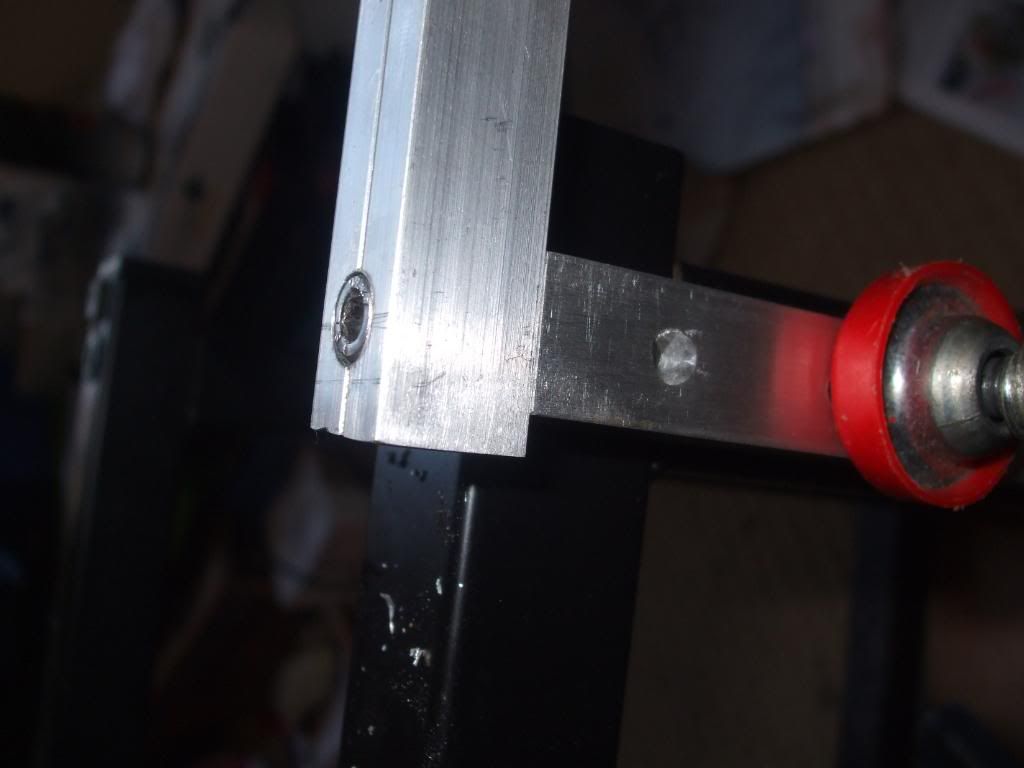

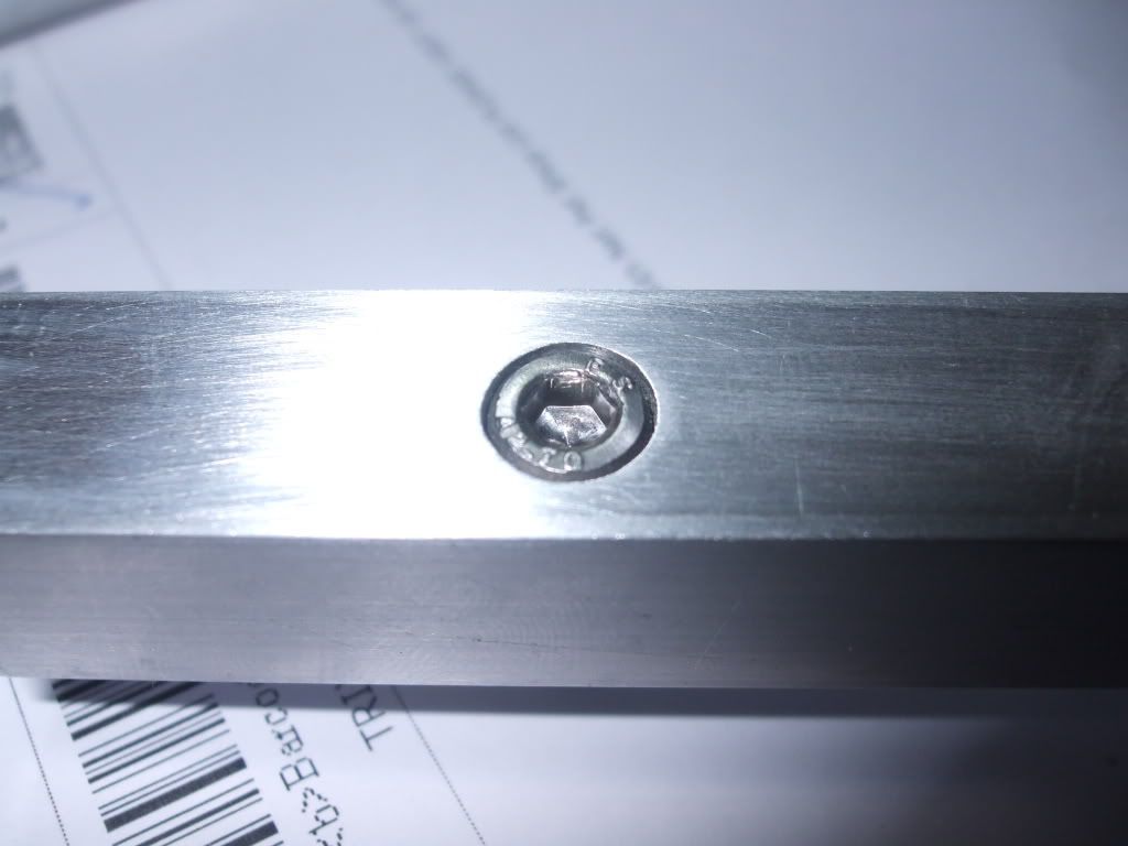

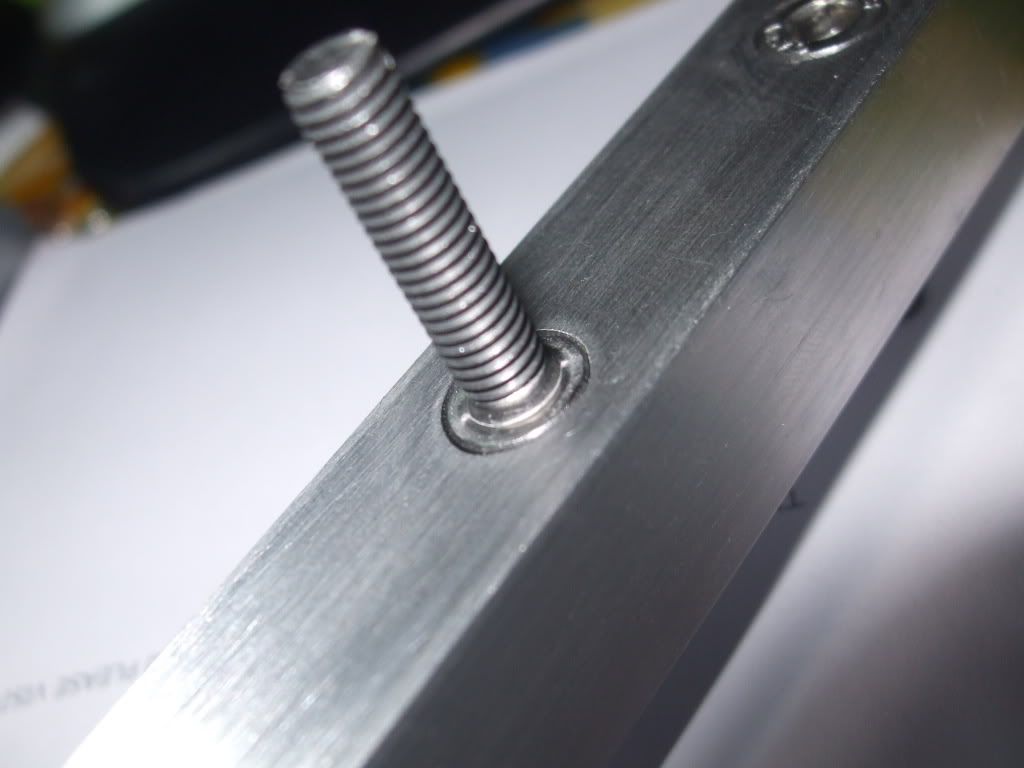

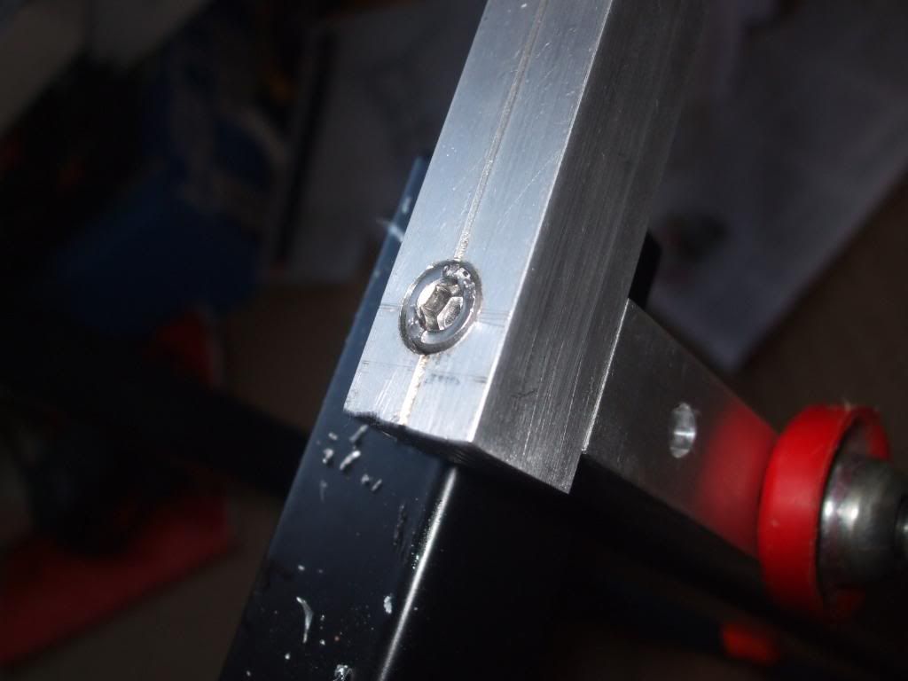

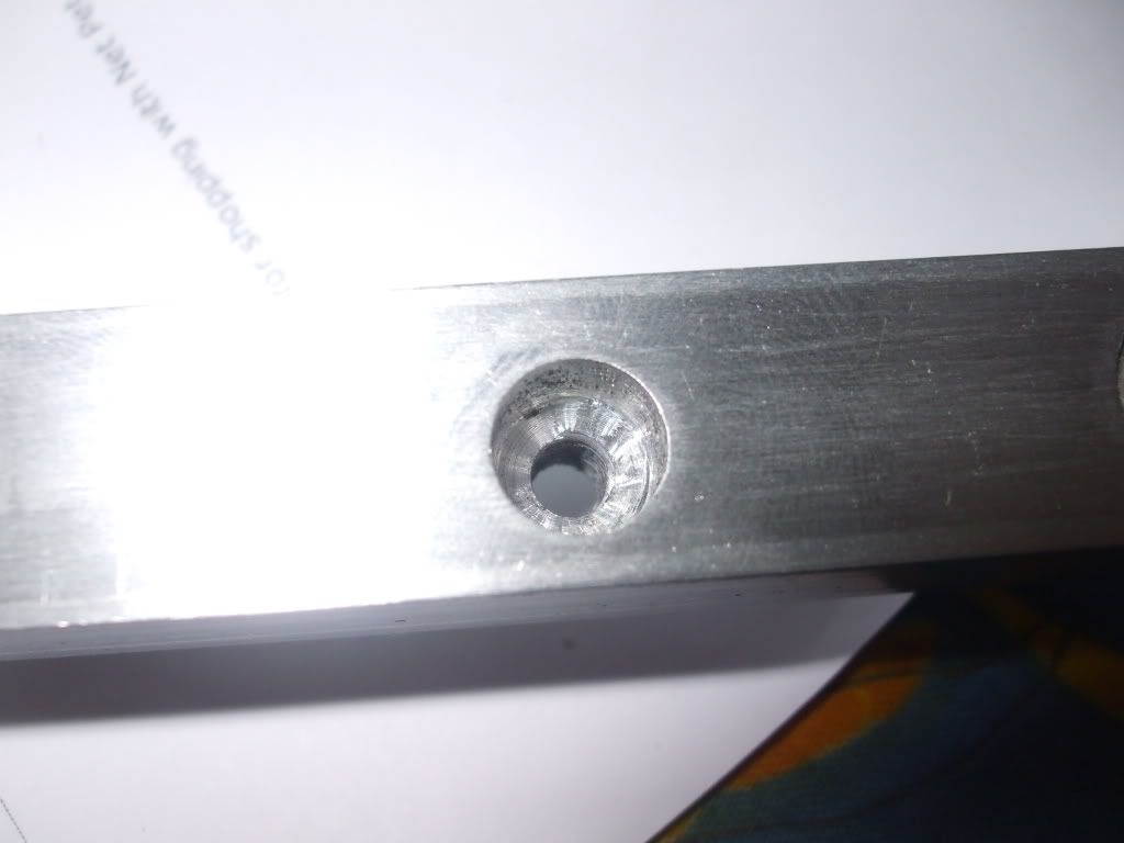

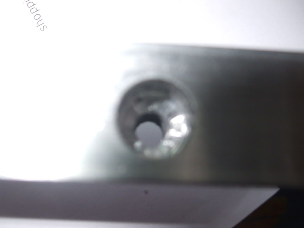

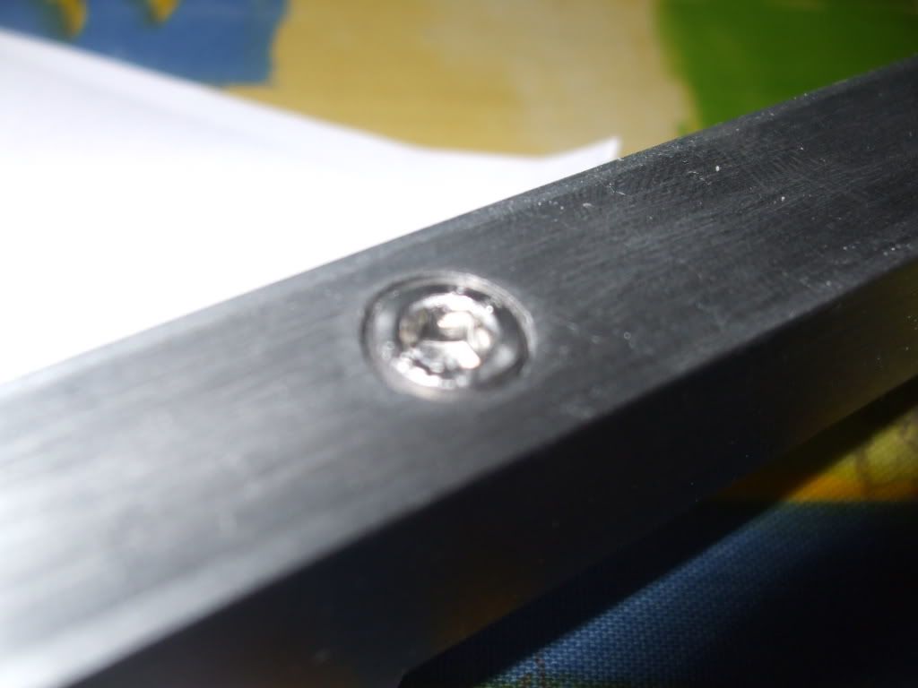

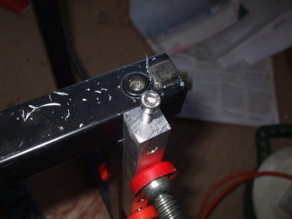

    Counter Sinking
    Flush Countersunk Joint
    Countersink Head test
    Flush Countersunk Head
    Countersink Hole
    Countersink Hole
    Countersink Hole
    End Countersunk Result

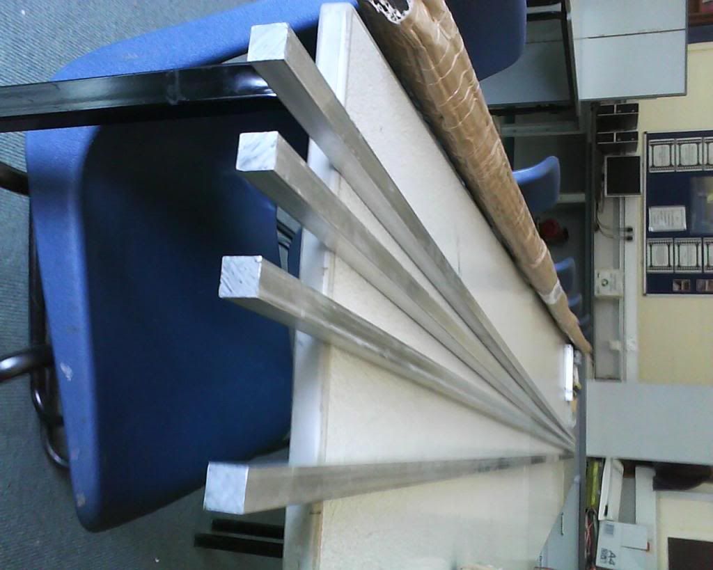

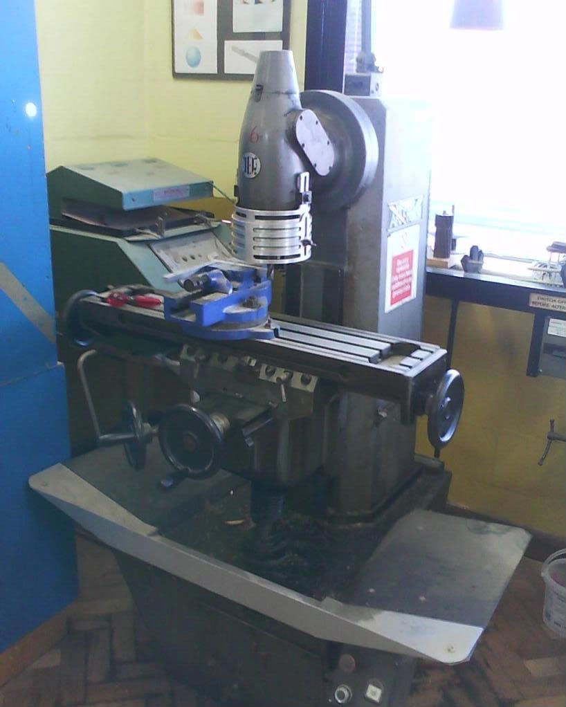

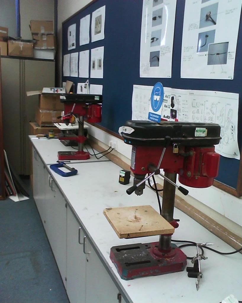

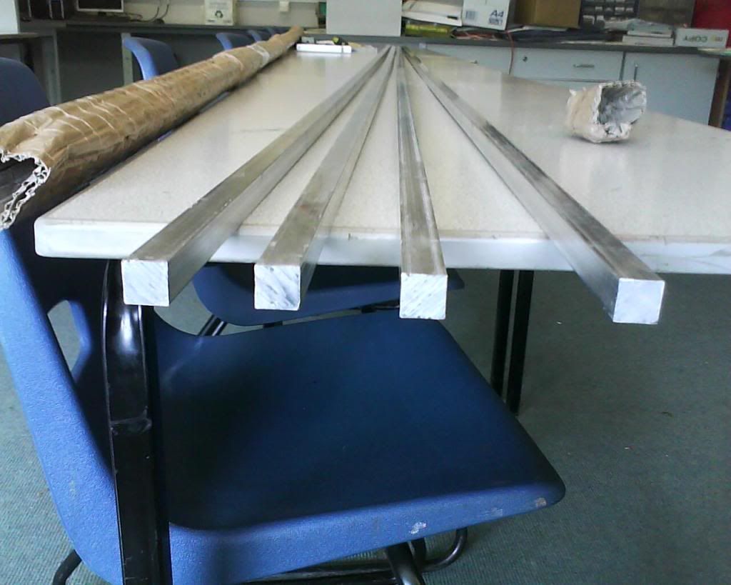

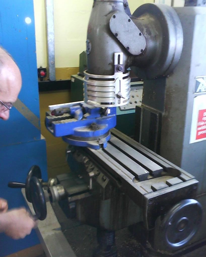

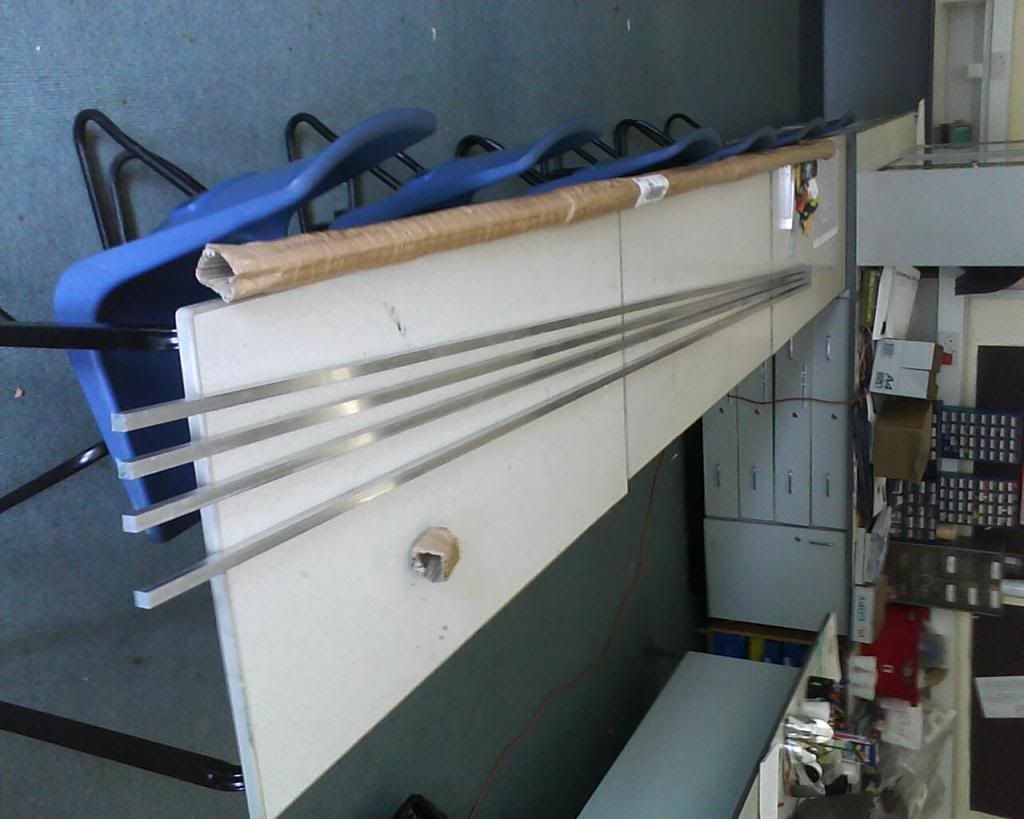

    Well Some updates from today . Apologies for the poor pictures as my digital camera ran out of battery's before I could even take the first picture (dam sister not charging it ) so had to resort to my 1.3mp phone camera *crap phone*
    Aluminium Arrived and had to help the guy get it off the truck lmfao, only just vertically in the room 10ft some pictures below:
    Package:
    Out of package:
    Ends of the bars:
    As for my new workshop/work area, here are some of the tools that are at my destructive disposal :
    Milling machine:
    Milling machine being operated:
    Big pillar drill:
    Mini pillar drill:
    Hope you like the update
    Should have some pictures of the work done on the milling machine today ***Only with the test piece though*** see if it cuts square.

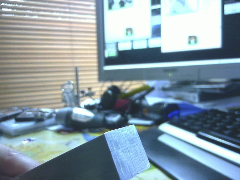

    Here are some of the pictures from the milling machine and squaring off the bars :
    They show the ends being squared off after using the milling machine on them.

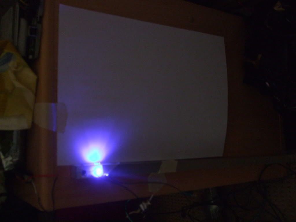

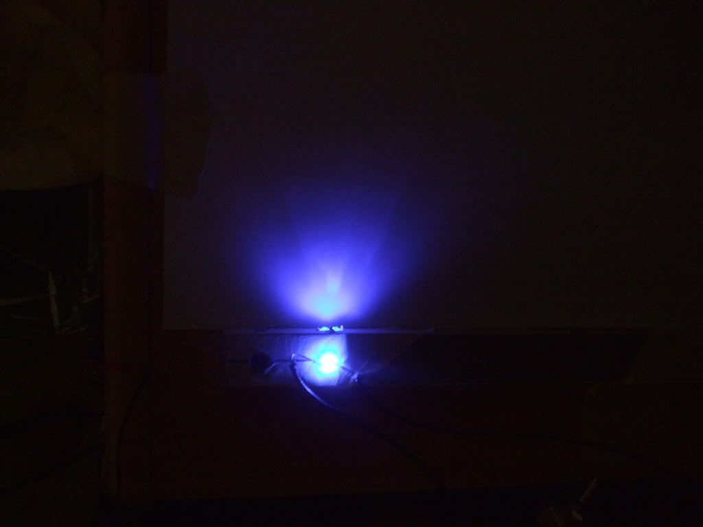

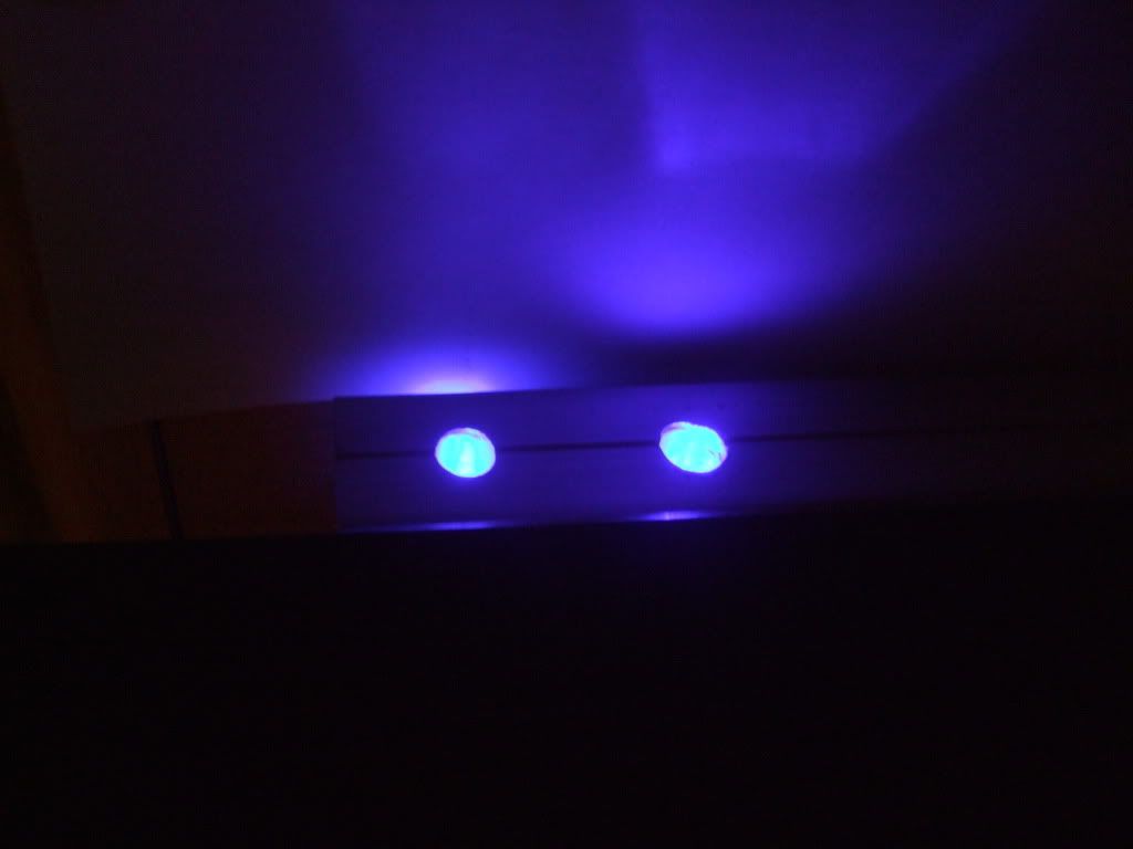

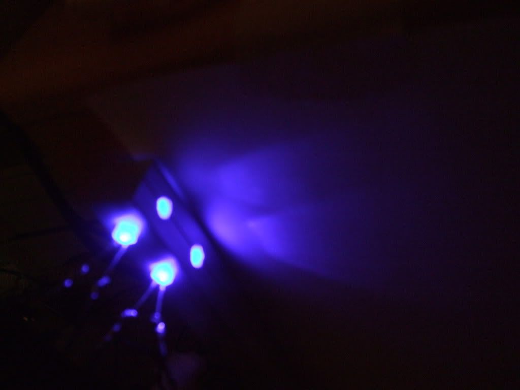

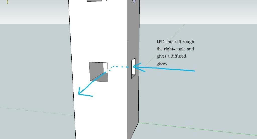

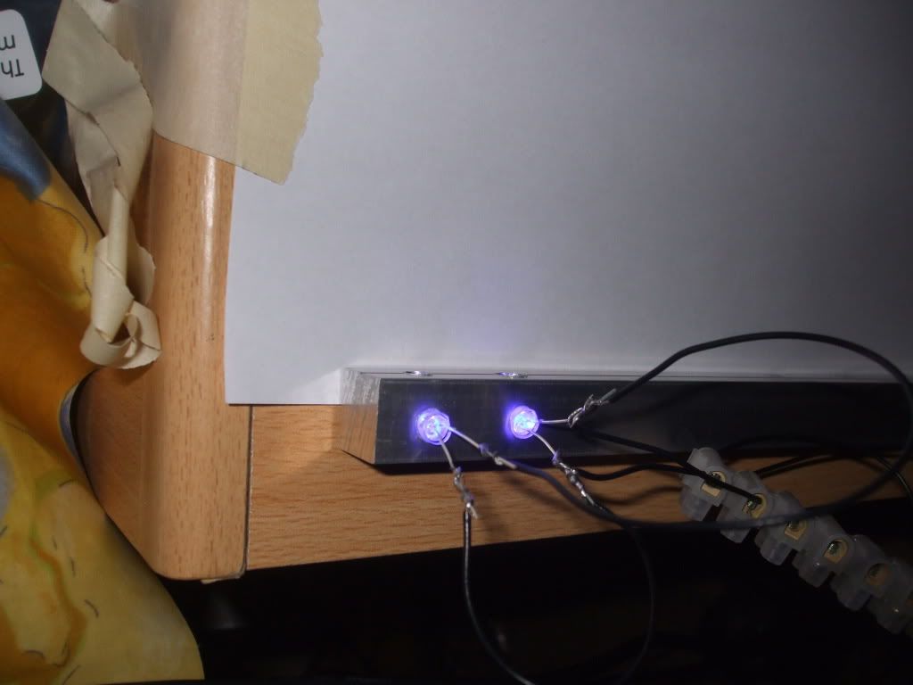

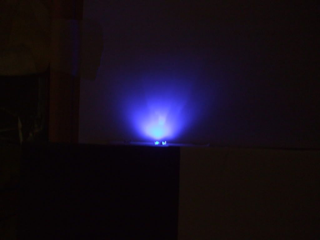

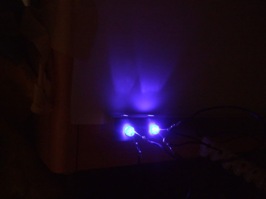

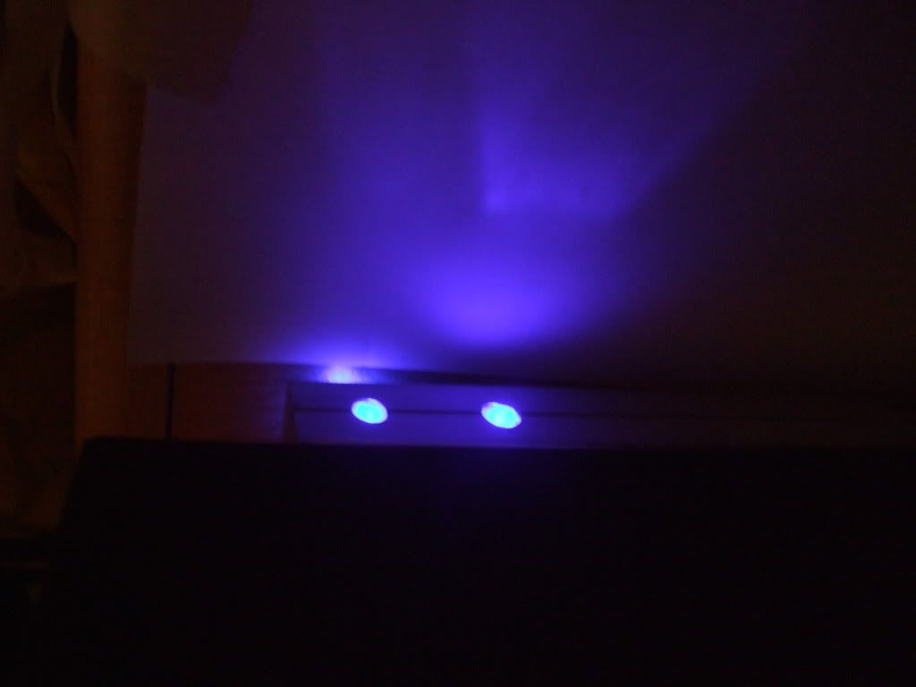

    Lightbulb Anti-Glare LED's
    The main light colour for the case will be blue, mainly becuase I'm like addicted to the colour :S this lead to my second addiction a well know auction site so I was able to pick up some "Ultra birght 5mm Blue LED's" for bout 9p each. 200 of them to be precise.
    These will serve various purposes through the build, I might use all of them I might not will depends on the use of them
    Well being a normal human being I like LED's but the full on glare you get from normal LED's can sometimes drive me mad especially directly on the front of case's so I had a think about how I could solve this problem with the materials I would be using, and came up with this idea to give a diffused glow across the front of the case. Like so :
    This then led me to work on the prototype bar that I used to practice taps/drilling/etc.
    In my opinion came out with some quite astounding results that worked way better than I ever had expected.
    Simple setup after drilling the 5mm holes:
    The 2 LED's rigged up ready for testing in the dark:
    Using one LED on results:
    Using two LED's on results:
    Don't worry about the fact you can see the base of the LED lighting up as this will be in the case and will be screened out of the final product which should look something like this :
    Any comments on this are much appreciated ?
    btw the LED's are blue-er than that in real life.

    that looks really nice, similar to a concept I was working on in cad the other day for lighting. great job getting it done
  22. #22
    Aug 2008
    England
    234
    Quote Originally Posted by SNiiPE_DoGG View Post
    Yea I think it has turned out really well and gives a nice glow which is what I wanted and thanks for the comment

    nice work on the LED lighting. Definitely softens the light a lot, which helps to create more of an ambient feel to the lights, as opposed to the super-bright straight LED
