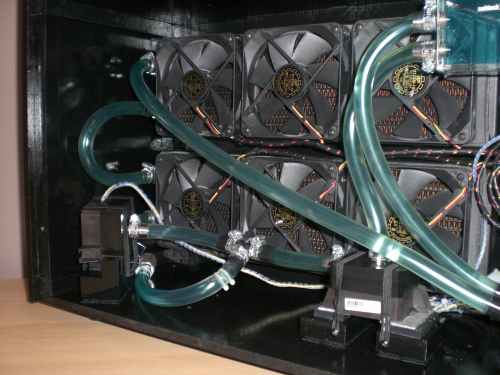

    Anyway, here's a picture of the radbox internals, showing the DDC pipework:
    All is OK, I'm sure you'll agree.

  22. #22
    Chasing After Diety
    Jan 2007
    Absolutely Speachless :O
    11,930
    lol u managed to lose me even now.
    i dont see what could be possibly wrong besides the card now.
    I dont see how the block would even get hot to the touch with that much radiatorage.
    Do you see water movement in your res? so you see water being run though the system?

    Yeah contact in those pics look fine.
    I almost guarantee you have some type of flow problem. I can't imagine you somehow blocking flow of the gpu block unless it is the threads of the fittings.
    Did you open your cpu block to make sure it wasn't plugged up?
