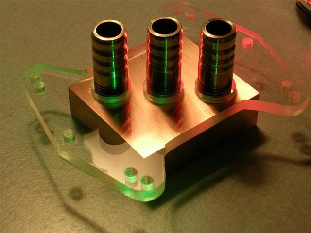

Update 10-16 Top Block Progress
Underside:
Top down view:
Update 10-17 Sand Blasted Base, finished top block, finished perimeter, machined base
Updated 10-18 Finished assembly, temporary hold down plate, installed and getting ready to test..
