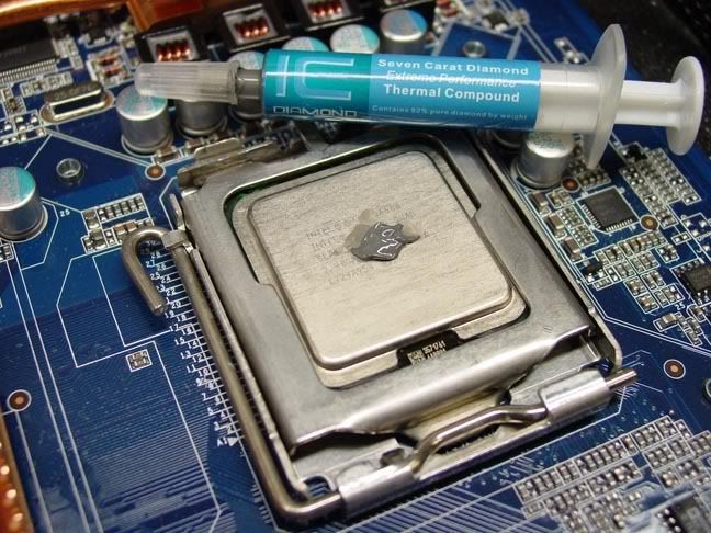

    Hmmm, I started a cure test with one of my machines which was re-shuffled parts from my prior reports. This one is an IP35 Pro, Q6600, TRUE machine.
    D7 applied, reasonable pea size, pic below.
