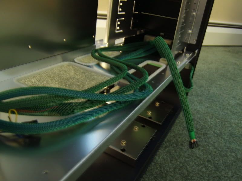

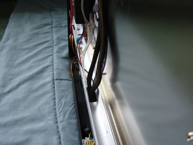

I started off by sleeving the cables for the front panel audio, usb and power. I used techflex ogre because I wanted something a lil different from what everyone else has

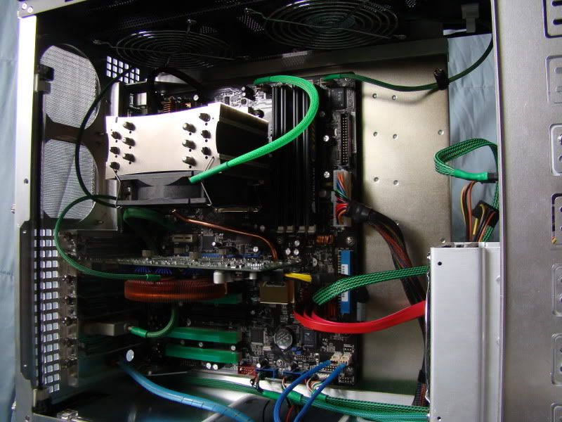

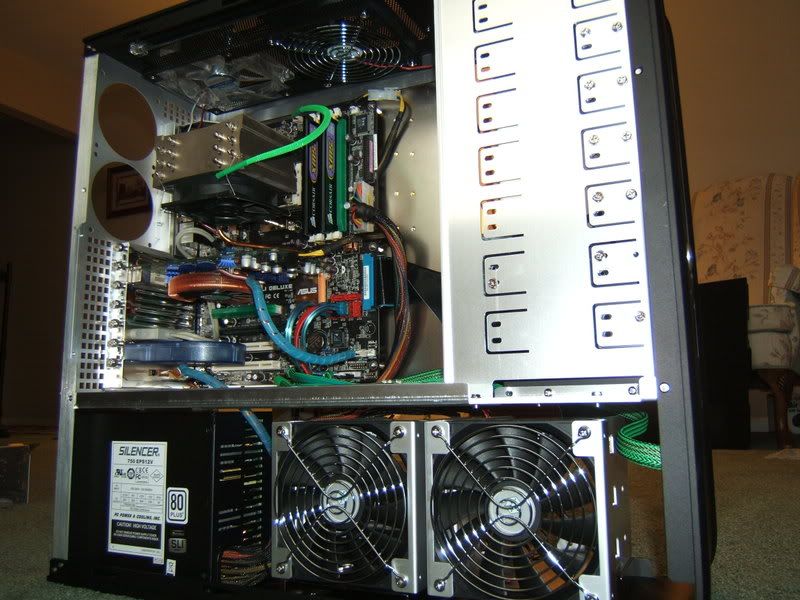

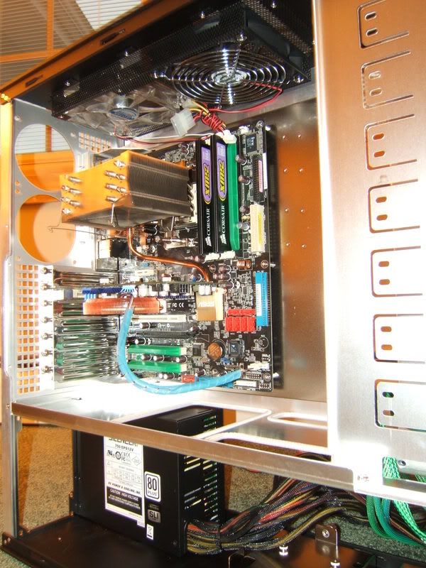

Next, I started adding in my components. When I pulled my board out of the old case I left the heatsink on to allow my temps for cpu to be directly comparable and not have to consider differences in mounting or thermal paste amount. I also adjusted the top fans, I swapped out the rear one with a red led one that I had and have that as exhaust and changed the direction of the front one from exhaust to intake to allow for some cool air to come into the case. Also I pulled out the 2 rear 92mm fans since I don’t have airflow in that direction.

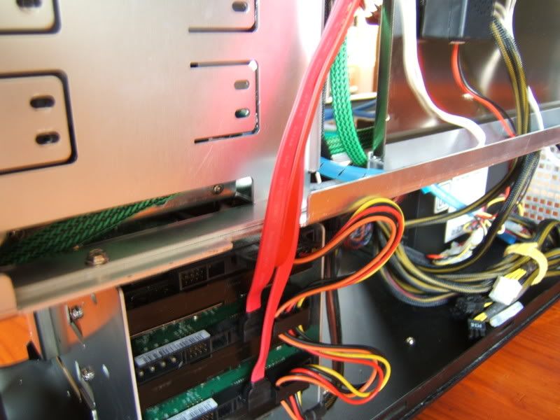

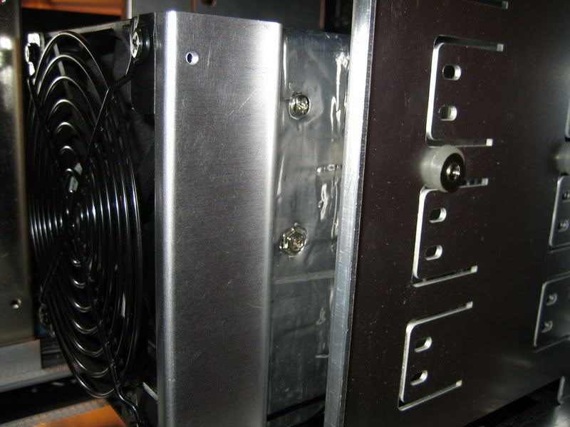

I then added my hard drives to the cages. I have 4 hdd so it was necessary to use both cages. One of them is a backup storage drive and happens to be ide, I was hopping to be able to mount the one cage up in the 5.25 area but was unable to quickly figure out a way to do so and scratched that idea. I may look into doing this later but not caring too much now.

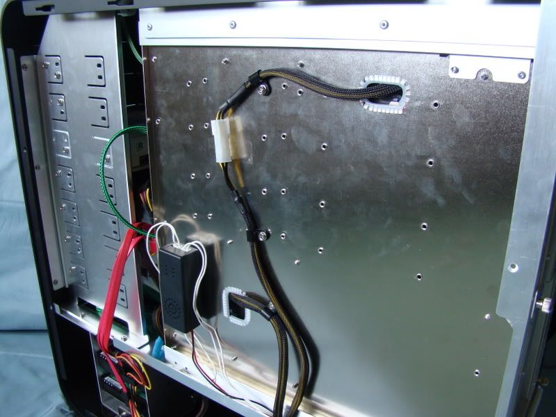

I had started off with the psu in the back slot but after attempting cable management found out that was a bad idea so I moved it to the front slot to allow all my extra cables to get stuffed behind the psu.

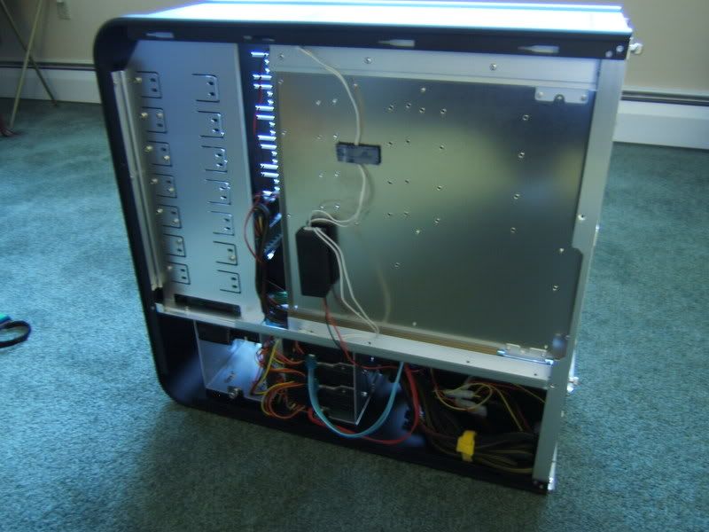

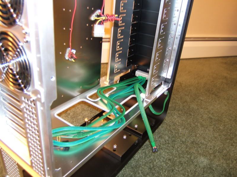

Heres a shot of the backside. No holes in the board tray, I’m not ready to drill into a $300 case
At this point I plan on sleeving the cable for the zalman on my vid card, the rear usb bracket and not sure what I’ll do with the pci slot fan and the switch for the UV cathodes. I’m not sure what color to do these, continue with the ogre or go with uv blue sleeve replacing the blue spiral wrap that I have on there for now.

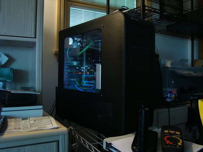

TJ07 is not bad at air cooling…depending on what parts you have. In my situation, my board and vid card temps went down. If I was running sli that could be different but I’ll never know.
I’ll also be replacing the stock fans shortly and attempting to hook them up to my hardcano 13…if I can get that to work. Since my temps are good I plan to stick with similar airflow fans, I don’t know the cfm of the stock ones but I’ll assume its around 35-40. I’m planning on going with some scythe’s, either minebea or s-flex
