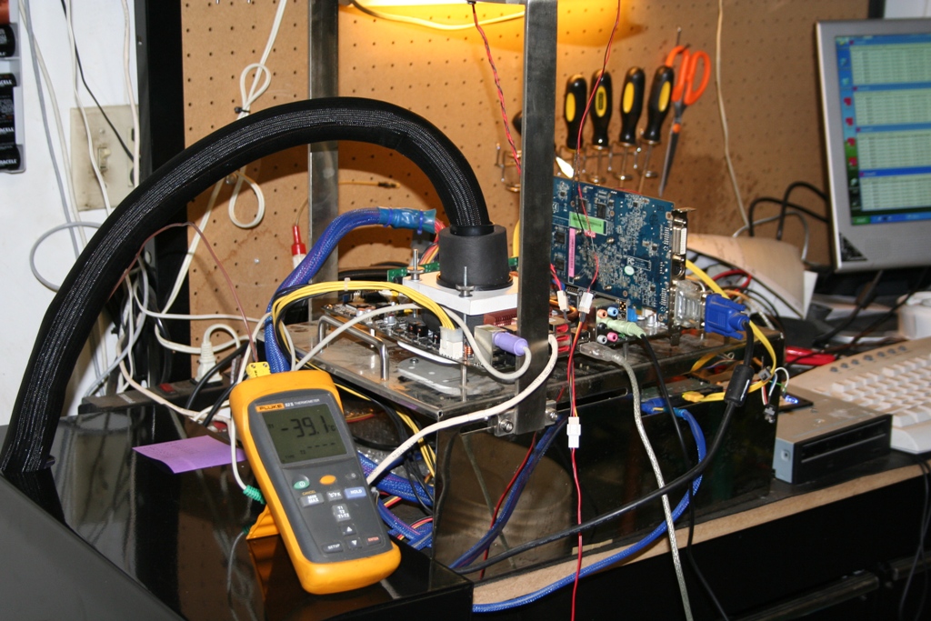

Basically the unit is 210-220w tuned unit (it can go to 230w around 19c-20c ambient but I typically give myself a little room due to different ambient condition possible with units I make). Since last post regarding 2 evaporator comparison under Q6600 G0, I've changed the unit so it won't be reading as cold of temperature under less load

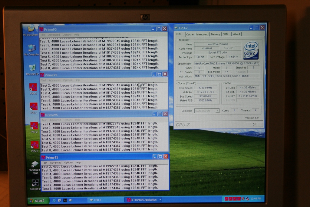

Basically skipping all steps, we went to meat of it... started around 1.6v and than decided to kick i up to max volt under Asus P5K-E since it wasn't stressing cooler much at all. Bios setup 1.7v reading from CPU-Z around 1.664v.
I've recorded the temperature of evap under load tester last night in preparation to know exactly what load I am subjecting it to (well I think it was about 1-2c cooler in the place today) and here it is.
Basiaclly, based on what I wrote down last night and comparing, this is only about 175w+/-10w!!! Unlike the Q6600 G0 which at same voltage and about 400mhz less dumping about 220w+/-10w.
I was actually hoping to see closer to 5ghz number but that wasn't the case... -__- (45nm and being unlocked multi chip and all...) This is pretty damned good news as I can see quad retail product probably going another 200-400mhz on default speed as product matures and overclock might stop around 200w-210w range which most of my product will cover quite easily (other than really early one tuned optimal around 150w and up to 180w..... even this might have some fun with reasonable overclock :P)
