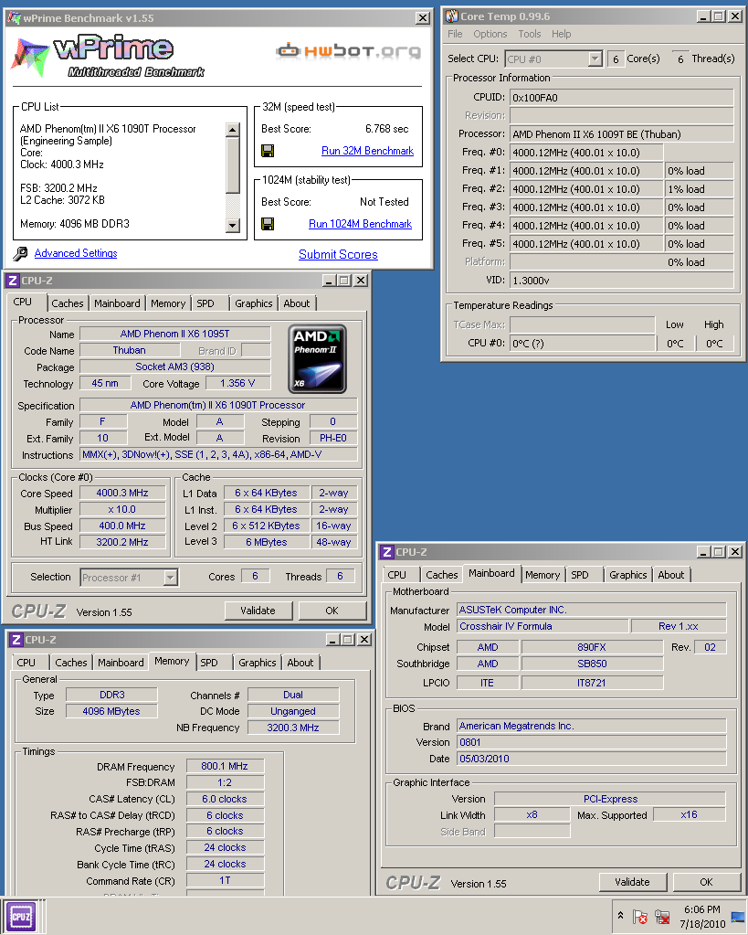

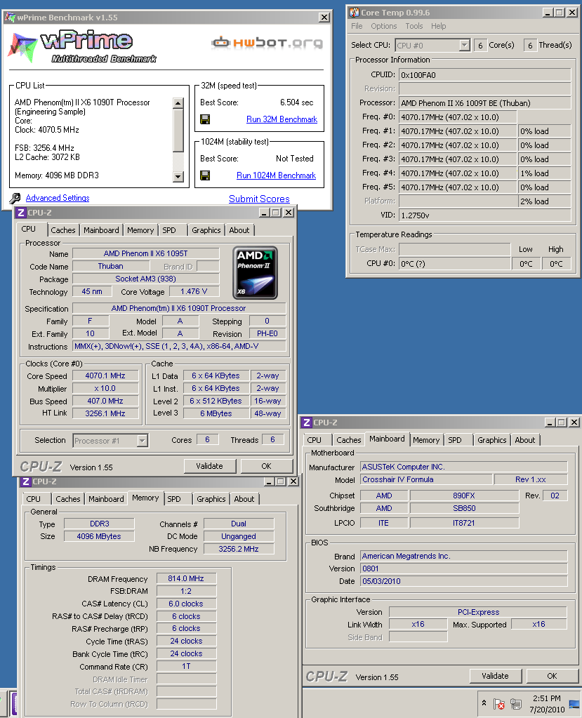

    Quote Originally Posted by Daveburt714 View Post
    Wow those are awesome HT clocks OT!
    For whatever reason I can hardly get over 300 with any kind of stability...
    Maybe I should flash back to 0801 (never tested it much).
    Dave the one thing that seemed to help with the higher HTT was to keep the HTL (HT link) and NB speed matched. Maybe I just got lucky hitting the settings the chips wanted but when I tried to boot with high HTT when the HTL was running at a lower speed than the NB it wouldn't boot. When I matched the speed it booted then when in windows turboV could take the HTT on up from there. This method worked on two different chips (thubans). I don't know if bios 801 is better than 905 for high HTT or not as I didn't try high HTT on 905?
    Quote Originally Posted by FlanK3r View Post
    OLDTIMER: HT link is impressive! Can u test winrar bench with this setings?
    The CHIVF is off the bench now so I can't run that bench test right now but I have a CB-10 and CB-11.5 + other bench tests @High HTT I can post up if you want?
