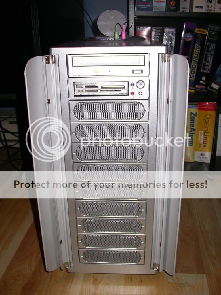

    This is basically an upgrade to a new in box, but 5 year old Thermaltake Armor (I really wanted an 800d but this was almost 1/4 the cost) as well as some improvements to my loop (extra pump, extra rad, new res, gpu block, flow meter, 1/2 in ID tubing) and a high end fan controller (mcubed tbalancer).

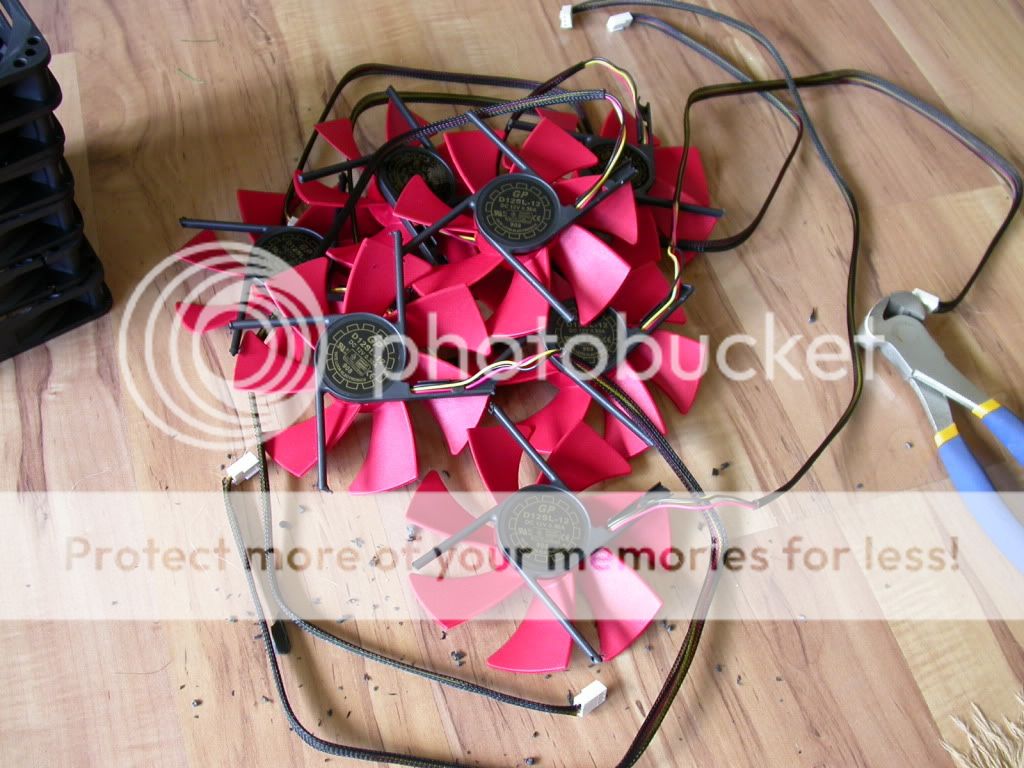

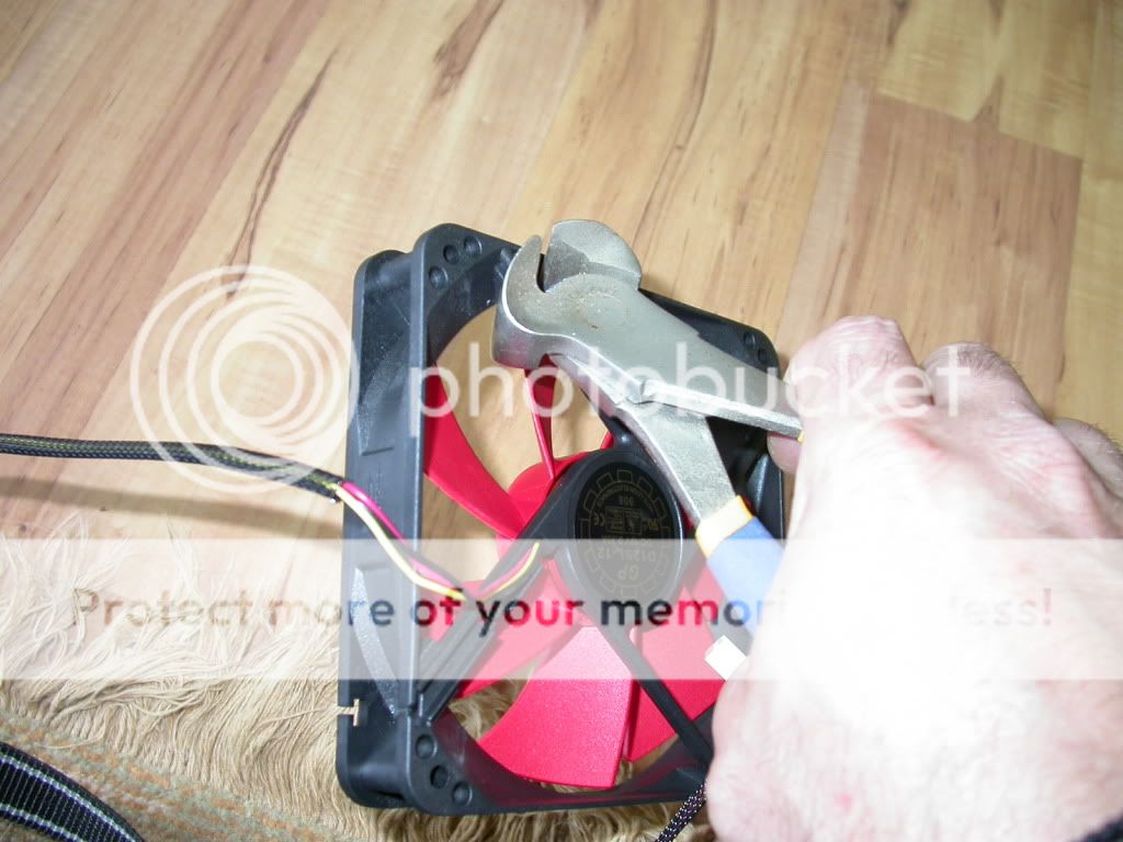

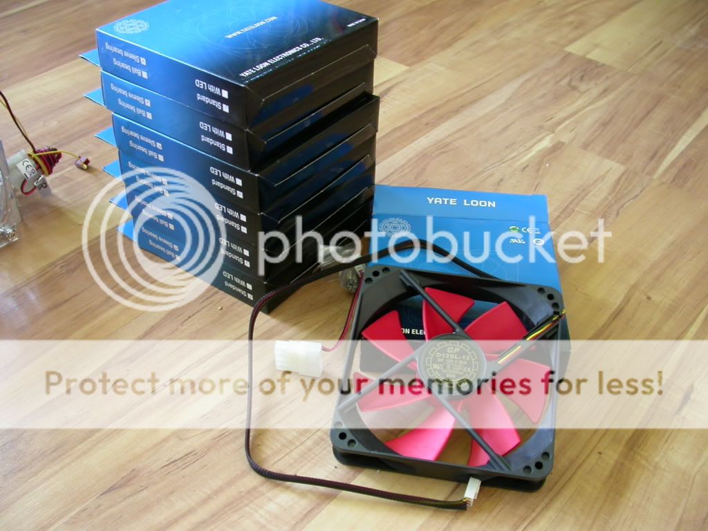

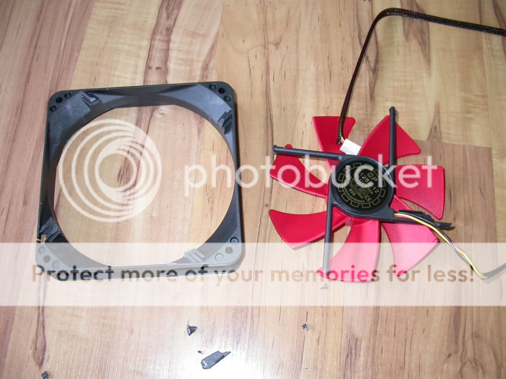

    I thought I'd throw in a ceremonial sacrifice to start off I tried to find old fans, but since I could only come up with 3 of the 10 that I needed...

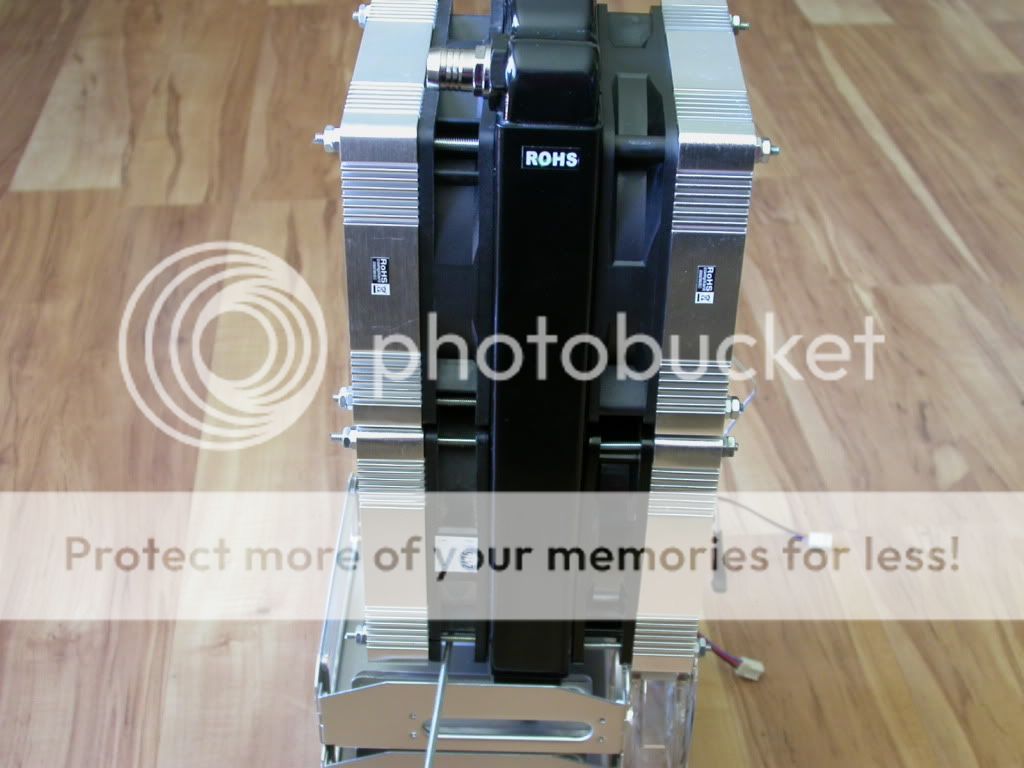

    I used the fan frames as shrouds, and reused the sleeving and most of the wires to supplement the fan splitters I bought. I also ordered a bunch of Gelid Wing 12's when NCIX had them on sale, and put 6 on the MCR320 and one on a fan cage to house the fan controller stuff. I wanted 1850gts but they were out of stock, and pricey, and these seemed nice (high mtbf, magnetic bearing, relatively low noise @ 1500 rpm with decent flow, removeable blades). I retained my 4 2200rpm dual ball bearing, polished aluminum evercools for the internal MCR220.

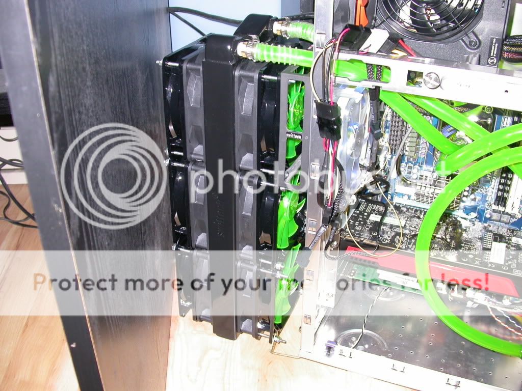

    The MCR320 is attached to the back with a radbox and a bracket at the bottom, and is positioned so that little or no hot air from the case enters it, as I later removed the exhaust fan in the back of the case and added more case ventilation elsewhere. Fan filters soon to arrive.
    And the MCR220 sitting on the fan cage, more or less like it would in the system.

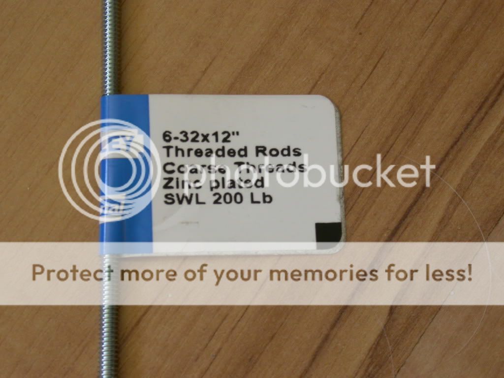

    I used threaded rod to secure the fans and shrouds to the rads, since I couldn't find anything else long enough, and hadn't discovered the wonder of zip ties...

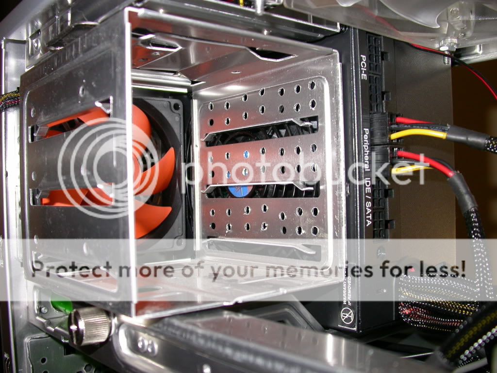

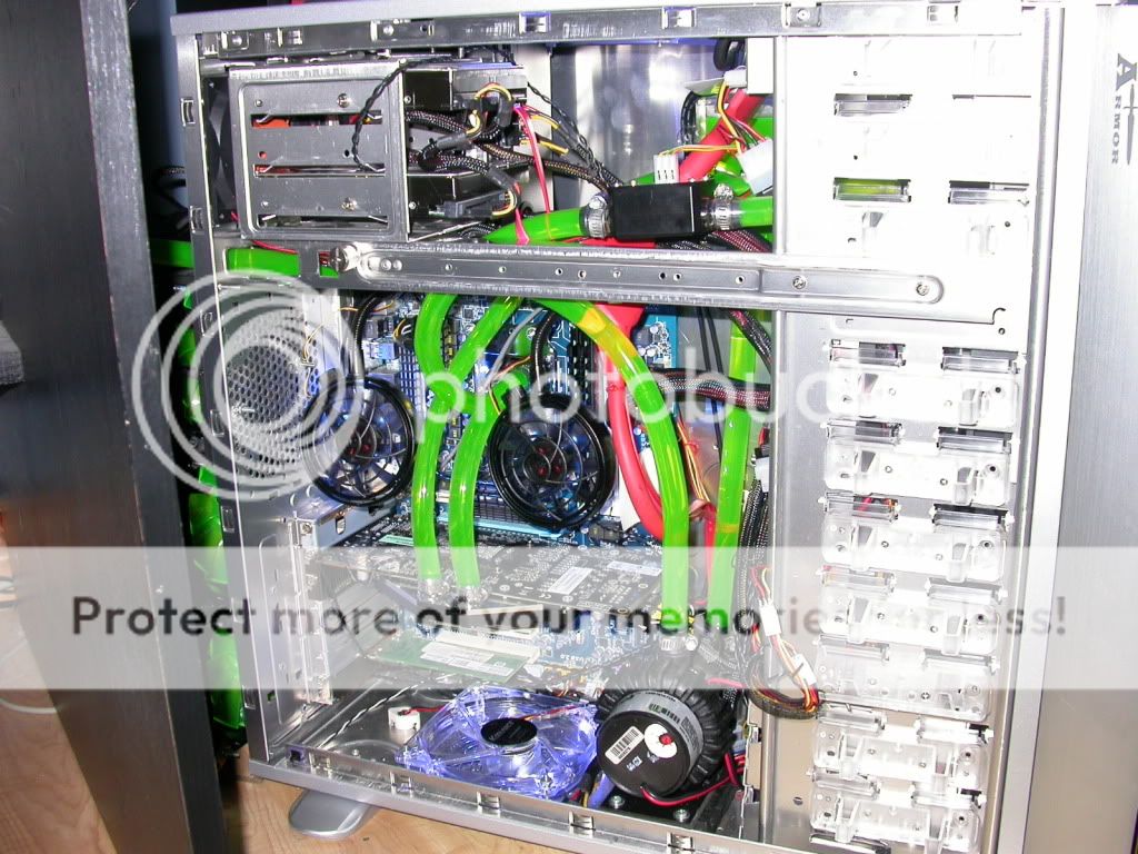

    Like I mentioned, the case has 11 bays, with a little extra space at the bottom. Good thing, since I forgot about the input/output from the rad So, 2 bays for dvd and power/flash drive reader, 6.5 for the rad, and 3 for the fan cage housing the fan controller stuff. I had to relocate the mini speaker, and bend down the guides on the sides of the bays in order to get the fan cage to sit 1/2 a bay lower so it would all fit

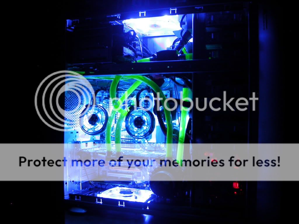

    Here you can see that I just had room to squeeze in the pumps, mounted directly to one another, next to the fan cage containing the bigNG, miniNG, and sensor hub (notice the red status lights). The internal MCR220 is above that. One pump is attached to the mobo tray, and the other one is attached to the bottom of the case, and resting on a black painted wooden block with a piece of underlay attached to ease vibrations

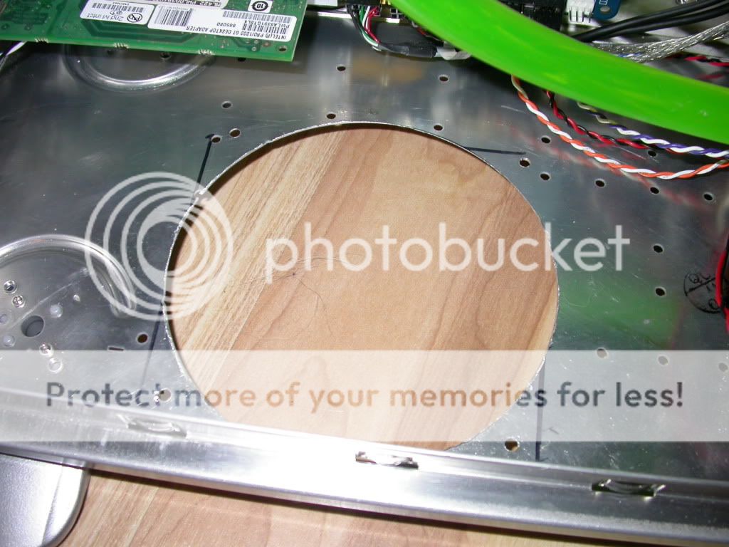

    I added a fresh air intake in the bottom,

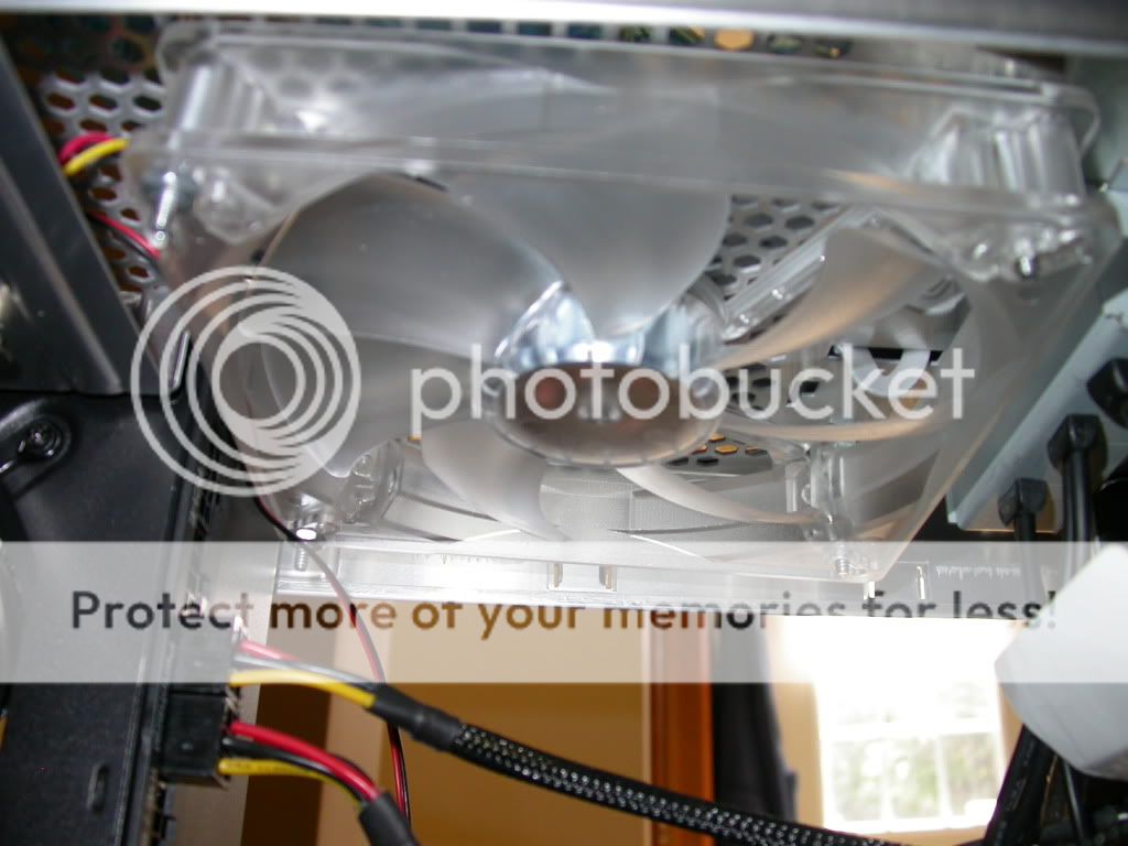

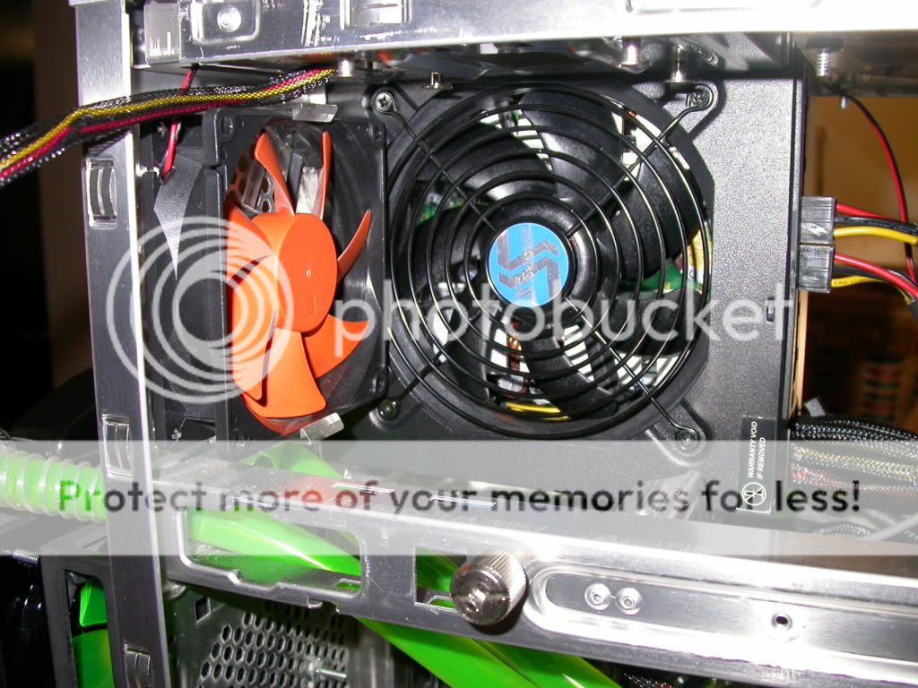

    and upgraded the top exhaust from 92mm to 140. Since it jammed the hinges for the door covering the audio and usb jacks, I used a couple of nuts to space it. But just on one side! If you look closely, you'll see that spacers on the left would have covered some power supply plugs that I'll need if I do crossfire (and I was carefull to leave room for that when I placed the pumps and added the bottom intake).

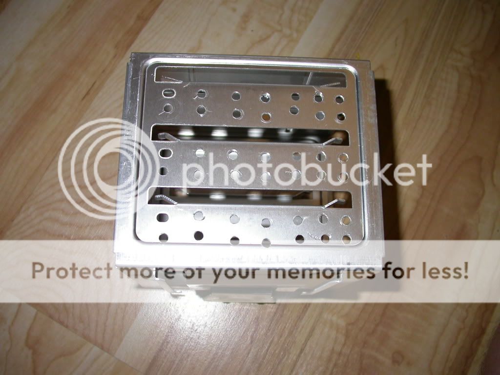

    Good thing there's another drive rack! But it seemed to block the power supply a bit too much, so I perforated it... It holds a WD caviar black 2TB, and hopefully later a couple of solid state drives.

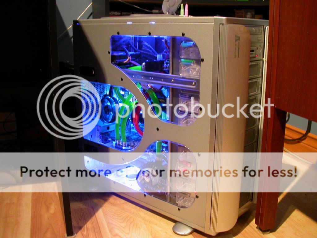

    Thats most of the mods, except a few holes and brackets here and there. Although I did have to use an angle grinder with a cutting wheel to remove a strip from a pump bracket, in order to get the side on the case. And bust out the soldering iron when a couple of fan splitters pulled apart, those things are fragile!

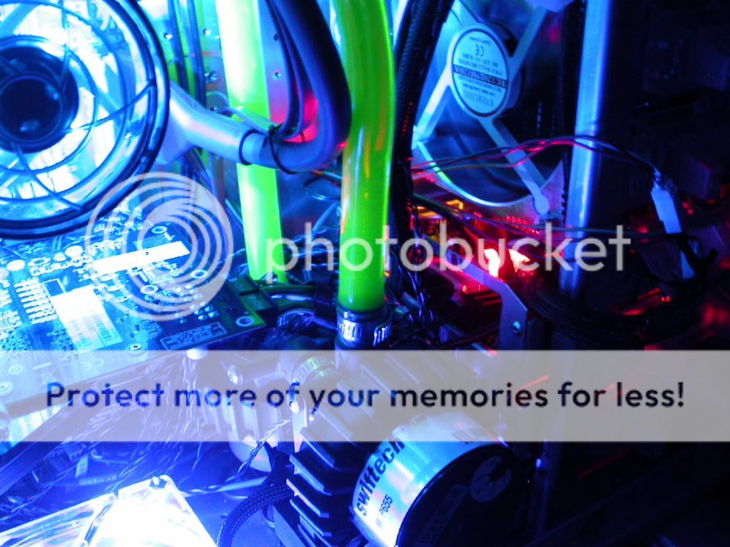

    You can spot the flow meter and res(easy access to fill from the other side) in the upper right of this shot, and the relocated mini speaker in the lower left.
    The cpu is a 1055t, the vid card a 5850, 4gb of ripjaw ddr3, ma790xt-ud4p mobo, Seasonic 850w M12D. I threw in a couple of antec spot cools for the mosfets and ram.
    The MCR320 fan channel uses a temp sensor adjacent to the core, under the waterblock, to control rpm of the 6 fans. The 4 fans on the MCR220 use the coolant temp sensor. Likewise, fan speed is controlled for the two antec spot cools on MOSFET and RAM, the case intake/exhaust (koolance), and the fan cage fan cooling the TBalancer. There are also temp sensors for ambient air, NB, SB, HDD, TBalancer, internal and external rad intake and exhaust, case exhaust, GPU.
