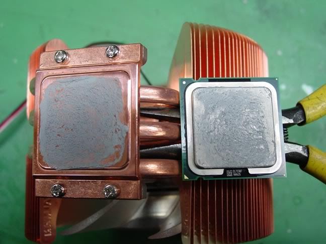

    Farm-07 Shin Etsu G751 test.
    Farm-07 is a Q6600 running on an EVGA 680i A1 rev board @ 2.8gig. It is in a rack mount (4RU) case, horizontal mobo, with a Zalman 9700 cooler. This has an Antec cyclone double slot cooler for exhaust (plus the PSU exhaust) and a 120 mm fan for intake air.
    Starting paste is a Shin Etsu G751 mount, about 6 months old.
    I accidentally twisted the 9700 when taking it off. This may have messed up the spread pic, but whatcha gonna do....It doesn't appear that I was real generous on this mount. The paste looks a bit thin, even though it's covered...
    I used a healthy pea blob with D7. Here it is
    Shin Etsu - before Temps
    Idle:
    Ambient 25.9C
    CoreTemp 49,49,45,46
    Load:
    Ambient 25.9C
    BOINC, Months of straight running...
    Coretemp 66,65,61,63
    D7 - After Temps
    Idle:
    Ambient 26.1C
    CoreTemp 45,45,40,43
    Load:
    Ambient 24.6C
    BOINC, 16 hours running
    Coretemp 61,60,58,60
    As you can see, the D7 beat the old Shin Etsu mount quite well. Several degrees when you factor ambients in.....
