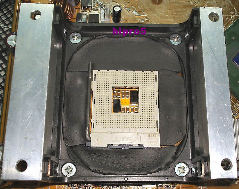

    I just want to ask the experts of the LN2 action if I insulate well my mobo so as to run a DOTHAN on it.......

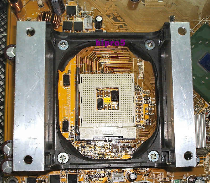

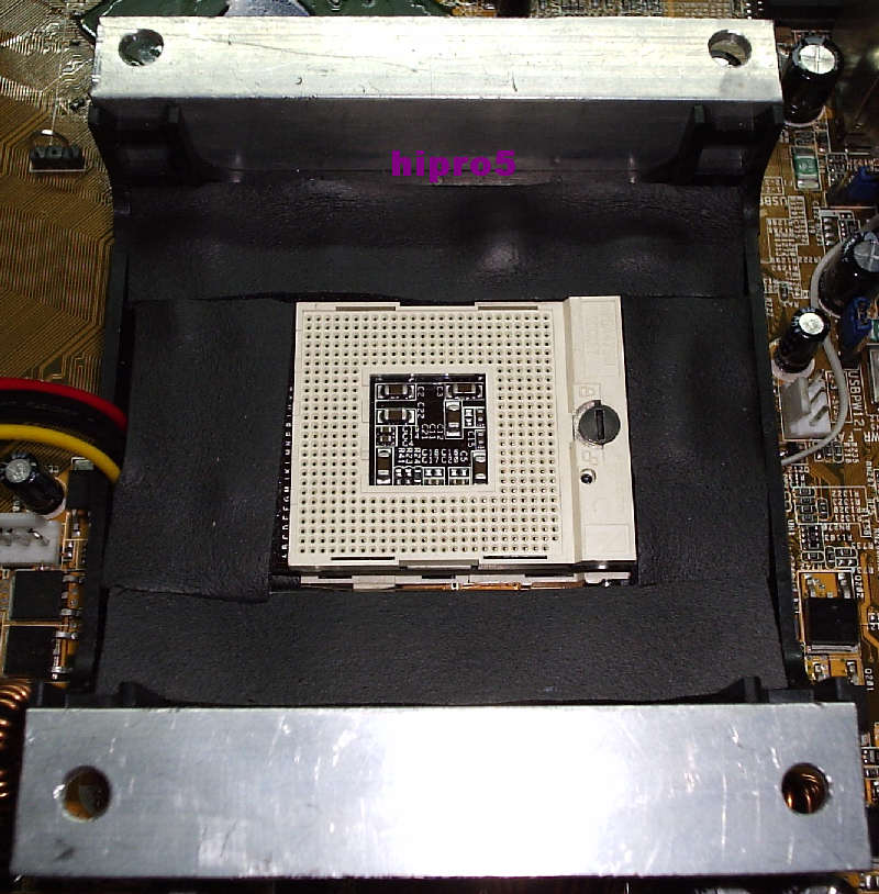

    Firstly I sprayed and "tipped" ALL OVER the motherboard with a Plastic spray which can hold from -70*C to 120*C.......

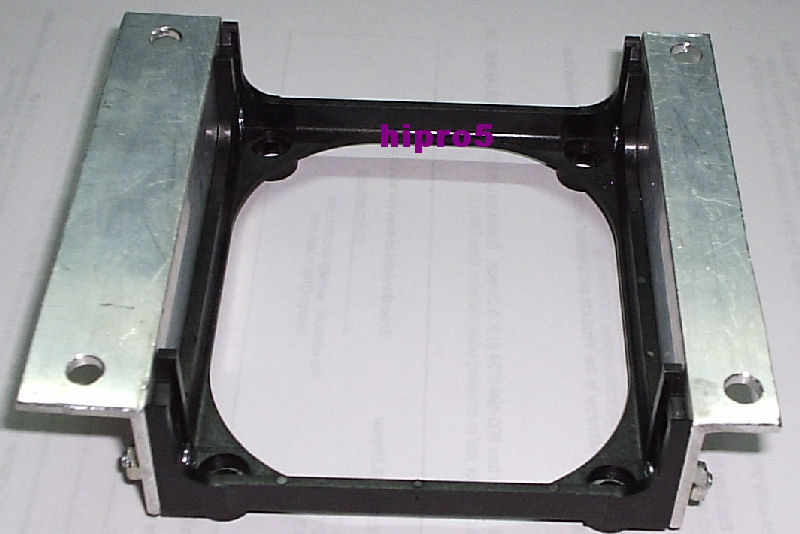

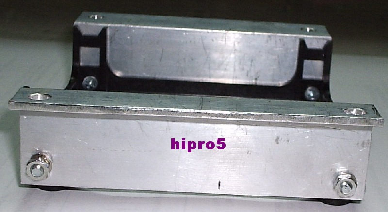

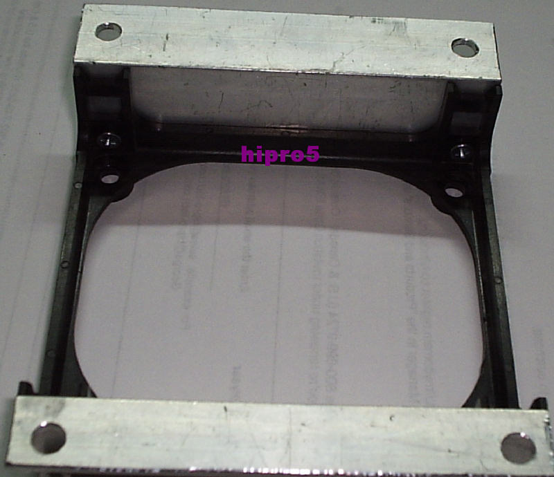

    After that, I started to "fix" the CPU bracket of the motherboard so as to fit with my phase change/LN2 container......
    Now I was ready to screw it onto mobo......
    A bit insulation inside it.....

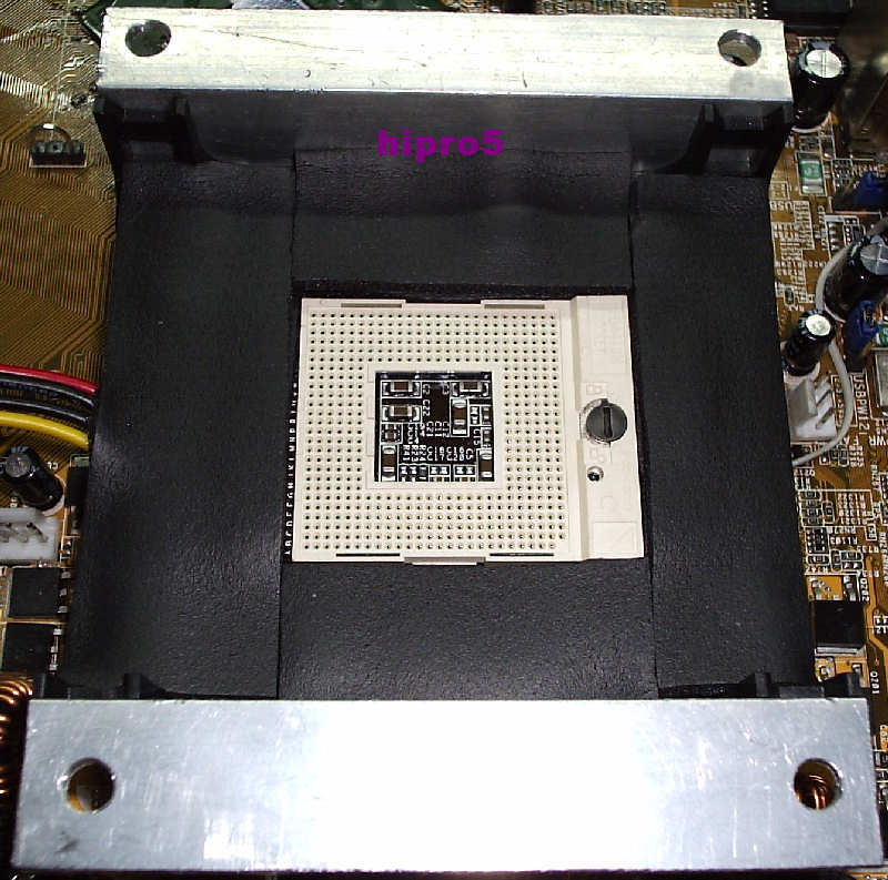

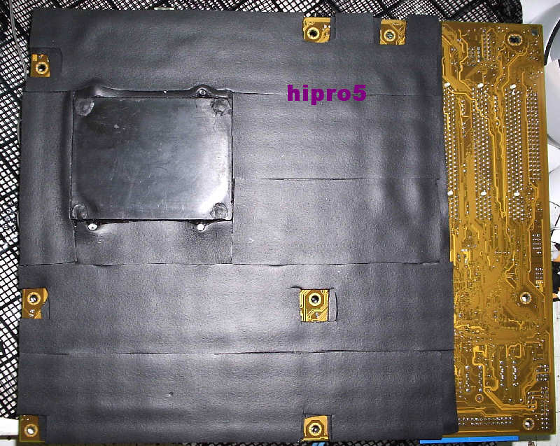

    Now.......Backside of the mobo........I firstly putted the Prommie's back plate with the resistor in it so as to keep the CPU's surface warm and then I double insulate the mobo.......

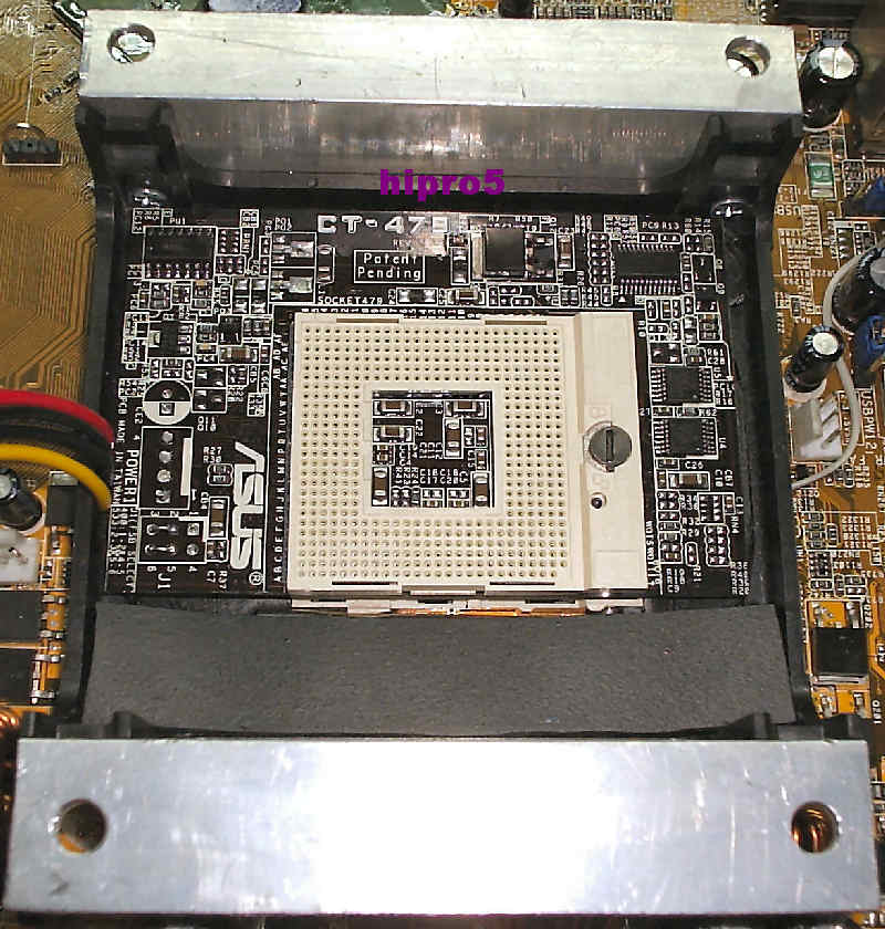

    Afterwords it was time for placing the adapter in it......
    Insulate a bit.....
    ......and a second layer......
    QUESTION: Do you think that this is enough for the LN2 action?......or should I do something else too.......

    bro nothing stops the condesation from LN2...
    Try to put as more insulation as you can...
    Ps. Did u repair the adapter?

    I think it will be enough.. how thick is the insulation on youre tube, so you have an good sealing between the insulation next to the socket. and as unseen said, the more the better.

    I'll try to cover the tube with as much insulation as possible........Do you think that I've got to insulate around the CPU's socket as well - just in case - ........

    you need some dielectric grease up in there.

    Well more insulation near the socket will do you good, make it as thick as you can. this will provide some good insulation.

    Definately w/ LN2 you need alot of insulation. On my tube I use 3/4" foam. Sorry don't know metric. I spray the back of my mobo and nailpolish the front. Make sure to seal around the caps real well. If you get a lock up and need to wait for temps. to drop anything nearby will have condensation on it. I would worry about the metal brackets they will surely be covered in frost.

    @ harleybro yes I think I should put some insulation on the front of the mobo around the socket as well........Thanks.....

    Just remember, that aluminum will act as a cold conductor when your ln2'ing. Make sure you insulate heavily between tube and bracket.
