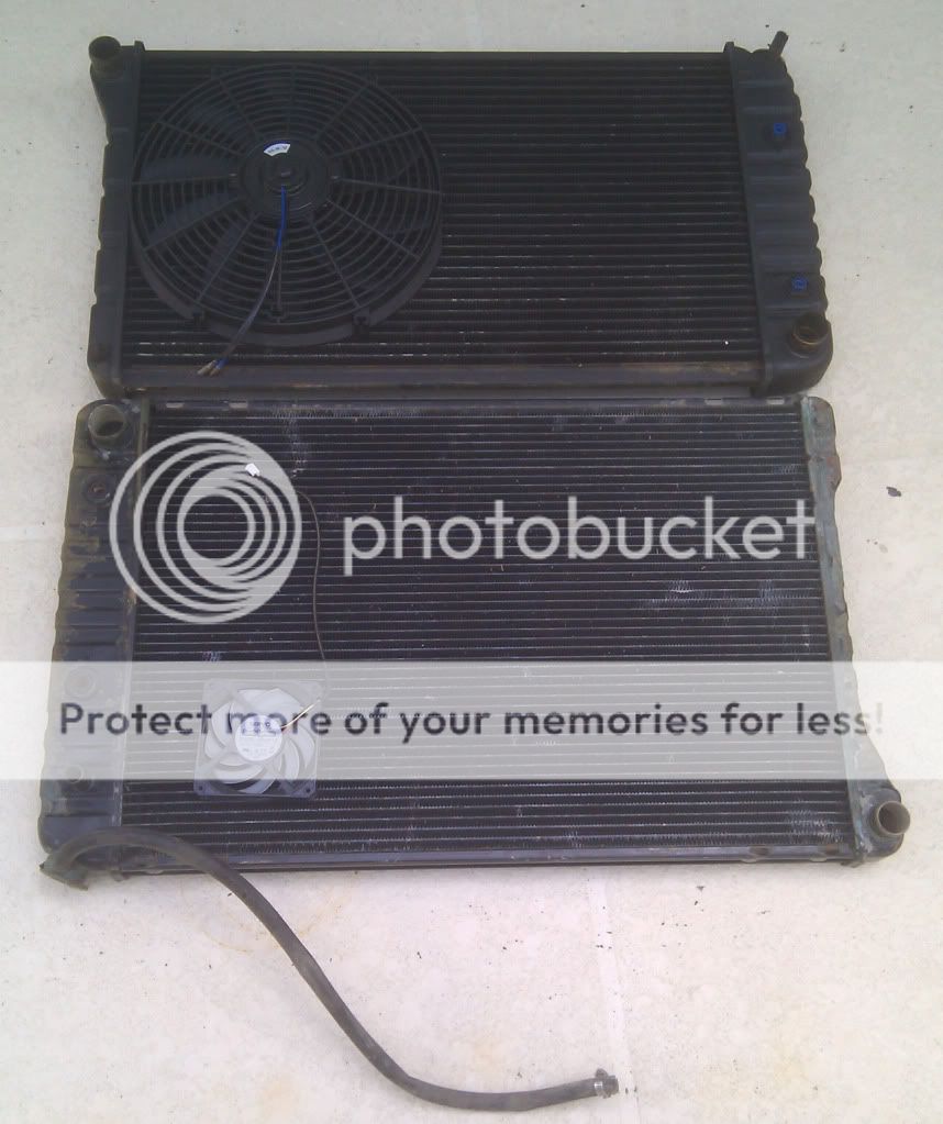

    I bought two Car Rads; somehow I imagined these things being smaller even the 'smaller' one absolutely dwarfs my mountain mods extended ascension! I put a 120mm gentle typhoon on the bottom rad for a size reference. The fan on the top rad is a 14" car rad fan off ebay; I have 2; a pair fits perfectly on either rad. The fans are rather cheap, unbalanced and noise, but have good enough air output and the price was right. I tested them out today and they don't undervolt well, they really only run at 12v and the blades are unbalanced. The top Rad is from a v8 Chevy lumina or somthing like that, and the bottom one is from a 1990 Blazer, both are 34" in total width! I spent the afternoon flushing out the two with a garden hose, the bottom one which is quite beat up and dirty could still use some more flushing; I even pulled a rock about 1cm in diameter out of the plenium I think someone dug this one up in their backyard and put it on ebay.
    I think I have settled on a spot to build the farm; in my garage with my rads exhausting out a window. I live in South Florida so the less heat I dump into my house then the less I have to negate that with air conditioning. I've been running a 920 and a Q6600 in my garage for maybe 6 months or so and even with FL heat and humidity they have held up, no signs of rust or excessive wear.

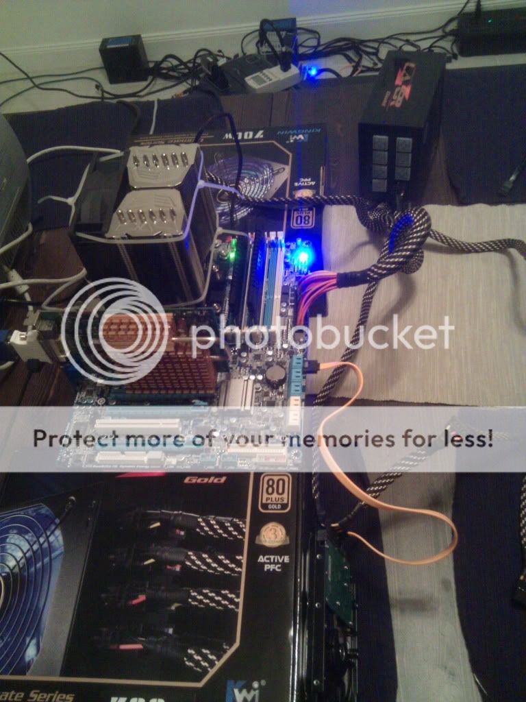

    - See what these L5640 A0's can do... I got one on the test bench right now learning how to OC these. I have't messed with them too much but so far it seems the max multiplier on the A0's is 18x instead of 19x on B0/B1's. I'm trying to underclock the ram as much as possible; right now after 2 trys it seems that i'm stable at 200 x 18 but it took a QPI of 1.3v bios (with vdroop so I hope the real QPI is lower.) I OC with an EVGA board on my main rig so I'm not so familar with the Gigabyte bios's (*hint, any tips appreciated.) I also don't want to pass 1.3v QPI and burn out the A0's. at 1.28v QPI I was getting 124 code (not enough VTT) BSOD's.
    - I think my biggest challenge will be supplying enough power to the farm, Cooling... no problem. I also just got a Kill-a-Watt; my best 45nm clocker is using 250W headless at 4.0GHz My worst clocker was pulling 280w. I'm sure the l5640's and 980x will do much better. So far with a basic GPU my L5640 on the testbed is pulling 205w @ 3.6GHz, not great but not bad (its an A0, I think they use more power than B0/B1's.) So with what I have so far thats about ~2,400W + some extra for pumps and fans. And i'm going to need more room to grow to meet my goal The breaker box is on the opposite side of my garage, i'm thinking about getting an electrician to see if they could install a 240v (or two) because a single 120v plug aint going get the job done (anyone that runs their rigs on 240v and knows anything about electrical work got any handy tips?)

    - I plan to build some sort of over the window shroud thing out of wood that can keep the radiators away from the window and direct the air out of the window. (I think i'll use both radiators, they are roughly the same size as the window opening.)
