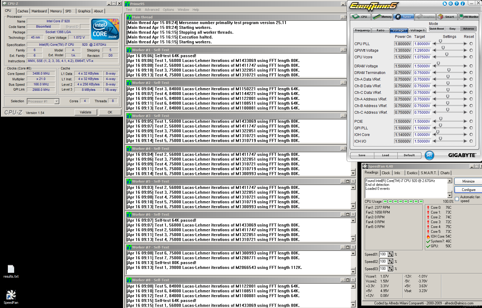

    If you have 1 chime in and leave a screen shot with voltages using the easytune6.
    My board needed 1.32 IOH Core before really responding to any overclocking every thing else came easy. Some peeps don't like windows based OCing utilities but I think easytune6 is one of the 1st that actually worked 4 me. I used it to finely tune my voltages once in windows to get a stable OC then just transfer the settings to the bios.
    I can run 4.2 w/HT or 4.4 w/out HT and I have defiantly decided on the 4.4ghz HT off is where I like to be.
    Any ways peace and can't wait to see every1's achievements.
    Jim

    I have the same board. Thanks for the guide, I have been running a little trial and error over here, that really helps.
    I am testing my max Bclk right now. It looks like 215 is going to be stable at 1.255V.
    Oct 2005
    26
    I think this is going to be my max 24/7. I was able to get 200x21 stable but at 1.4V and temps in the low 80s.

    I haven't had time to fully "stress test" this yet, but it is very stable with what I have tried. I am folding on it 24/7 with no issues. I figure that's stress enough.
    A pic at load:
    Some folding pics:
    Folding extra-large work units, w/ 1 GPU client: http://www.flickr.com/photos/2227360...79025/sizes/l/
    Sub-30 minute frames with just EL WUs: http://www.flickr.com/photos/2227360...42726/sizes/l/
    Also, here is a link to my full bios profile: http://forums.tweaktown.com/showthread.php?t=38298

    after my msi x58 plat killed my 8800gts512 it died too so i bought a x58a-ud3r yesterday. i was hitting 3.6 24/7 with my c0 920 and willing to make a little more with this new mobo.
    first thing i get is i will make ioh 1.32 . other than that do you any other tips.

    I am currently running a 920 D0 at 3.73 GHz (178 BCLK, x21 Multi, 1.10000 vCore, everything else on "Normal") on this board. I haven't installed EasyTune yet. can anyone confirm that when you set a voltage to "Normal" on this board it will only load the default voltage and not over-volt in some circumstances like when on "Auto"?

    nice, thanks. my temps are a bit high at 4.01 GHz. ~78°C on load with vCore at 1.18750 using a Megahalem with OCZ Freeze. my ambient temperature has probably been between 10 and 15°C (50 and 60°F). also, has anyone used any PWM fans with the fan headers on this motherboard? as odd as this may sound, I've never used a PWM fan before and I was considering using them for intake and exhaust. do the EasyTune settings only work when in Windows or would they work in Linux as well after they have been set in Windows?

    PWM Fan will work just fine, on the headers that support PWM. Don't use SYS_Fan 2 though for it, unless it is fixed in your BIOS it will be super slow.
    Temps are warm that you mention for that voltage, you sure you have a good mount and not too much paste? i7 is warm though, but that seems fairly high for that voltage.
