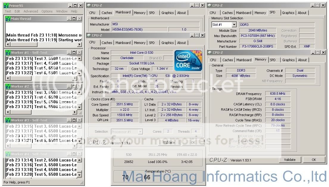

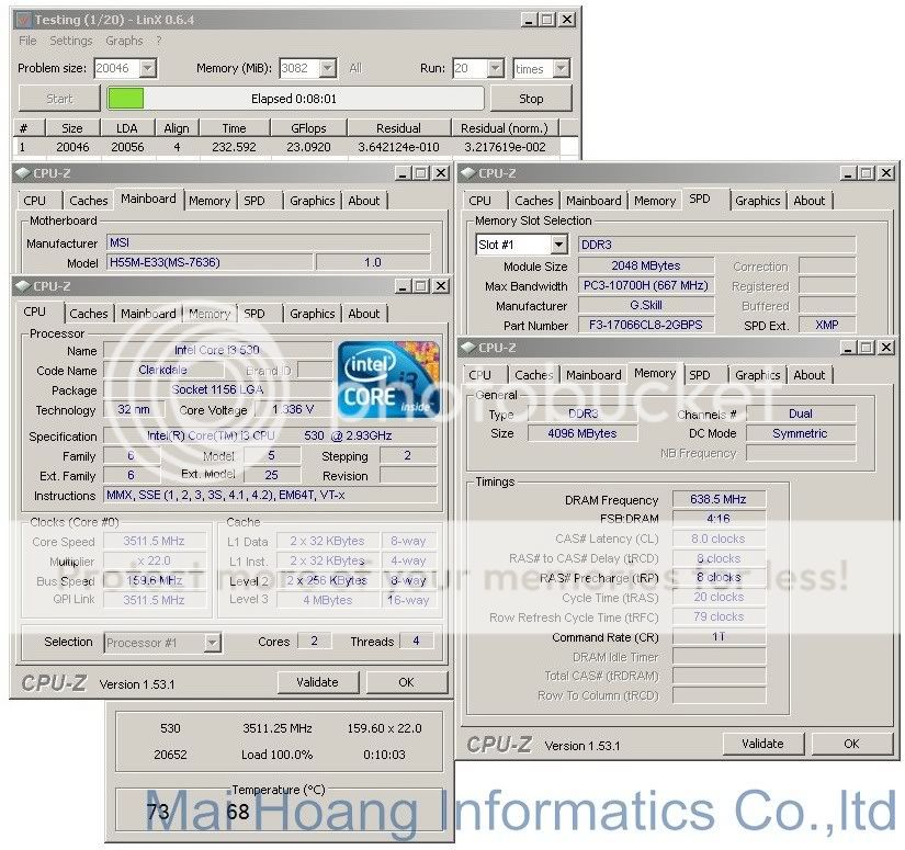

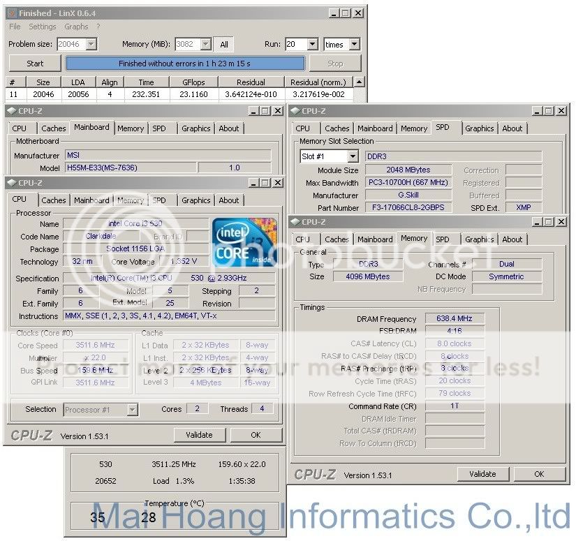

There are a few bugs,like cpuz and everest reporting the wrong cas latency at higher frequencies.
you can use old versions of cpuz(1.52.3) and there is an updated one for version 1.53.2 w/o validation.
you can see in some of my screenshots this bug at work.
