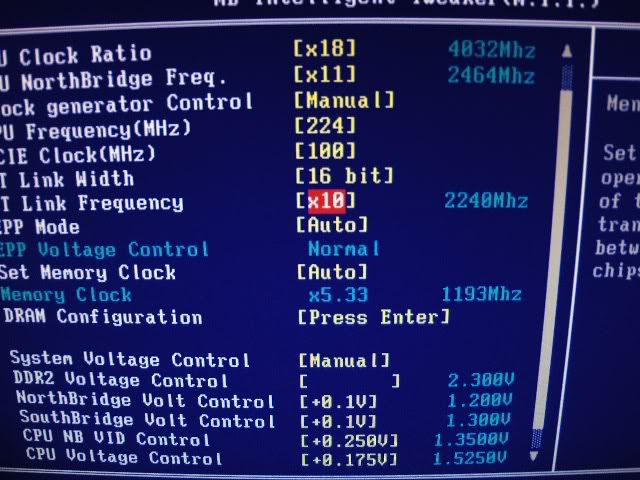

    Hey gOtVoltage...
    Why the NB Chipset and SB Chipset at 1.3v? I run the SB at 1.3v but the NB Chipset is at the stock 1.1v.
    The best I can suffice even with 860 Mhz CAS 5 for 24/7 is 3890 @ 1.50v.
    I've tried up to 4014 Mhz @ 1.56v and nothing is stable. On my best core (Core #1 or, core 2) I can validate it up to 4400 on 21c air. The rest of the CPU tops out at 4368. (Lucky one I can't replicate..in my sig)
    I can run SuperPi 1M on core 1 (real core 2) @ 4330 with 1.575v also.
    But I can't hold anything over 3.9 Ghz Prime95 stable.
    My CPU-NB is strong, does 2.6 Ghz with 1.225v and 2.8 with 1.3v, then it takes 1.425v for anything over 2.9.

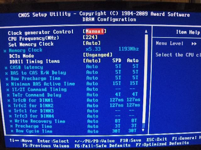

    Let me dig through my Bios Pics...
    Nb chipset 1.2v using 2gigs@1200mhz and 1.3v using 4gigs @ 1100-1150mhz on this Mobo.
    SB chipset (1.28default) 1.3v on this Mobo to us more than 250htt .
    Bios F7 and F8 F9 will all use the same Voltages..
    Make shure you are setting NBchipset and SBchipset ..
    CPUvid is CPU only
    NBvid is for the IMC on CPU only ,,Thats not what im refering too.
    NBchipset on the Mobo is supose to be with in 1.17v- 1.32v if you are Raising HTT or Overclocking Hard.. This Mobo Deafults to 1.17v which up to 2gigs and 3800 may be fine. Ive been running this Mobo At 1.3v from day one. Ive Clock Above 4000mhz 24/7.
    If you Are Priming make Shure you are Not Cooking your PWM's. I will never prime a PHII Above 3800/3900mhz for more than a few hours ..Especially when im using above 1.55volts. These Mobos can not handle that fo rExtended use( 12hours)..Not even GD70...The PWM's will start to over heat and lose volts and other things that Cause erros ,although the CPU will be 100% stable..
    Voltages with 2gigs @1200mhz ram..4gigs @ 1100-1150max.
    Auto Ram setting and 533 divider for 1200mhz ram EPPsetting
    Yeah i like this Mobo .. there are a few bugs and High HTT is one of them.. Also the HT and Ram settings can conflict too...
    The main thing for C3 is how good its cooled.. If you can hit 4300..but not stable @ 3900 priming your Mobo can be problem not the CHIP. Prime is fine for a few hours but desinged for stressing with lower voltages ..Its most likely the Mobo cant hadle the heat. Even my M3A 79-Tdeluxe Primes stable up to a certain Voltage..Past that point i dont even bother because i kno i will ruin her.
    I can run %100 stable all day@ 4100mhz +@1.56v .. with the voltage i use i will ruin this Mobo if i prime for more than 6-8 hours using 1.56v+ .Ive cooked one @ 1.54v after two days and one after 16hours @ 1.48v.. Priming is not the best thing to do for a Mobos power circiute.

    Check that image out.
    4306 @ 1.575 set volts, 1.568v.
    The CPU-NB is at 1.40v and the RAM is running 2.3v set or 2.35v real. I'm just bored tonight so I thought I'd push CAS 4 on my old SuperTalent DDR2-800 4-4-3-8 2.2v kit.
    Thats one core @ 4300, others are sitting around 2055 and the rest is told in the picture. I'm running the stock NB Chipset voltage and Stock SB Chipset Voltage.
    And gOtVoltage:
    If I run 3996 Mhz I am stable for the most part (real life stuff) @ 1.525v, if I try to up to 1.55v it gains me nothing. I fail Prime95 and OCCT within 10 seconds of them starting. 3900 @ 1.50v is stable and I tried 3900 @ 1.475 once and it BSOD'ed in gaming and stuff.

    True, and I think there is something wrong with my HSF mount. I'm doing 3706 in OCCT Large right now, I dont find any use doing Prime95 or OCCT for anymore than 2 hours...it's just going to end up killing the board.
    The temp wall on this CPU is about 57c...I'm fluctuating between 48 and 50c at the moment an I'm 20 minutes into the test. I'll probably shut it off soon and call it stable.
    I can bench 3DMark06 up to around 4175, then it just tanks at anything over that. I just find it funny that I can do around 3700-3750 on the stock voltage (reading as 1.39v) while I can't pass anything at 3900 with 1.5v+.
    While it may not seem that there is a definitive temp wall on your CPU I'm sure you are on the borderline. I wouldn't be suprised if I get 3.8 stable on stock to 1.42-ish voltages by the end of the night, and I could probably do way better with better cooling. It's just frustrating.

    I run prime a minimum of 12 hours. There are times I pass OCCT and fail prime, and I notice that if I am close to stable, but not there yet, it usually fails prime just after 9 hours. Prime isnt going to kill your board either. The whole point of stress testing is to make sure the entire system is stable, so you dont end up killing something.
    Anyway, at default 200HT the board runs 201.5. So I set it to 203, lowered my NB and HT multi to x9, lowered ram multi, and increased timings, increased vcore and vtt by .05, and bumped NB and SB .1. Still failed even after all that, just for 25Mhz more.
    I did get 4.2 to boot and not have an issue for about an hour of normal use, so that should be benchable. Havent tried higher though.

    Yeah, I just flashed F8 and I'm playing around with ACC...no more BSOD's on instability. I'm just getting "Error Detected of Core 2" and it's been Core 2 for the last three times it's failed. CPUNB is stock freq. with 1.275v,
    and I'm trying to find ACC values to fit the slower cores.
