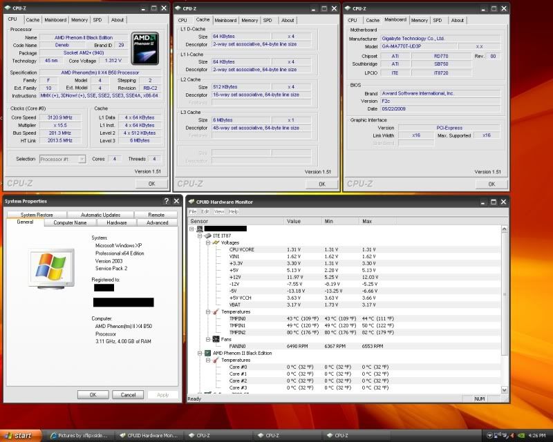

I just joined this site a few days ago because of all the information available, and thought id toss up my results with my unlock.
I was able to unlock a AMD Phenom II 550BE X2 to a X4 B50 3.1Ghz with the F2C bios on the Gigabyte MA770T-UD3P motherboard, with 4GB (2x2) Gskill DDR3 1600. Didnt worry bout the memory yet, but set the bios to ACC settings to Hybrid and Auto. My chip is coded 0922CPMW, not sure if that what everyone wants to know off the chip. I wrote down all the writing on the chip before I put it in. It sits at around 34c with stock cooler & AS-5 with it unlocked. I havent tried the overclocking aspect on a stock cooler, waitin on my waterblock to come before I push it. Also gonna try to find some compatible mosfet coolers, a NB cooler, and SB cooler.
I took some screenshots so I hope there what your lookin to see.
Are those temps in the picture at idle because mine get hot like that too. And as far as the memory us concerned, I have that same gskill 1600 and it is unstable with F2c. Once I flashed to "F2" it suddenly worked at after "overclocking" to the spd settings. Should work then. Have fun with your new toy. It's pretty awesome.
Also what PSU are you running ,, the _12volt is way low for Minus -12v reads -7v?
It should be around -11.5 to -12v shouldnt it.
Id say you must have a 500watt or 550watt PSU and its pulling lot a draw to run sytem. Maybe its just a Bios or sensor glitch.
I could be wrong though![]()
Yeah the temps in the screenshot are from when I was assembling it and running prime95 on it. I live in arizona and by chance on that day it was 108 outside lol. Not exactly an awesome way test run things. Inside it runs much much cooler. As to the 2nd part on the power supply voltage issues, yes the ps was a 550watt ps that was just used to test the system. Im about to order a new ps specifically because the draw of power is substantial. So in your guess you were pretty dead on. It runs stable and ive played a few games on it but im just worried that without ample power issues will occur, even a dead mobo or cpu in the end. So at the moment its just sittin on the sidelines. The memory has to be put in manually to the factory settings that are displayed online for compatability. I took the one guys advice and did the 1.56v on mem and it does produce 1600. I didnt benchmark it cause again, the under powered power supply makes me worried. I will post more results when I get my waterblock in, and when I get the new power supply. Hopin for good results.
