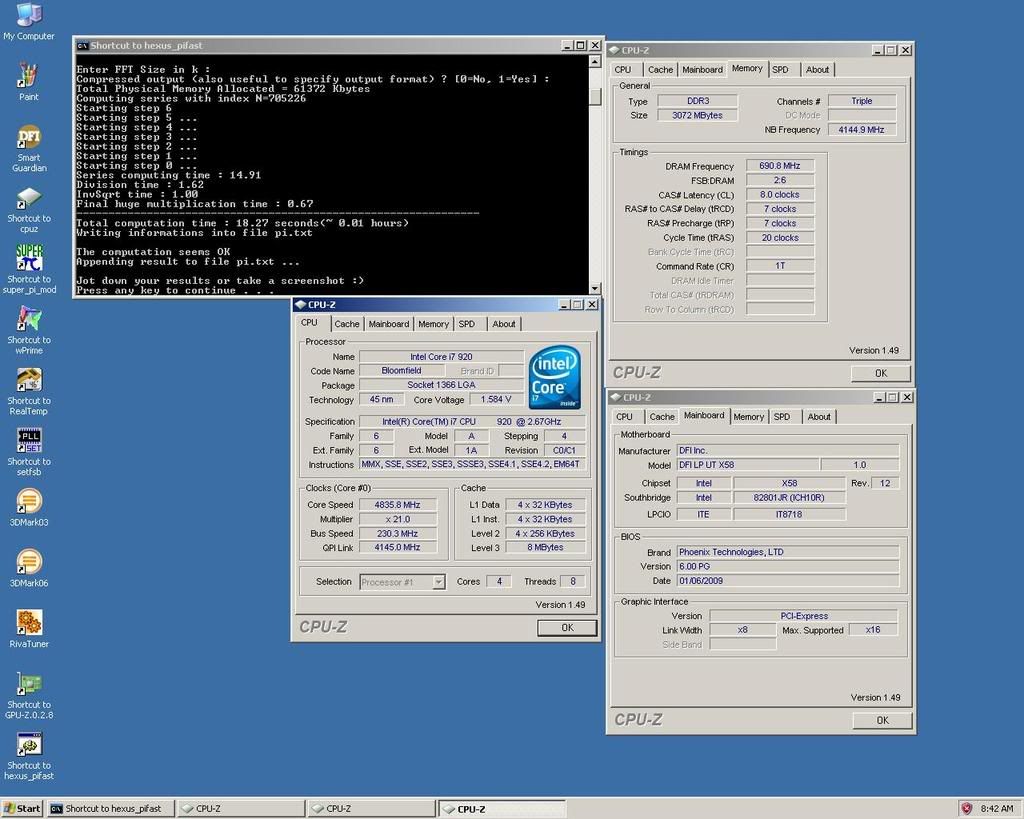

warming up my cascade with DFI LP UT X58-T3EH8 and i7-920.. (230 bus speed achieved)
hello fellow XS members i've been playing few days with my new toys.. here are the preliminary scores that i was able to achieve.
the gear that was used:
DFI LP UT X58-T3EH8
core i7 920 patch #3841A347 so far this patch seem to be very rare picked it up from ebay
Corsair dominator ddr2 1600 mhz 3 gig triple ram kit
WD raptor
geforce 9800GTX
2 stage cascade ( build by piotres)
lets start with the bench marks shall we first wprime 32M good god those 8 threads are fast
next on the line we have wprime 1024M
mandatory super pi 1m score.. some strange thing is happening with my system i cant run super pi 32m at any clocks. seem like i need to re-install window
and finally max screen... so far
here are the bios settings that i used:

time for a small update.. i found today what my problem with super pi and pifast was my ram. these sticks totally SUCK !! not even raising the ram voltage to 1.85v dont make em stable..damn it !! i think i need to start to look for another pair

Are you sure, that it is the ram? What VTT/uncore voltage you are using? (Measured from board)
Well.. really good tri channel kits are not so expensive.
Oh.. and very nice scores ..4.83GHz with that price is awesome!

check your subtimings as well which you left on AUTO, hence why i was curious about memset/cpu tweaker screenshots
REF to ACT Delay (tRFC): AUTO
Write to PRE Delay (tWR): AUTO
Rank Write to Read (tWTR): AUTO
ACT to ACT Delay (tRRD): AUTO
Row Cycle Time (tRC): AUTO
Read CAS# Precharge (tRTP): AUTO
Four ACT WIN Time (tFAW): AUTO

i tested the subtimings and no go.. its like anything over 830mhz with any latency ( i even tested cl10) or voltage and the superpi gives an error at some point.. lol i guess i just have to tighten up the latencys cos this damn things just refuse to clock any higher
Maybe even more voltage to Rams ? I know it kinda looks like a suicide mission, but it worths a shot ...

i already tested 1.95v for the ram and it didnt help... this is sooooo weard i've never owned a kit that overclocks soo poorly

update time. as you can see my superpi 32m time sucks cos of the memory, my dominators just cant handle higher clock speeds so there is not much i can do. i ordered a pair of new sticks today and im hoping that im able to improve my memory bandwidth by heaps.
