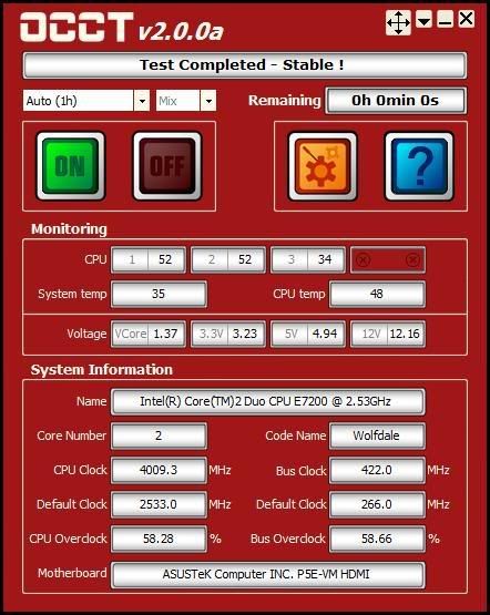

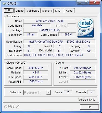

    Anyway, back to the Intel Core 2 Duo E7200 at hand, I have this to show for now:
    Aaaannnddd... 3.8GHz stable at 1.344v. Not bad at all, actually. Maybe it could be better... but oh well.

    nice. can it reach 4.0? what temps?

    4GHz is totally possible, but since 3.8GHz is only stable at 1.344v, I don't even want to know what kind of voltage 4.0Gz would require. Cooling is with an ACF7 Pro. Temps are around 40C - 68C after the stress test. Since it's below 70, I don't bother with re-seating the HSF anyway. So first boot, first start, first install, and work right off the bat. I'm sure that with some lappings, some more tweakings, I can get 4.0GHz stable at a reasonable voltage. Still not going to try, though, because the last two Q9450 killed my enthusiasm.

    750
    Okay... I guess I wasn't so lazy after all.
    And... off to tweak more!

    Nice chip, Stilt. Mine has a VID of 1.1625v, and it requires exactly .04v more than yours to be stable at 4GHz. 4.2GHz seems to require 1.42v for me, though... and since temps are quite crazy at 1.344v, I am thinking about doing something to the cooling before proceeding to higher clocks.
    Oh yeah, and sSpec of E7200 is SLAVN.
