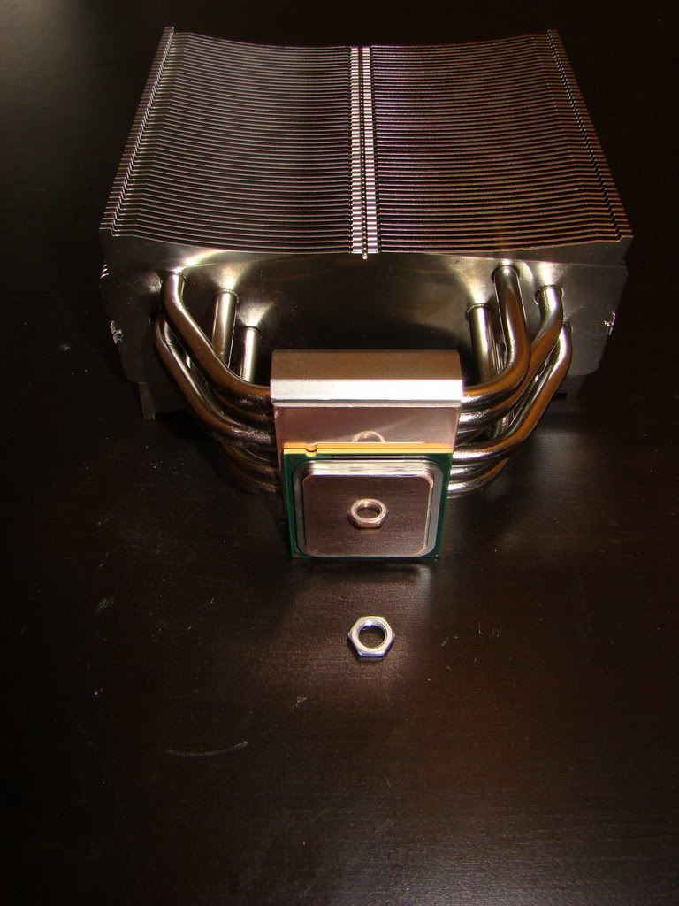

I've seen a couple of threads about people wanting to lap QX9650, but didn't see any pics, so decided to lap mine (along with TRUE) and post some pix for everyone to enjoy. Plus would like to share my max OC of the processor on air.
Let's roll!

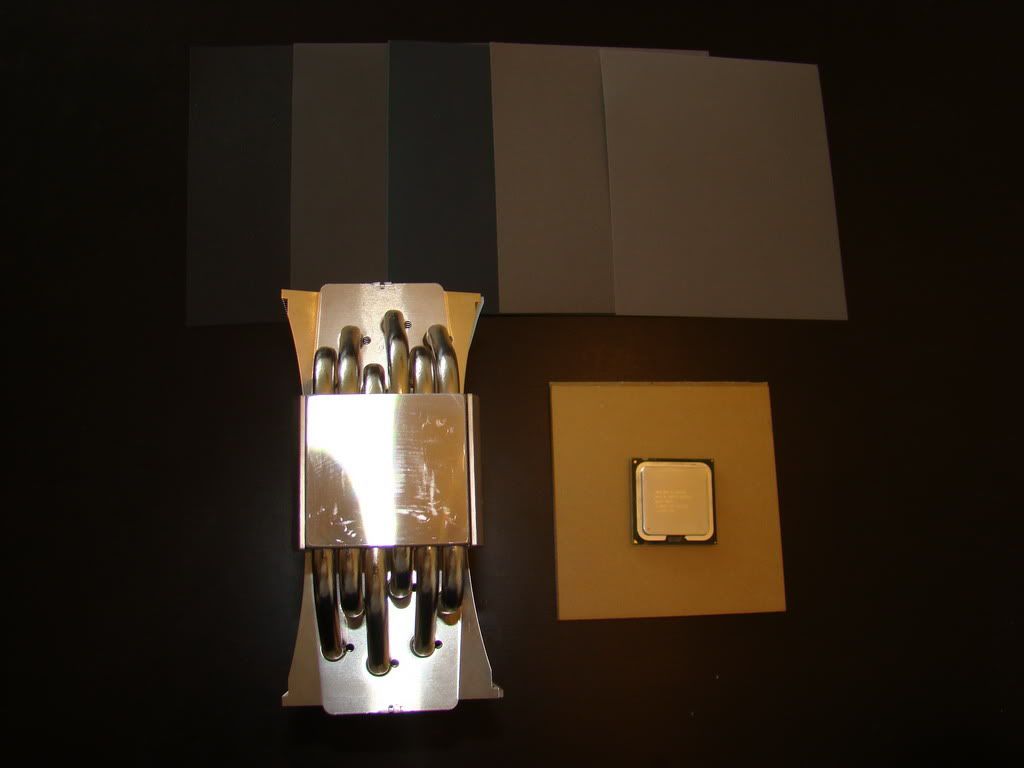

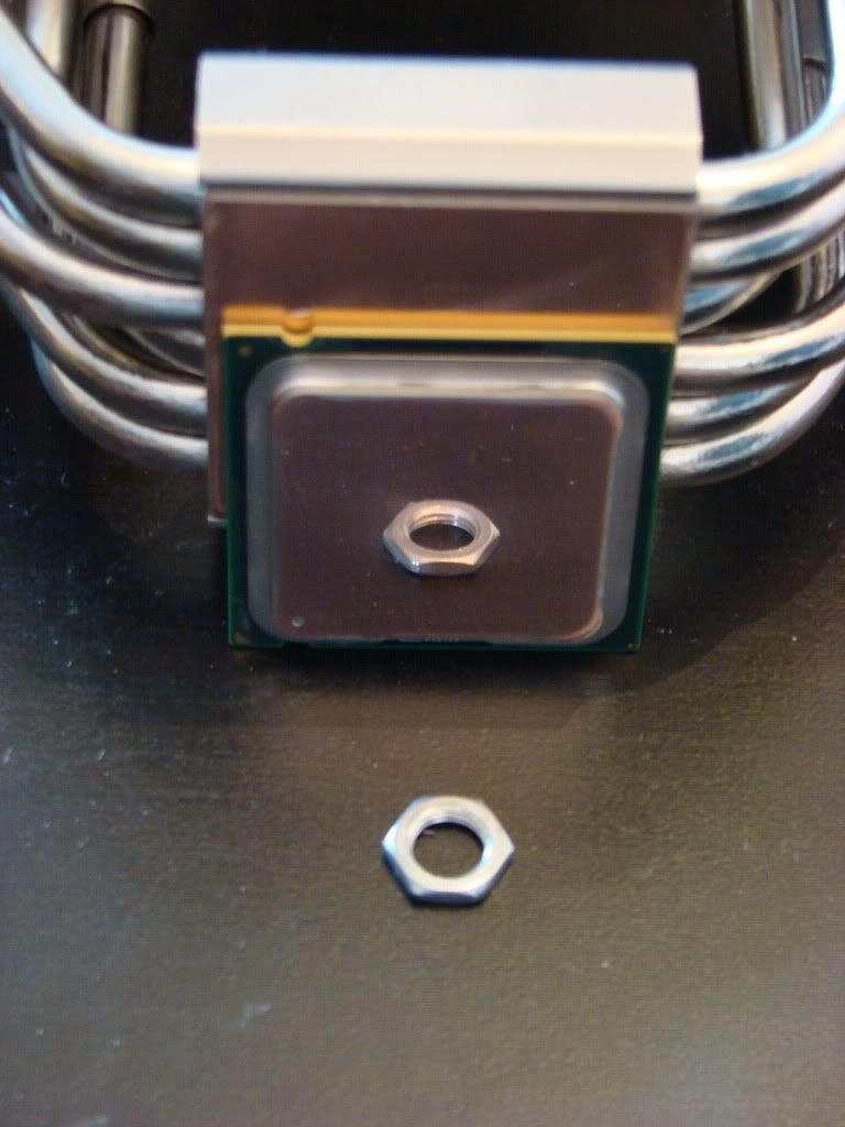

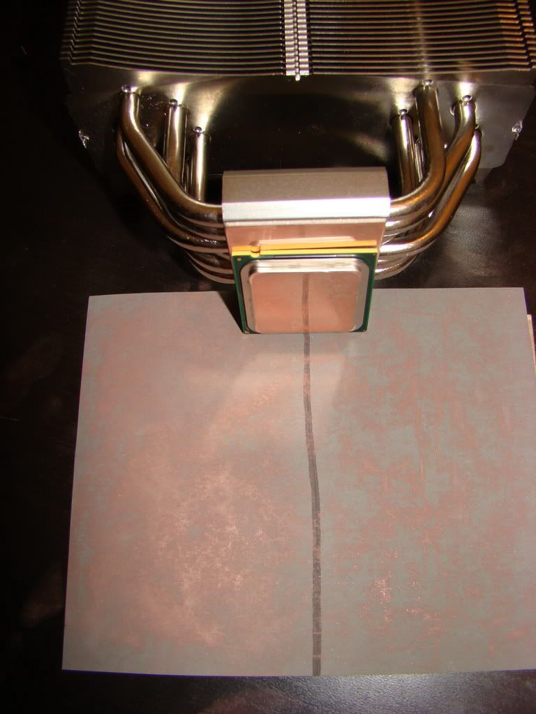

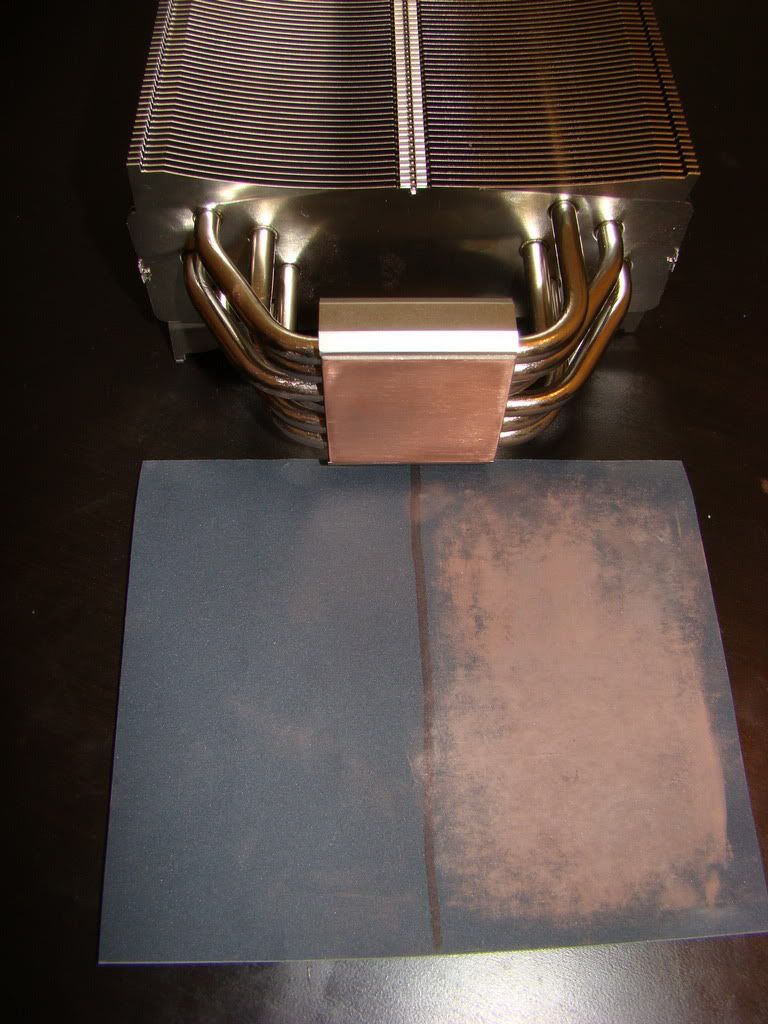

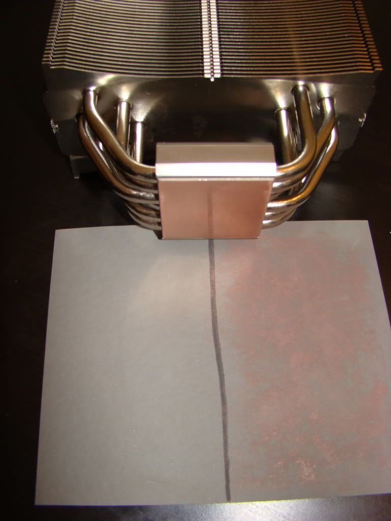

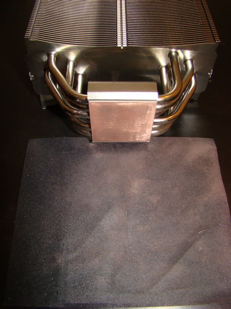

Getting ready to lap. Grit from left to right: 400, 800, 1000, 2000, 2500
400
800
1000
2000
2500

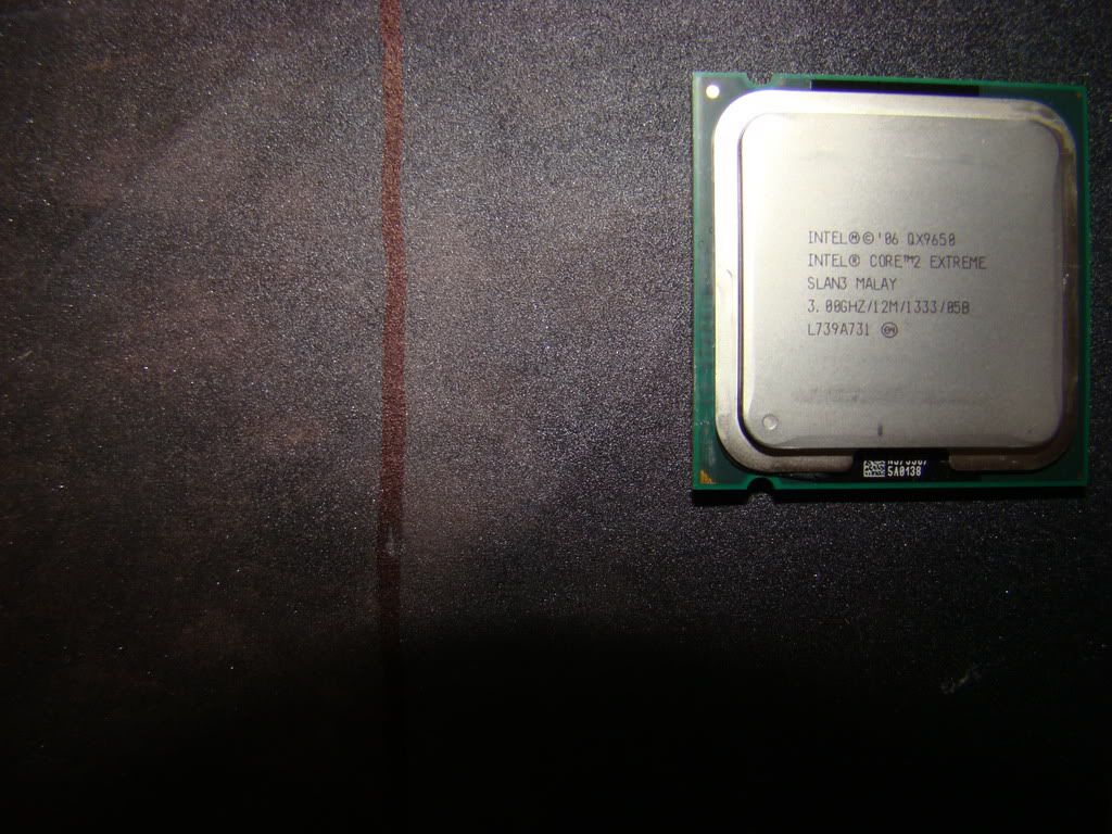

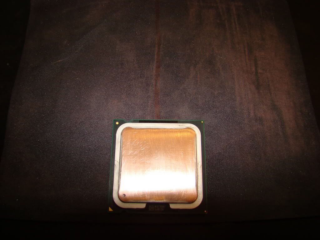

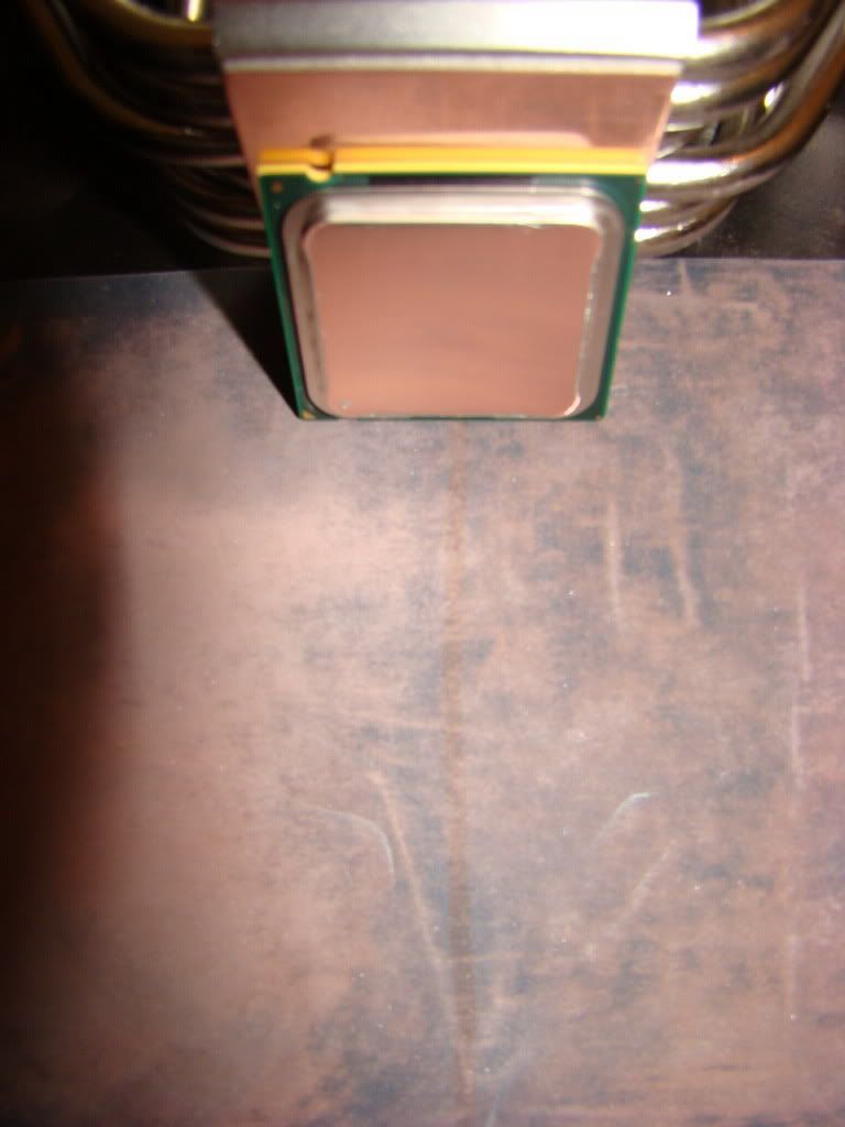

And now the QX9650 (L739A731)

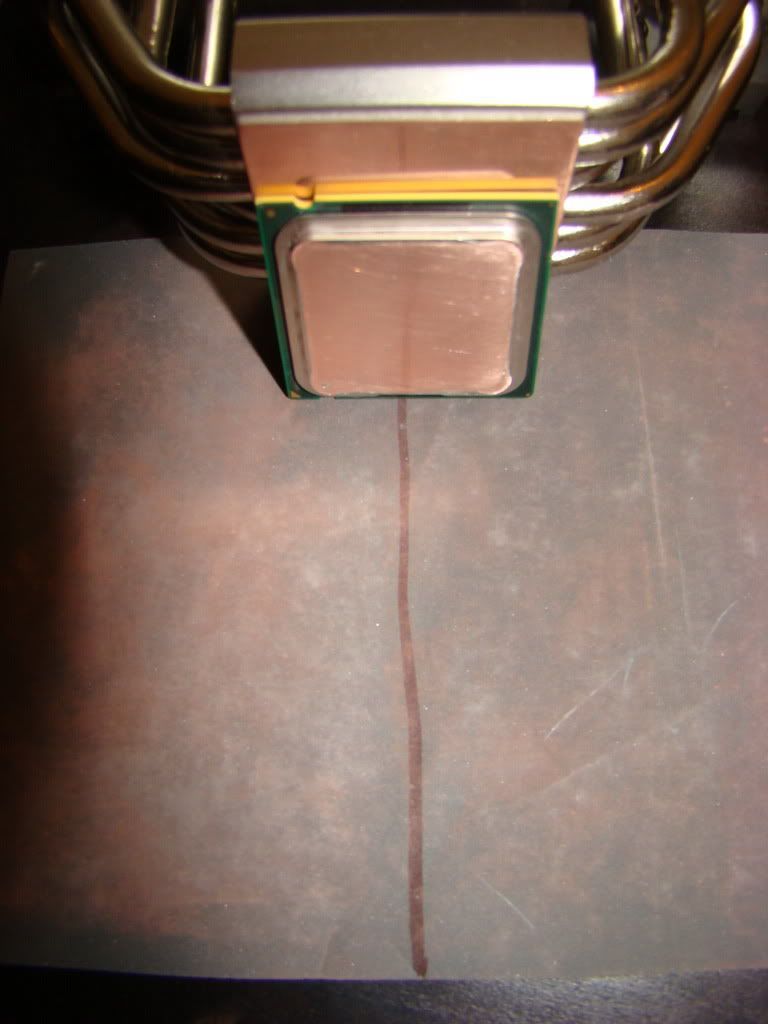

400
800
1000
2000
2500

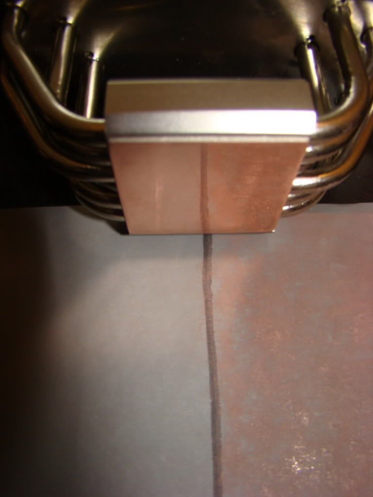

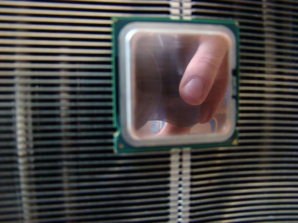

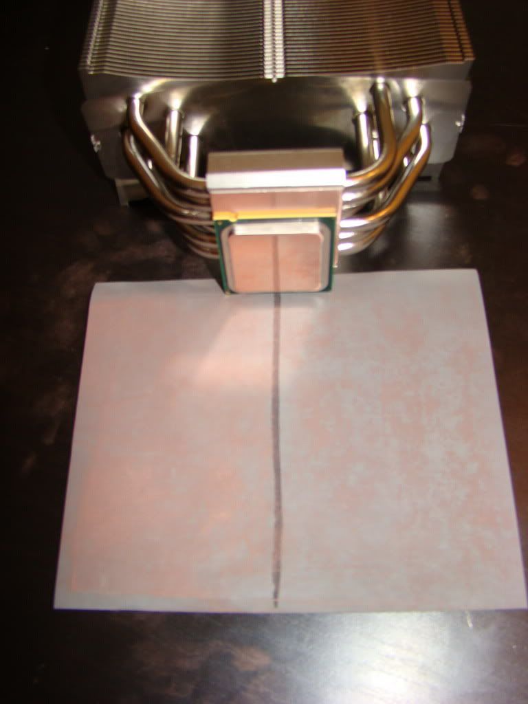

The job well done
Mirror finish 1
Mirror finish 2

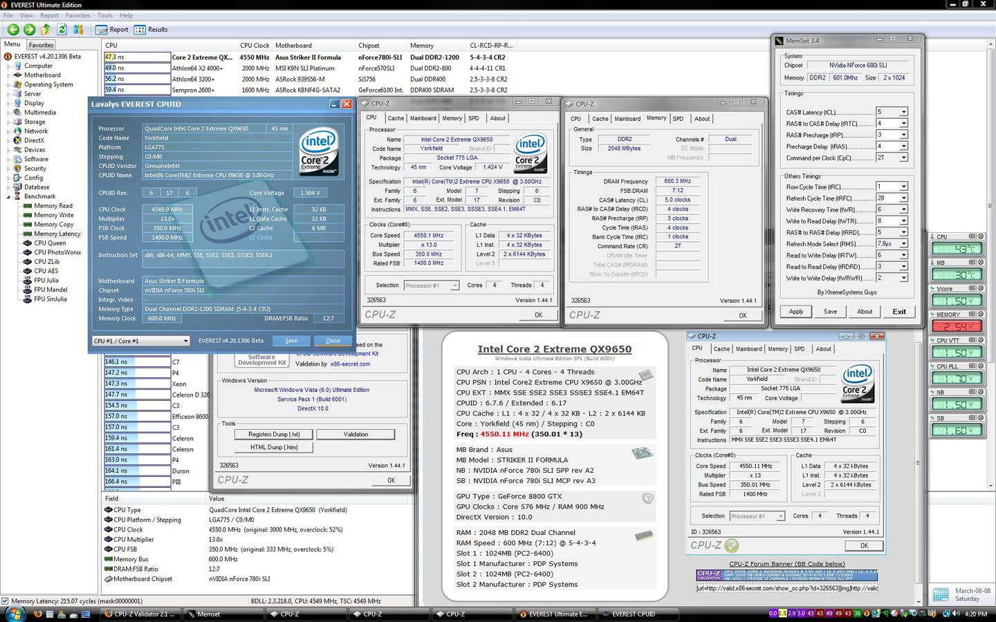

Results:
In all cases, the setup was left for 12h idle and 3x 1024M tests in wPrime
*Note, the cpu is running at 4.2GHz
Didn't bother doing Shin Etsu since it proved to be not as good as AS5... (*typo)
Also to note about AS5 load -> Real temp 2.21 showed 53°, Asus Probe 2 showed 55°.
So I took the average of the two.
With the temps lowered a bit, I was able to beat my previous record of 4.55GHz and reached 4.7GHz on air!!!
And of course, CPU-Z Verified.
Yep, so that was my little QX9650 project.

Thanks guys, there is nothing more awarding than hearing positive feedback on a project with many hours of dedication.
Originally Posted by Cupcake View Post
lower that voltage or you will end up with a dead chip with a voided warranty
Voltage is raised so much only to achieve the max OC. From my sig, you can see that I run 4.2GHz at 1.375V very stable. Oh, and warranty is already voided - lapped cpu?!
BTW Remount with no TIM, on a good lap job you usually get better temps with just metal on metal
Yes, I will try that, as well, as Xphobe suggested, with MX2, and will post the results.
Originally Posted by lior307 View Post
Now you need to try this CPU on DICE/LN2. You'll get stunning results with this cooling
I'm planning on moving into phase change and building a custom system this summer. I'll definitely keep ya'll posted.
Originally Posted by Thakkerson View Post
Very good! Ive seen sumone do it 1.6V 5ghz on air! Can you try that out? Im sure you can do it. Youre pretty good! Dang. What an idol. 5ghz please ^^.. and show the world what a Striker II Formula bed can do!
Where did you see that? The very max I was able to squeeze out of my proc, was 4.75GHz, but it was so unstable that I didn't even have time to take a screeny. You see, as I found out, there is no way to score a higher OC at 1.6V on air, because even at my 4.7GHz, idle was 50° and load is 72°. If I raise either the volts or the freq, temps are going insane and windows crashes.
P.S.

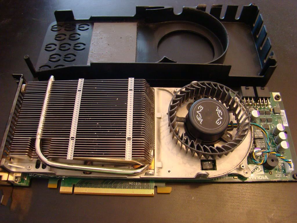

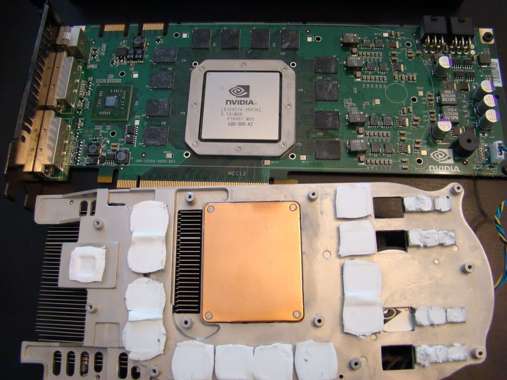

I forgot to mention that I put NB and SB on AS5 as well as my 8800GTX.
From the screen with the overclock you see the Everest temps in the corner, and (from left to right) first is 49° diode and 40° gpu. This made it possible for a 666/2100 overclock.
