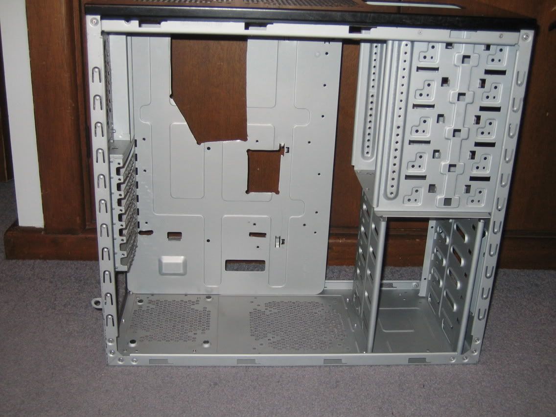

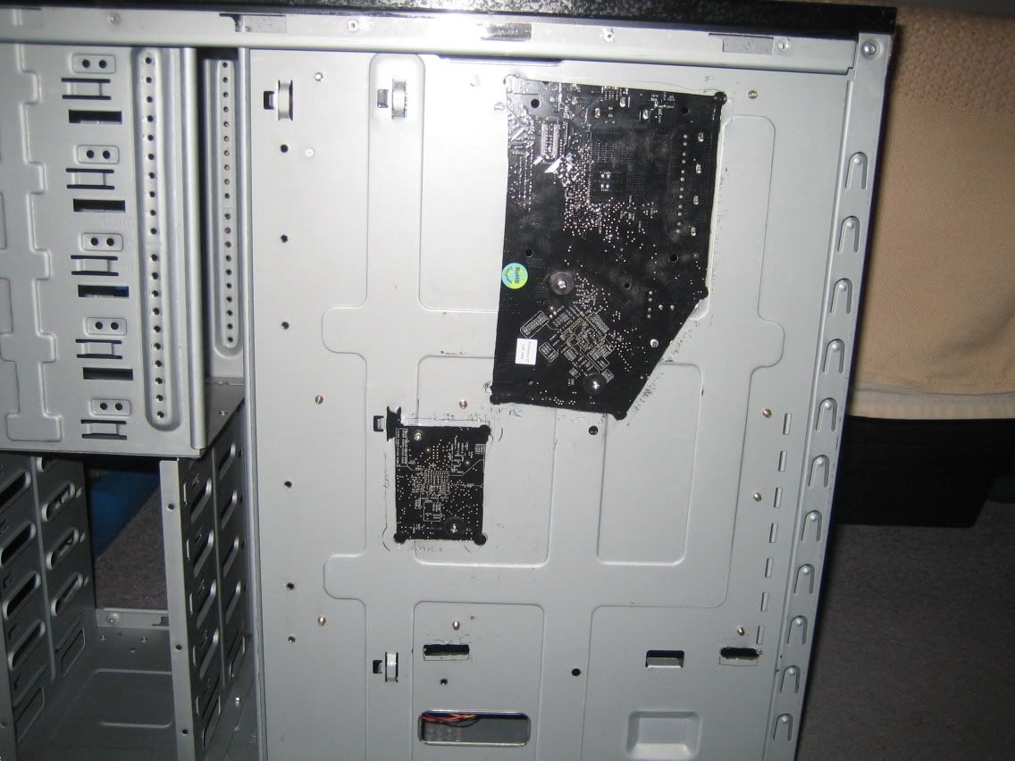

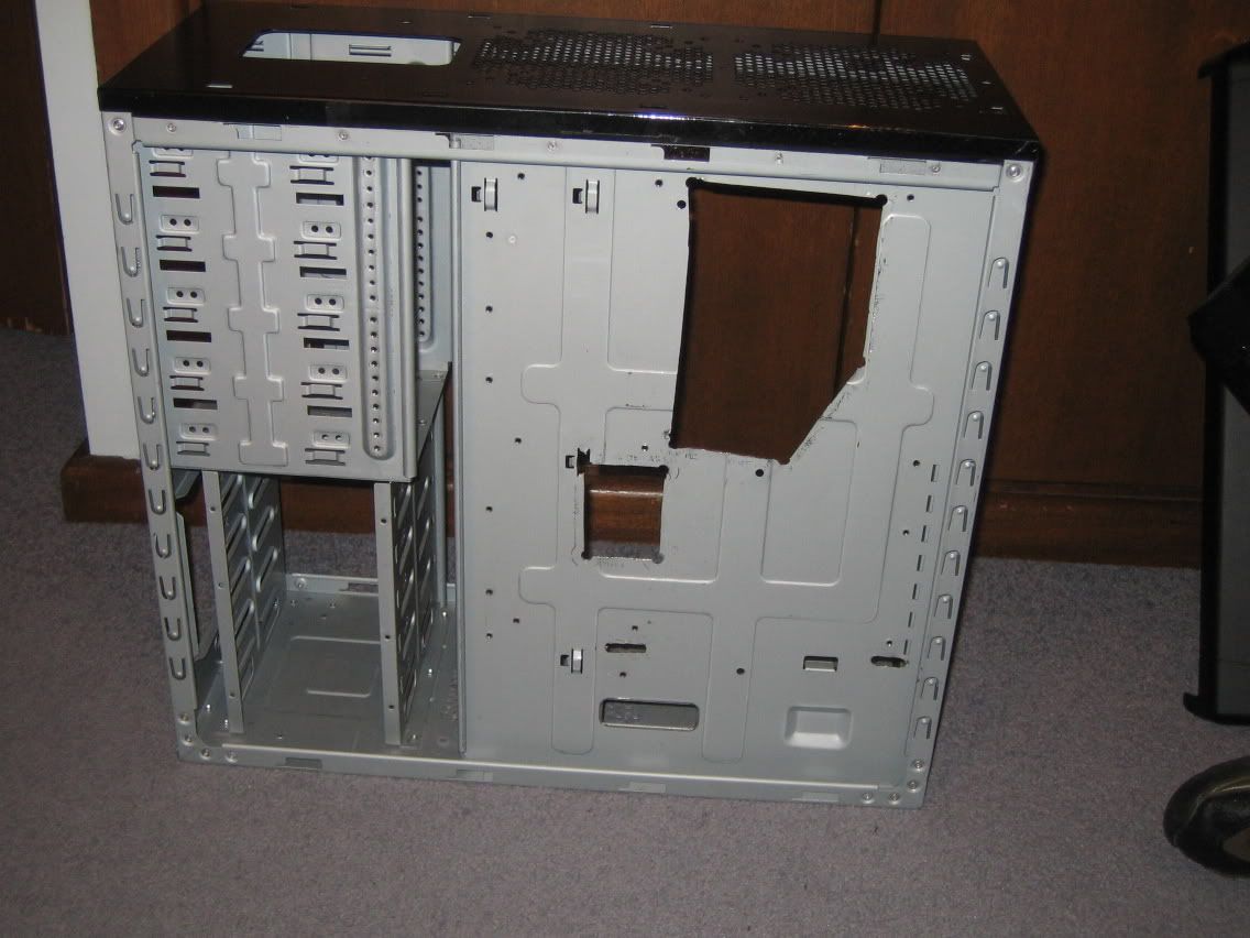

    Cut holes directly behind CPU, Northbridge and Southbridge, so I can change the waterblocks/heatsinks or the CPU (CPU waterblock uses a backplate) without having to take the motherboard out.

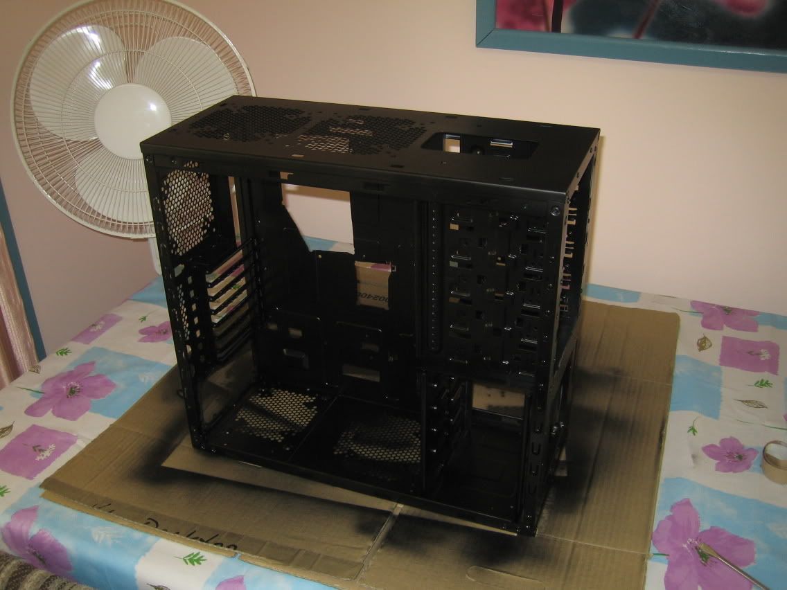

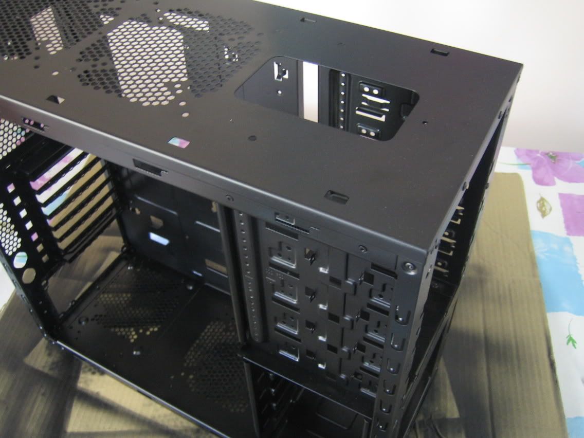

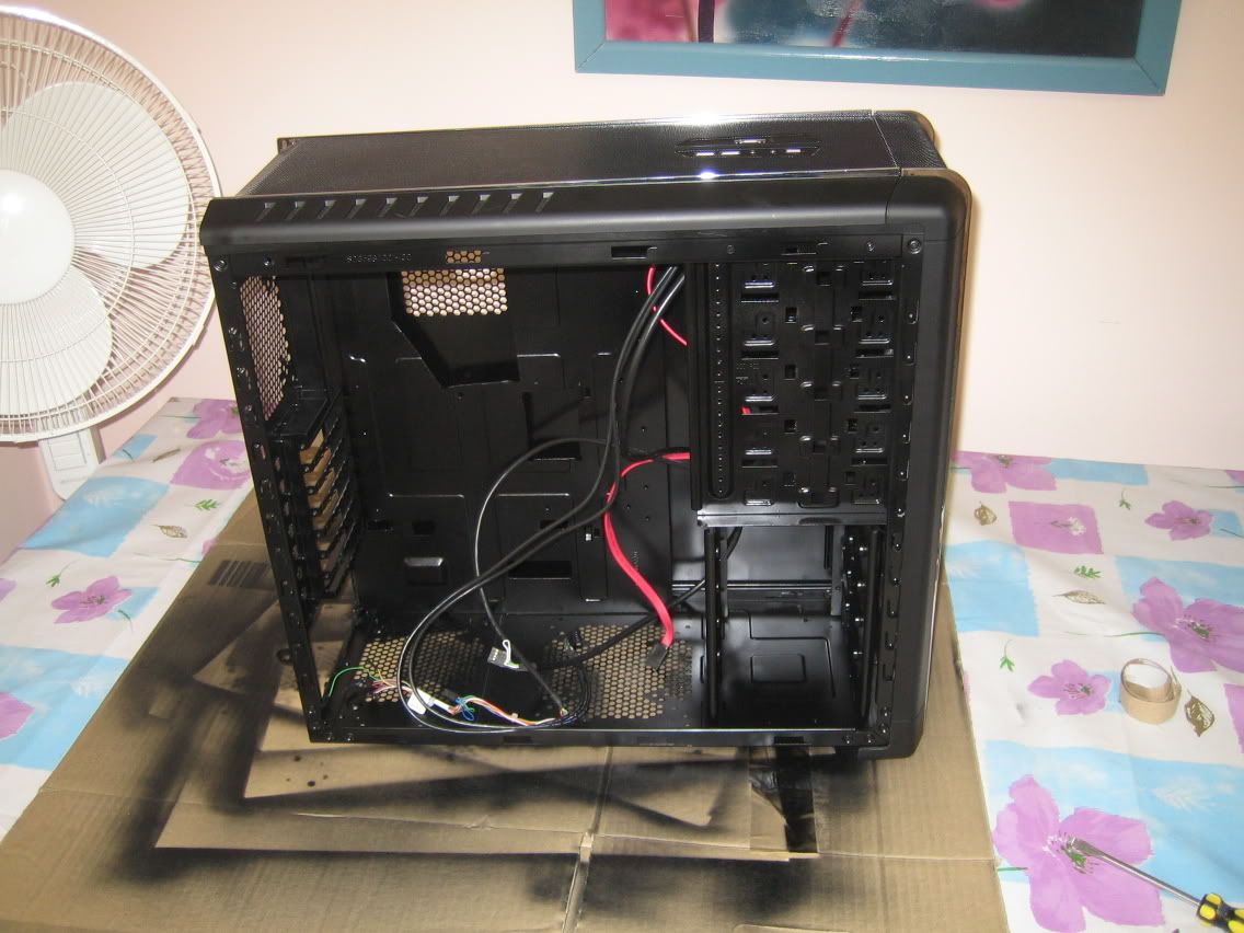

    Sand the inside of the case with 800 Grit wet-dry sandpaper and then spray with a Satin Black Acrylic spray paint. I had considered getting the case powder coated, but it was going to cost AU$100+ which, compared to AU$10-15 for good spray paint, wasn't worth it.

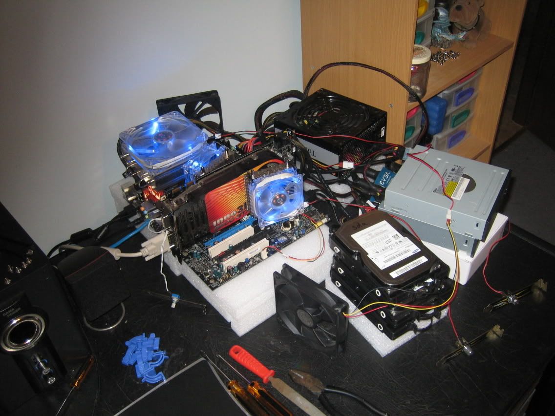

    My computer at the moment:
    http://i113.photobucket.com/albums/n...r/IMG_5515.jpg

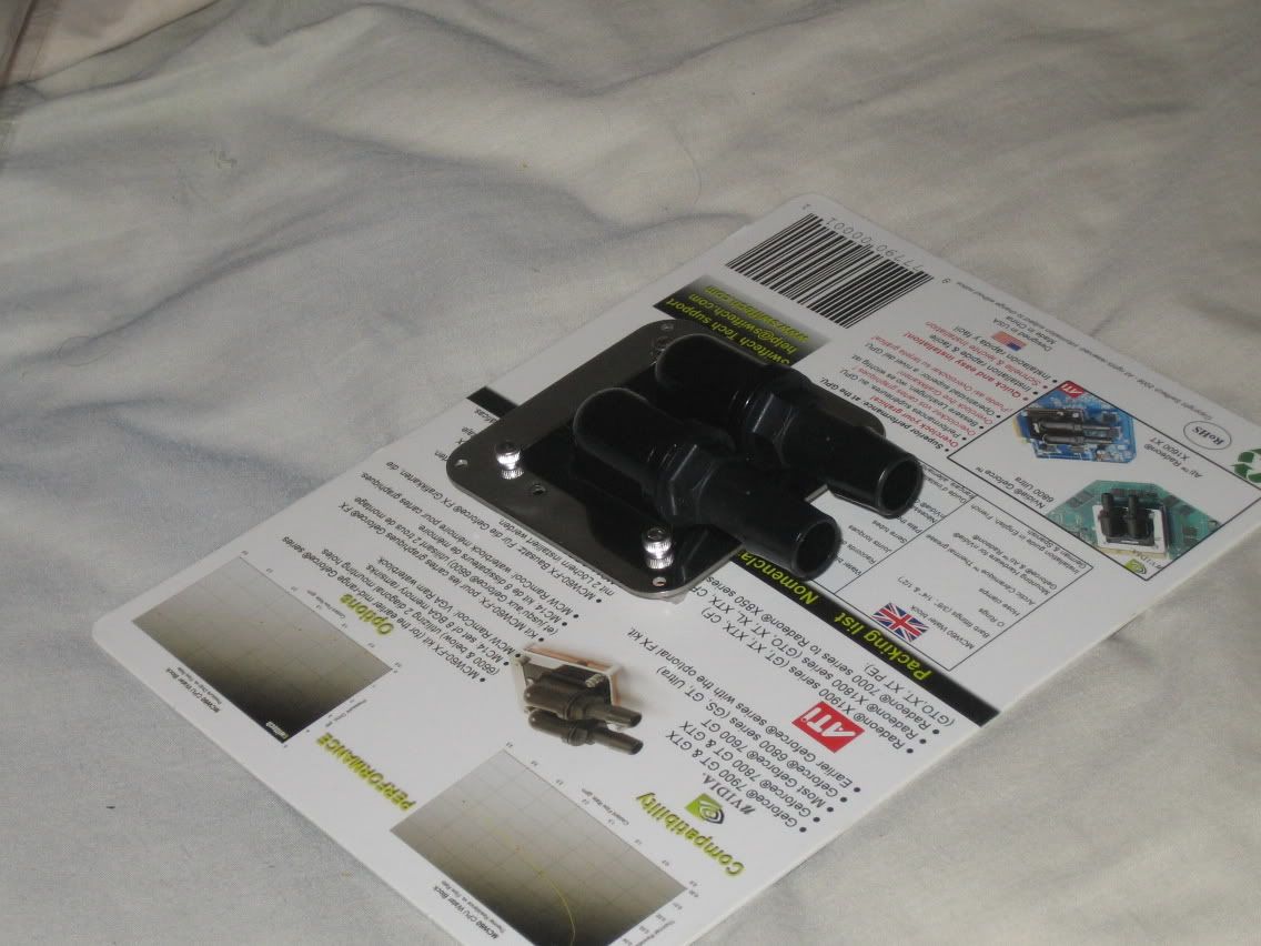

    My shiny new Swiftech MCW60 w/ G80 adapter plate:
    http://i113.photobucket.com/albums/n...r/IMG_5507.jpg
    Won't install it on the GPU until the rest of my water gets here.

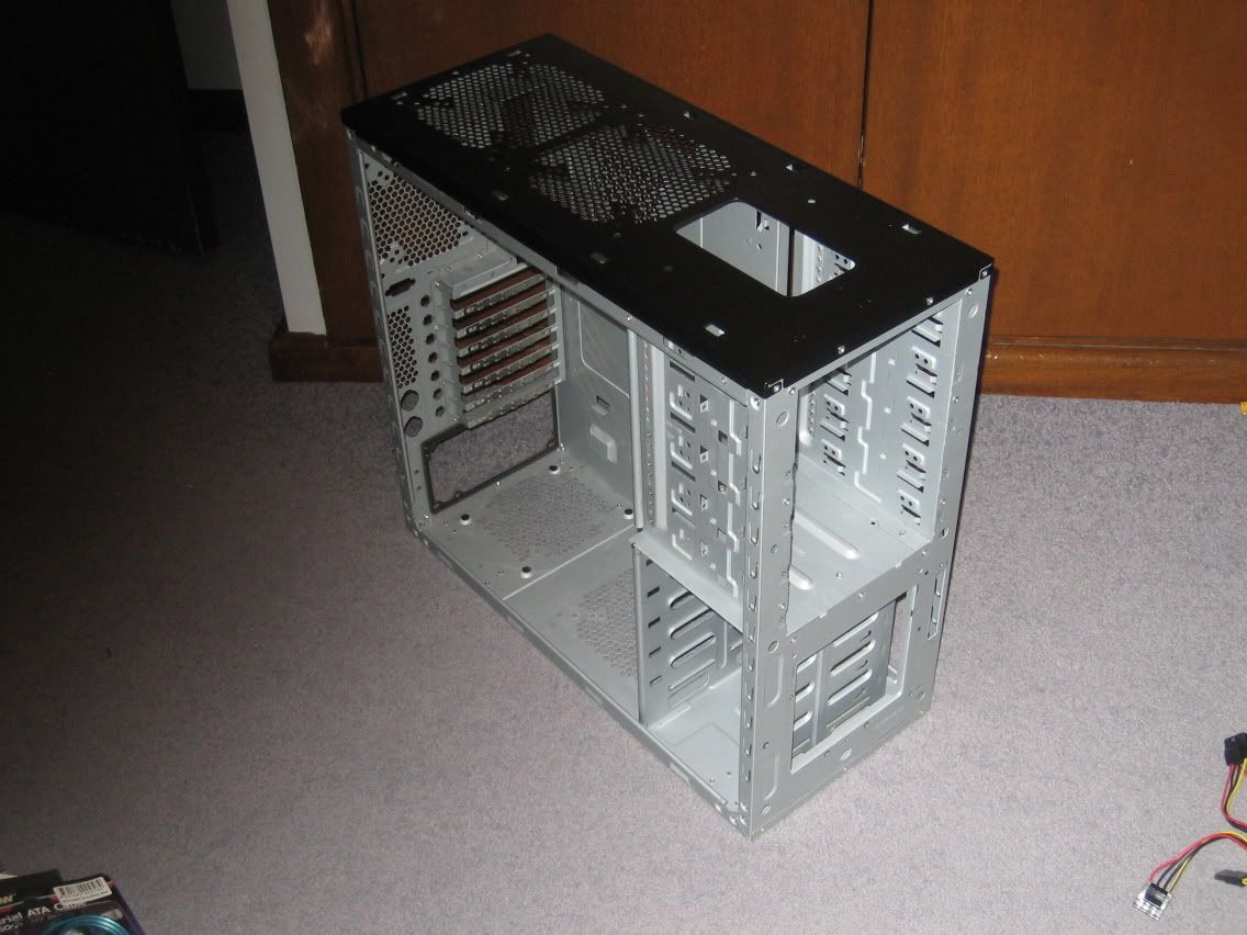

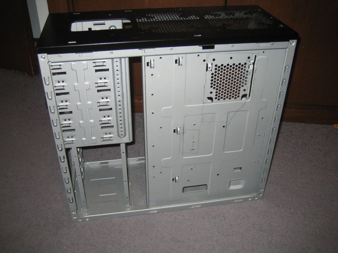

    Case stripped down to the bare metal, ready to be cut, cleaned then sprayed:
    http://i113.photobucket.com/albums/n...r/IMG_5503.jpg
    Back of the case, with rough markings for where the mobo tray will be cut:
    http://i113.photobucket.com/albums/n...r/IMG_5518.jpg

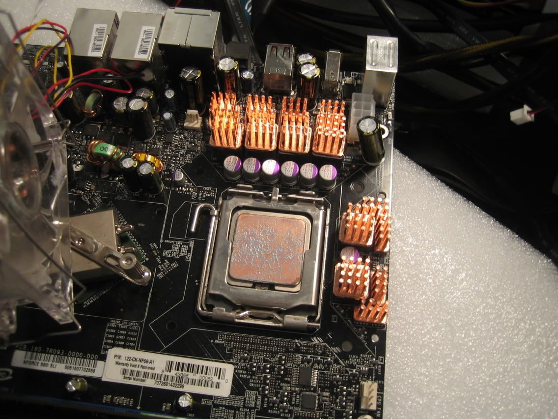

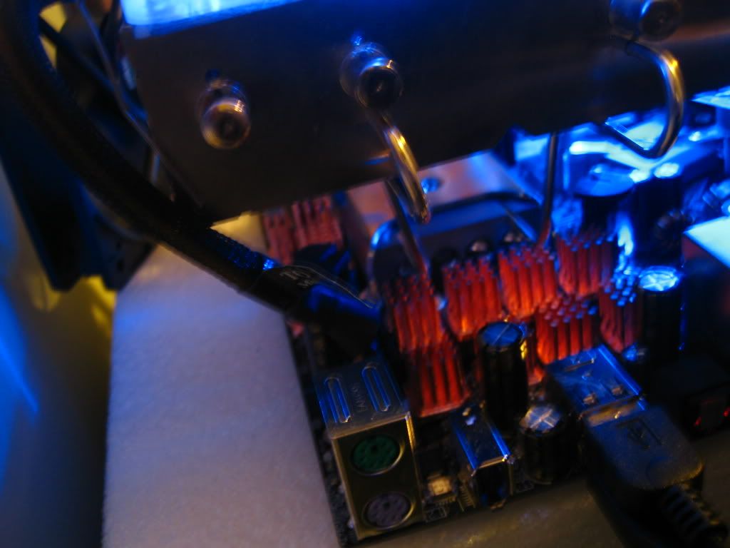

    I made a slight boo-boo when it came to your viewing pleasure. I replaced all the mofset heatsinks with Swiftech MC14 Ramsinks, as well as put ramsinks on all the chokes. However in my excitement, I forgot to take photos before I re-mounted the CPU heatsink. These are the best I can do for now, but I'll have some proper ones when my CPU waterblock gets here:
    http://i113.photobucket.com/albums/n...r/IMG_5514.jpg
    http://i113.photobucket.com/albums/n...r/IMG_5522.jpg
    That's all I have for now. Tomorrow I'm going to cut out the holes in the motherboard tray, sand back and clean the case, and then spray black. After that, it's all up to the postal service as to when the next update will be
