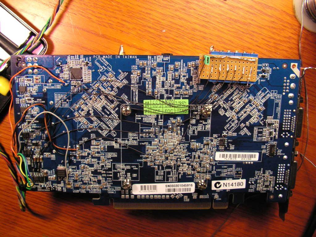

    I found Vgpu, Vdimm, Vdroop mods (Gigabyte had already done the OCP mod for me )
    There are also 4 more voltages that are controlled off a quad op amp which i have no idea what they are for. When i test these mods ill get some voltage readings, maybe it could be worth modding them as well
    (Pics up hopefully tomorrow)

  22. #847
    Aug 2005
    Melbourne, Australia
    942
    A sneak preview:
    I modded every voltage i could find, ill post an update after i test it.
    Q9550 || DFI P45 Jr || 4x 2G generic ram || 4870X2 || Aerocool M40 case || 3TB storage

    Quote Originally Posted by Demo View Post
    Why does that galaxy use 2 six PCIE power connectors?
    I think Galaxy claimed that the 3 phase power needed extra juice compared to the 2 phase PCB design. I might be wrong on this one!
    Quote Originally Posted by oohms View Post
    A sneak preview:
    This is INSANE! I love it! Which PCB design is this and which power regulator is on this card?
