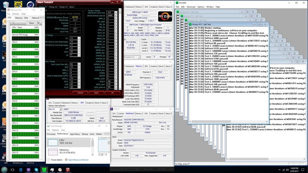

    Ok so I did some investigating.
    I am NOT CLAIMING STABILITY yet. I am just merely testing the limits of the IMC with Dual Rank dimms.
    As we can see in this screenshot I have either found the limit of ram @ 1.35v or a IMC limitation.

    Ok here goes Its ugly cas latency but working is better than not working.
    ONCE AGAIN IMC EXPLORATION ONLY. NOT CLAIMING STABILITY
    There appears to be a CL hole between 14-17 not to mention odds are not even applying with certain dividers currently.
    I see no reason why these sticks can not do 2933 at cas 14-17 other than a hole.
    I skipped 18-16-16 testing as I saw no point but I can revisit it later.
    once again 18-10-10 was problematic.
    Based on these findings and the above findings @ 2600 speeds I had a funny feeling that AMD killed the 10 subtiming support lvl.
    I had a set of corsair platinums that after recent agesa update in bios refused to load at XMP 10-12-12-28 @ 2400. Hmmmmm...
    I tested the theory loaded defaults shoved them in set timings 12-12-12-28. Boom posted right up just fine.
    Next up on the testing is to run 32m PI again at the best 2666 timings and the best 2933 timings to see if raw speed plus fabric beats better timings with less speed and less fabric.
    Oh and pc3200 with dual rank is on the list when i can figure out how to do it.
    I have this funny feeling it will require the cpu slightly sub 0 but i could be wrong.

    Just about any B350 is weak overclocked but I can kick peoples azz on it with memory tuning, fun stuff.
    I was starting to get the hang of memory tweaking the board yesterday I was able to do some testing with the memory at 3800, but the chip was severely hampered for overclock. I was only able to push it to 3.7-3.8 with the memory pushed that far.
