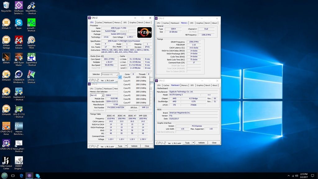

    Quick look at Ryzen Master. Not much to say its software overclocking. I guess if i had time i could have checked to see if I had any better cores maybe one or a few can go a tad higher. Multiplier Increments per core are .25 which is usefull considering .25 can make a difference between prime stable and not on thses chips. Would prefer to have this option in bios though. I only use stuff like this when chasing high clocks on ln2 so i dont have to boot at high speeds which could unecessarily load chip possibly killing board and cpu.
    As we can see these are my IDLE temps and clocks I will be using for the entire report.

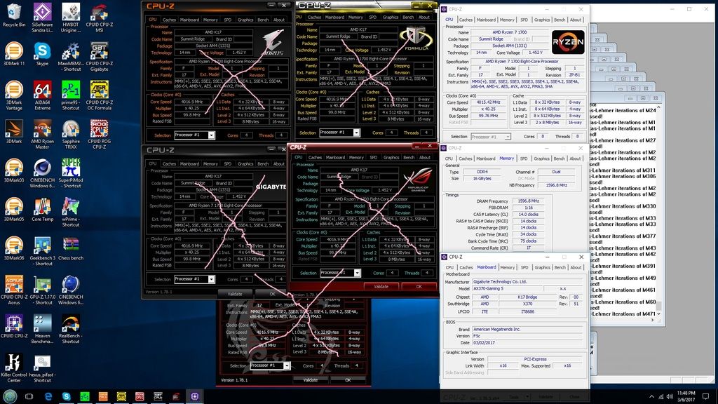

    This is a cpu review and it my responsibilty as a enthusiast and Professional Overclocker to know and solve any issues my hardware may be causing to hinder the review.
    Anyone can throw clocks up run a few benches and call it stable. Its preety misleading so I usually take the time to run and show stability and temps while stress testing and the conditions I am testing in. Antartica outside in winter anyone? You get the idea. It's 74F in the house my wife likes it warm.
    Prime 95 2hours in temp readings, I think now you can start to see one of the limitations. Oddly enough heat out of the heatsink feels like 40-45c. My 290x's in crossfire on water dump 50C loaded after a few hours. I'm very familiar with what the temp feels like. This feels cooler.
    Prime 95 4 hours in. I decided to run some cinebench, watch the AMD stream and post on forums just to really make sure the speed was rock solid stable.
    Prime 95 18 hours stable. Usually I run 24h but with the PWM being a big concern I did not want to wake up to a house fire so i killed system to get some sleep as i was way behind and had no results yet with the 1700. Needless to say I think we can call this preety stable.
    System specs for all tests.
    Ancient PC power and cooling 1200w single rail 100 amp PSU. ( i tested multi rail no gains no loss fan died swapped it out, fury X does 10 mhz more on single rail, cpu 0mhz )
    Sapphire R9 Fury X ( latest official driver)
    Gigabyte x370 gaming 5 ( Modified for fire prevention )
    Noctua NH-U12S SE-AM4 heatsink and fan ( I felt that if it came in reviewers box and it fit use it, water would have been a tad misleading for air guys...maybe )
    Kingston something or other V1 ancient 120g ssd
    Gskill 2x8g PC3200 14-14-14-34 1T XMP loaded
    WIN 10 64bit non activated non tweaked. ( ok so I downloaded a skin to make it look like win 7. sorry new OS was confusing )
