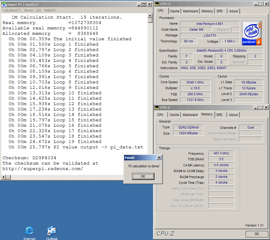

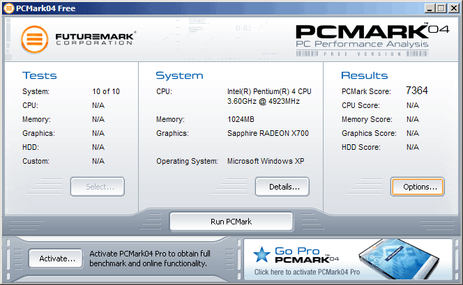

Note, I wasn't going for scores here, just using PCMark04 for stability testing. Mem was running a weak 5-5-5-15 1:1 to not interfere with the proc OCing. I turned up the mem for SPi, which is the last thing I did tonight. This is with just the CPU on water and it's looking really good so far...
At 1.525Vc, 4914 (273FSB) passes WITH score, 4950 (275FSB) finishes with NO score and 5040 (280FSB) crashes to the desktop. SOOOO close to a solid and stable 5GHz. It probably needs that full 1.55Vc setting which I can't give without running into the 1.60Vc idle range![]()
4914MHz (273FSB) 1.525Vc

SPi 1M @ 5040 would finish. I am really missing the 14x multi and FSB that the LockFree gave on the 670, but it's OK I guess considering it's 5GHz on water!!!!
"Suicide shot" if you want to call it that with 1.525Vc. An even 290FSB would lock up.
