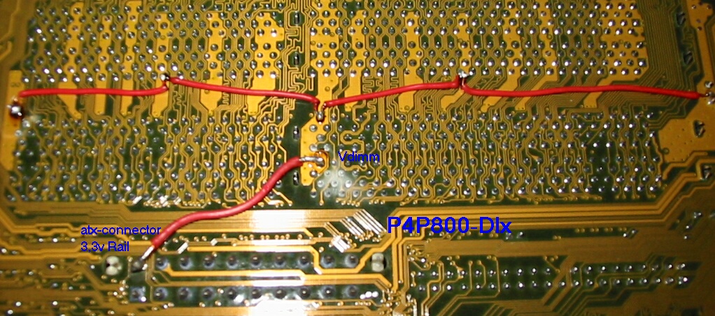

my thinking was "wy not bridging the vdimm-vrm and connected the 3,3v rail direktly to the dimm-slot."
so i soldered...
the mod:
... is simple. only connect the atx 3,3v (orange wire's) to vdimm-socket.
no opening trace or removing mosfet etc. is needed.
the wire sould be not to small. a lot of ampere flowing through.
(short calculation: "guess" 20 watt for 2 x 256mb made 6 ampere)
the little problem is: finding the correct pin(s) for vdimm !!!
(or the correct pin (leg) on vdimm-vrm-mosfet or vdimm blocking capacitor)
pro's are:
- stable and strong vdimm, especially under heavy load (memtest86 v3.0 #5)
- some psu's limiting the 3,3v-psu-mod with overvoltage protect.
- my psu (see above) need a deeper mod for upping the 3,3v rail...
- save power and produce less heat on vagp-vrm because 3,3v-rail is not so high.
- no heat on vdimm-vrm
- easy to mod

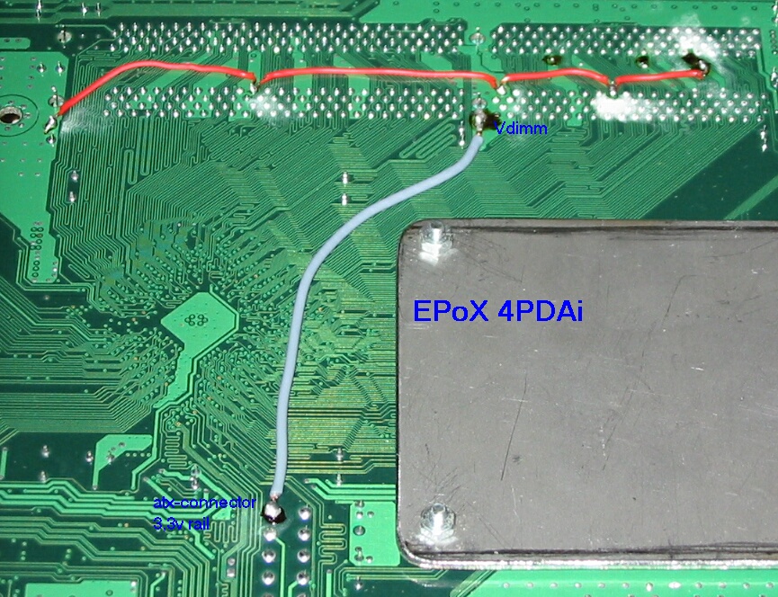

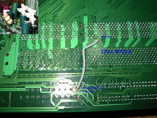

i have done this mod on asus p4p800-dlx and epox 4pdai. (see pics)
the red wire (along the socket) is not needed. it was only for research to "finding the last millivolt".
the vtt rising on both mobos "automatically" to half vdimm.
vdimm is now the same as 3.3vrail.
(fluctuating is pending from psu quality)
for me, in most win-applications 3,31v --> 3,31v and in memtest86 #5 3,31v --> 3,27v (meter on pin7)
again, watch out, vdimm is now possibly stronger and stable as before.
i will try this mod on is7-e too, but for a clean success an vtt mod is required.
