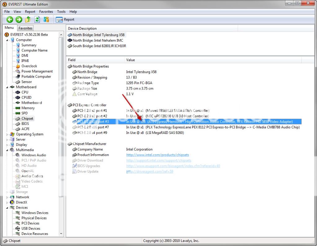

    Here is Everest showing the same, X16 on the video card with all 4 slots full (2 X1 sound cards & X8 RAID card):

    It is because you are only using a single 16x and a single 8x card, all others are 1x. It doesnt have to split lanes anywhere when there is just a single 16x card in the system. If you were using a 16x video card and three 8x RAID cards then all would be running at 8x.

    yep since you're not maxing out your PCIE lanes, you get full speed(of the card) on each pcie port.
