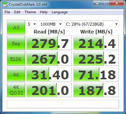

    alright .. I am using Intel AHCI drivers ... and new recently updated BIOS for the Asus mobo, and ran some tests, performance looking very good and incredibly stable using the SATA 6G now, check the image below
    [IMG] Uploaded with ImageShack.us[/IMG]

    Nice, what bios are you using on P6X58D motherboard now ?,
    and which bios giving you freezing problem ??

    i was using the original BIOS which i believe it was v07.** now i am using v0904 BIOS
