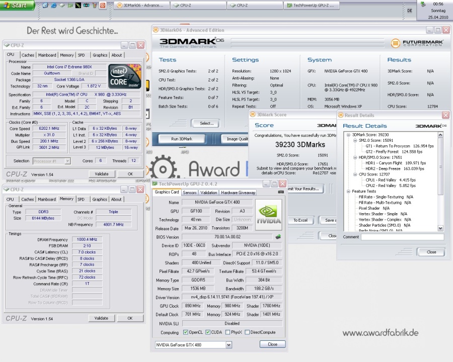

Test system:
Let's compare voltages RIIE vs. RIIIE
QPI is undervolting quite a lot with QPI LLC disabled (just like it was with RIIE) - booting higher results in higher QPI as booted at lower voltage and raised via TweakIT. As soon as you enable QPI LLC (make sure to have the latest BIOS - 0504 and later!) it will get much more accurate. With 1.350V set in Bios it was 1.31V without and 1.34V with QPI LLC. A feature I really missed on the RIIE so don't forget to set the jumper near the 24pin ATX plug![]()
Let's compare RIIE vs. RIIIE in 32m
Let's test some RAM - 6 GB @ DDR3-2250 32m easy, DDR3-2310 1m, DDR3-1900 with 12 GB 32mIt could also do CL7 past 2000 - I always had issues with that with my RAMs on RIIE.
Voltages during that RAM-Testing (kept it around thoose all the time)
Here are my Bios settings under air - so that you have a starting point
And some friends of mine - the BenchBrothers - already showed that this board also goes sky high under LN2
I can only say that this is one of the best boards I ever tested - great piece of hardware! 3 thumbs up![]()
