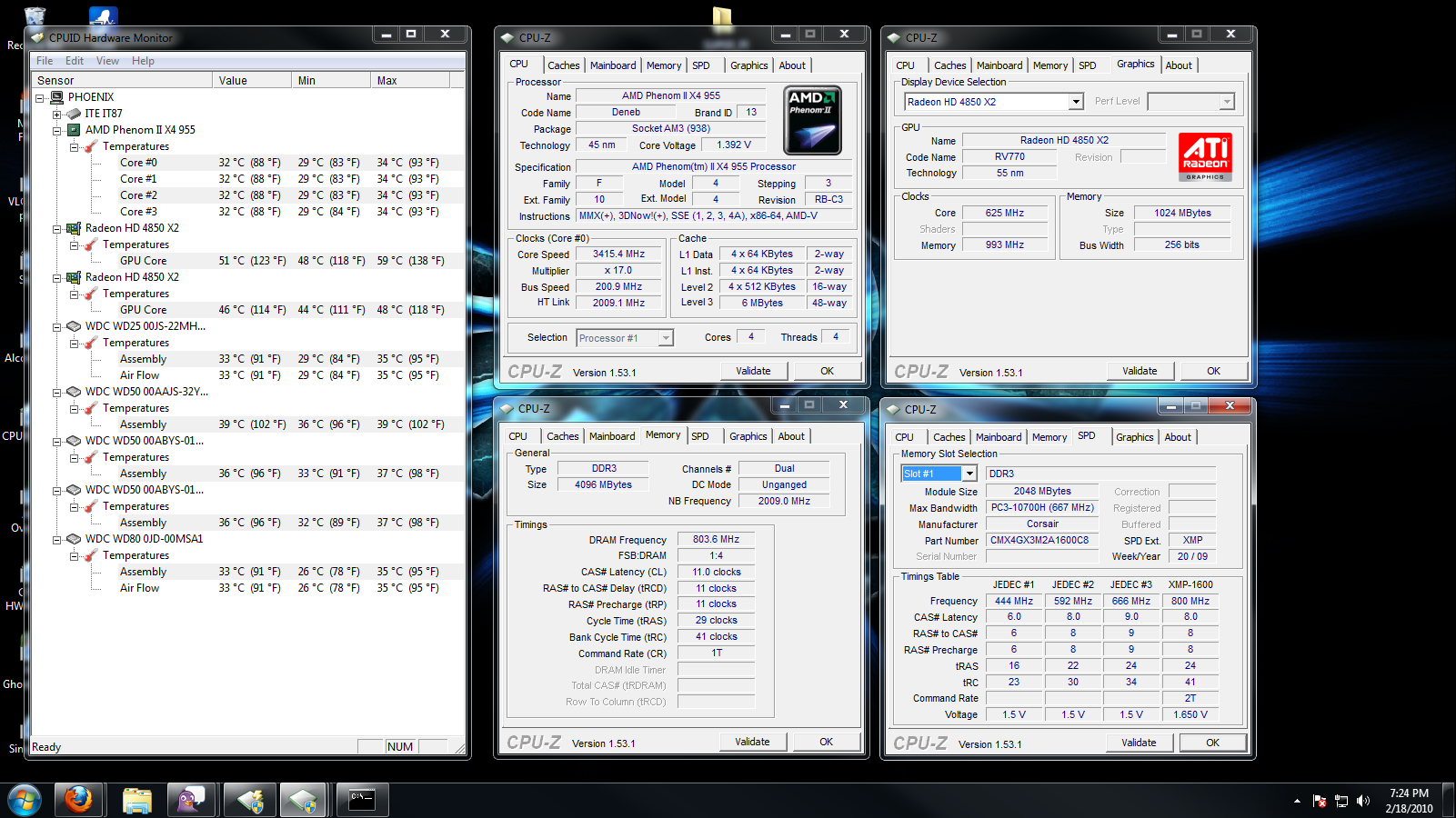

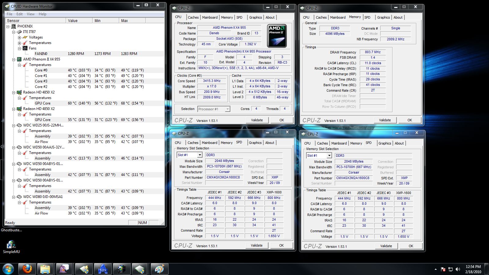

I've been staring at an Athlon 64 X2 @25C for three years now. I'm not entirely sure how I'm doing, or if my temps are well within reason. 40C idle on a Noctua NH-D14 seems a little high to me. Any input would be appreciated.

That does seem a little high for idle... how are the temps at load?
What's your ambient temperature? Looking at the temp of the hard drives your case isn't doing a good job or your ambient temp is high.

Definitely too high. Should be something within 28-35C. Have you tried re-seating it? Make sure to properly apply a proper TIM.
Oh, and hope your case has some ventilation.
yes i think a combination of hot ambients & poor airflow in the case - with 70f room temp my hard drive is at 86f and it is under my dvd drive completely away from the airflow in my case - when it was in hd bays in front of intake fan it was like 75f... his hard drives range from 102f-113f
edit: also interesting that his cpuz shows "Socket AM3 (938)" - w/ same cpuz version mine shows 939 lol and i was looking back at some of my old screenies which all show "Socket AM3 (939)" xcept one shows "Socket AM2+ (940)" & it was w/ my gd-70
edit again: also it looks like your ram isnt running in dual channel - what slots do you have the sticks in?

I'll try to address all of this at once. The ambient in my room flat sucks. It goes from scorching to freezing in something like half an hour. Second, I just reseated the heatsink. I had a suspicion I'd screwed up late last night. So we'll see here pretty soon if there's any change.
As for my case, it's an Xclio 1000, stuffed with too many hard drives. I'm dumping two of them off today and doing some rearranging. Hopefully that will give me some free moving air inside. I'll try and get a pic of the guts so you can see just how stuffed it is inside. At this very moment, my CPU is running at 36C.
Speaking of TIM, AS5 vs Noctua's TIM? Words from the wise? I have no problem tearing this down and reseating with the other if necessary. I'm running it with the AS5.

that's the best cooler out right now O_O now way that thing should even be near 50C with that monster.
also that 1.392 is probably more like 1.4125 under load, you could try a little less voltage most chips can use less at stock.

No load temps seem to be better (Between 28 and 35) What you see is a light load with ...pidgin, steam, paint, and of course the CPUZ windows open. As for the ram? ...I'll assault that in a bit. Taking out some of the dead weight HD's and reseating my heatsink certainly helped. A the point of print screen, the system had been up for about 4hours solid while I was running errands.
I'd say I've straightened some of the issues out at the moment.
dang man. tighten ur timings up! look at the spd rating in cpuz

Well it looks better already,as far as the voltage goes:
1.4v (what you have) should be enough for 3.6ghz and 1.250v for
3250mhz.
Do you have AOD (amd overdrive utility)? -allows to tweak a lot of staff from
windows![]()
8-8-8-24 is about as tight as I think I'm going to get it. I don't know much about mem ocing, and 7-7-7-21 caused my machine to puke. I'll poke at that again a little down the road.
I do have AOD. I've only just started poking at it. I generally don't use software to overclock. (Bad experiences with an MSI K9N-Neo mobo)
Overall it does seem to be my erratic ambient temps are causing the most problems.
I'll keep those voltages in mind.

temps are so much better, nice job![]()

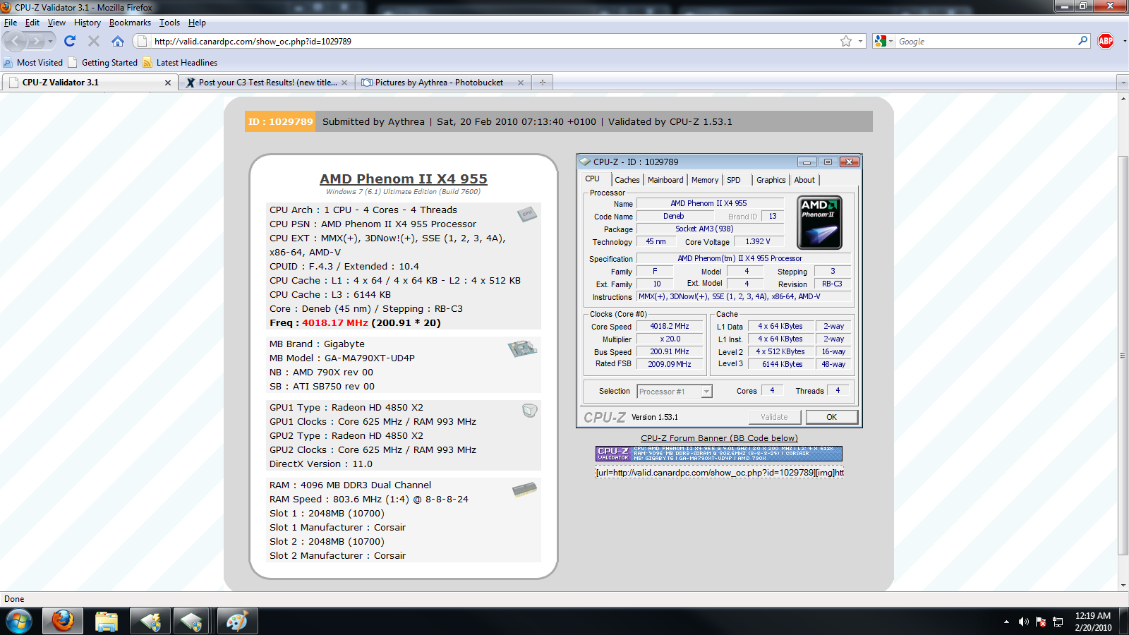

Here's what I've learned!
4Ghz is possible with this chip in a flat out. Don't try to prime95 with it. My success rate is 0.
A 19.5 X 200FSB is stable at 1.475v on the VCore.
20 x 200 is not stable and likely won't be without a more extreme cooling system. The NH-D14 is great at what it does. I'm just not sure I'm ready to jump much higher than 1.5v VCore on air with my erratic ambient temps. Although, Under load, my high is 48c. I might revisit that in the future.
Here are my results:
