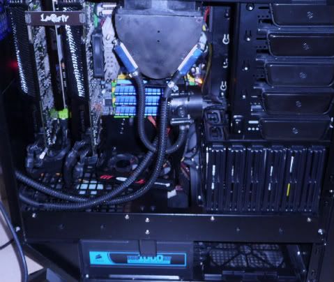

Pic of setup about the same as profile pic except with dfi

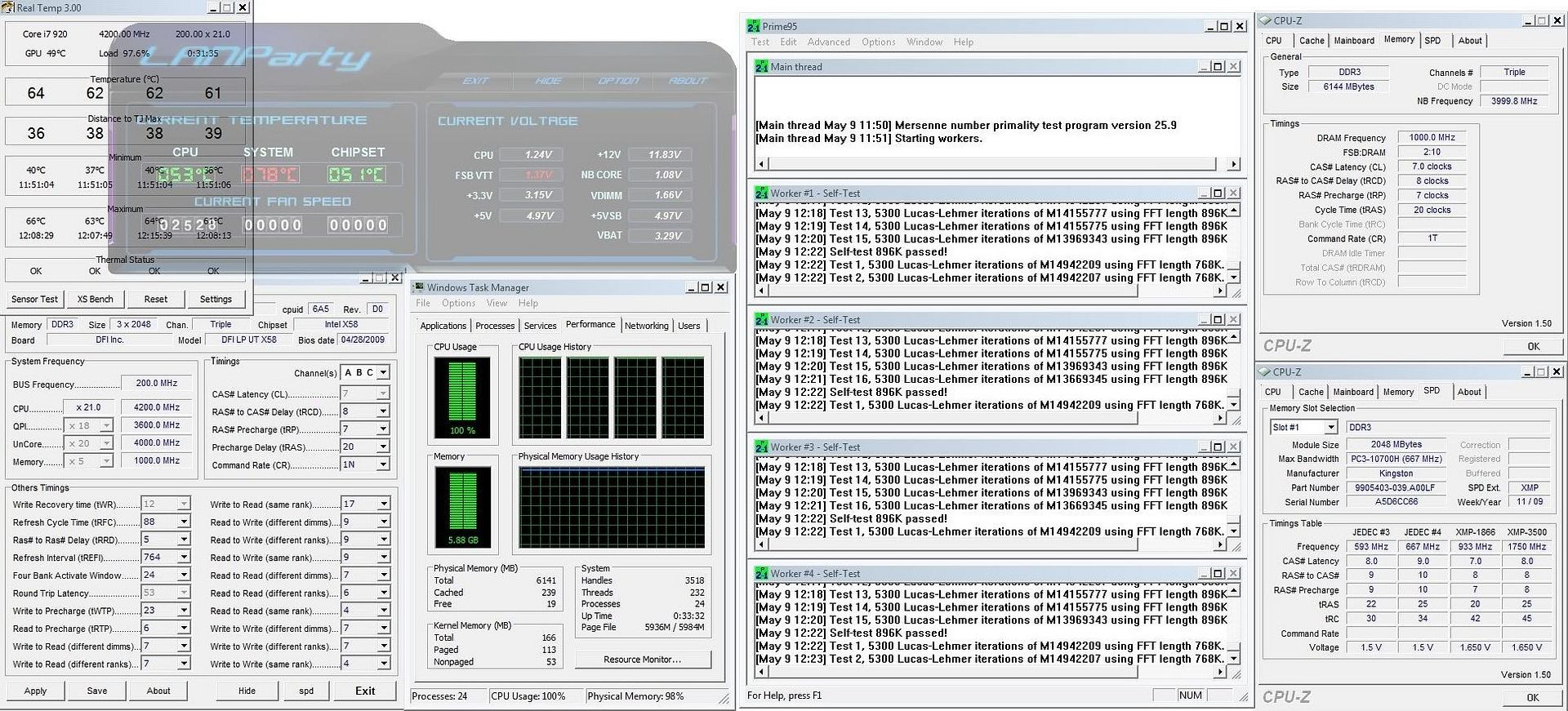

I find memtest hci and memtest86+ is fake on vdimm
hyperpi is somewhat fake cause all u need is to have stable vtt voltages
it will accept lower vdimm a lot by around 0..05v
prime95 set large fft then custom change run fft to 5.4gb is the best for vdimm
linx is best for vcore and ioh/ich voltages.
also HT off requires more vtt voltage than HT on
Test rig
I7 920
DFI UT X58 the8

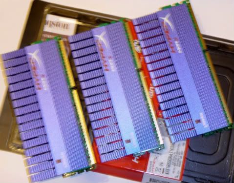

Kingston Hyperx T1 3x2gb 2000mhz CL8
GTx285 sli.
Rated at 2000mhz CL8-8-8-24 so it should run 1866 CL7-8-7-20 , 1600 CL6-7-6-18 at the same voltage
Result of rated speed
1.56set, DMM Read 1.551v - this is the UT default voltage
2000 8-8-8-24 1n vtt 1.37
1870 7-8-7-20 1n vtt 1.26
1600 6-7-6-18 1n vtt 1.21
1.65v set DMM Read 1.648 load
1720 6-7-6-18 1n vtt 1.23
1993 7-8-7-20 1n vtt 1.39
2100 8-8-8-24 1n vtt 1.48

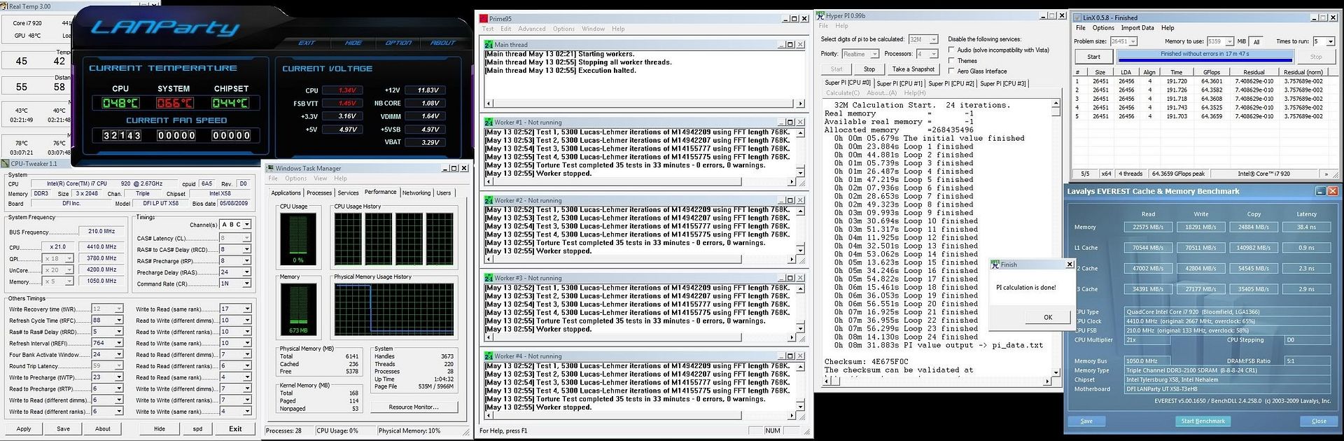

had to abort linx. ambient temp now 36C will do this again on a cooler day with a hr05 and some fans.
take note i am testing in the casing not a bench rig.
more to come.
was curious how fast is this with ht on
1.68v set DMM Read 1.673 load
2000mhz 7-8-7-20 1n 1.39vtt
Max Stable if u have the kahuna's to run prime95 is 1.86vdimm vtt 1.68v .. csl7 should be 1.96v for vdimm but i try to abstain going more than 1.9v on x58. trust me its stable. once u figure out the trick to this mobo.. its just upping to the voltage.
