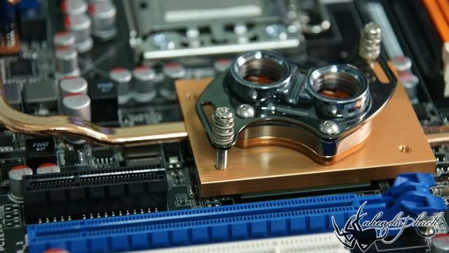

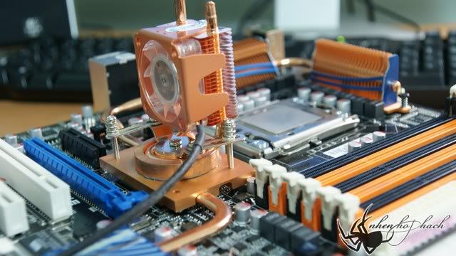

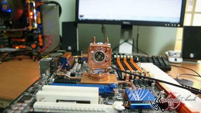

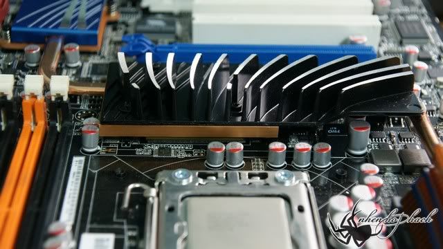

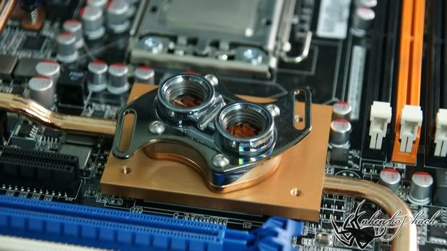

    p6T-Deluxe install HS for chipset and waterblock
    You must replace the top of NB
    After take out and clear
    Two hole fix all chipset waerblock anf HS
    I show 2 ways, HS and waterblock.
    Good luck.

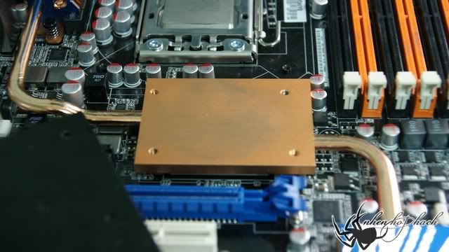

    this plate is from copper??
    also Can you post here a hole spacing on this plate ? and overall plate dimensions?

    Quote Originally Posted by Duniek View Post
    I have an idea
    Looks like aluminum to me (I'd imagine a plate of copper that large wouldn't be cheap or cost efficient for Asus) and you can also see some of the 'copper finish' worn off from the heatsink that was on top.

    Pretty sure it's copper. The patch that looks discolored, looks like it was from the thermal paste.

    Quote Originally Posted by aspire.comptech View Post
    No, it is aluminium.

    i for one was never a fan of putting a block ontop of a copper plate...
    I have an idea
    what scares me is i think i can guess....
    your gonna make a top, with a oring seal, and turn that plate into a waterblock arent you?
