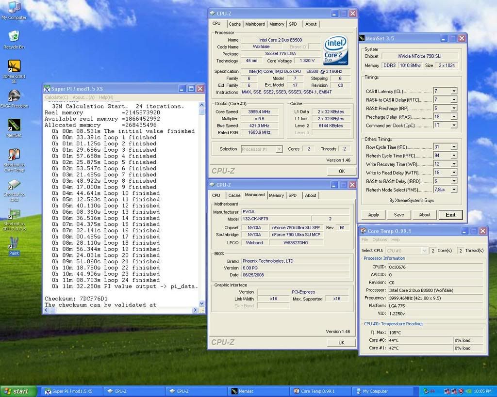

alright guys few days ago i got a parcel from the post office full of goodies. since im totally addicted to overclocking i thought i'd do small ocing report from these wonderful G-skill sticks for you guys, i have to say that i was really blown away by the clock speeds that i was able to pull off from these sticks when considering that these are rated at 1600mhz stock speeds![]()

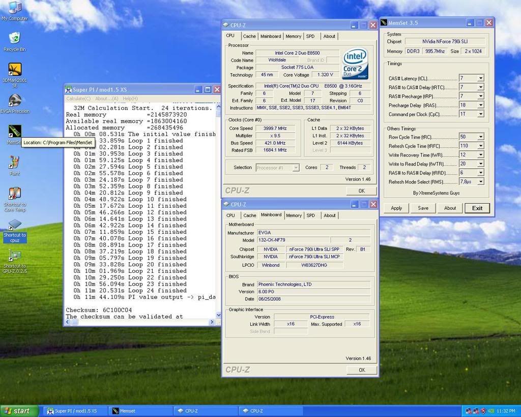

and on with the results that i was able to pull off from the G-Skill F3-12800CL7D-2GBHZ HZ sticks...all the results were done with unlinked mode. also take note that as this is an overclocking report, i used my motherboards highest possible voltage for the ddr3 ram witch is 2.275v... i would not recommend to use that as 24/7 voltage but for short benching sessions that should be safe
for testing the my overclocks stability i used superPi 32m
the max CL8 speed was 1029mhz (or 2058 mhz)
max cl7 was 995mhz (or 1990 mhz)
max CL6 was 842 mhz (or 1684 mhz)
and finally Cl5 witch max speed was 721 mhz (or 1482mhz)
got to say im really happy of my purchase these stick clock pretty damn well considering that they are relatively cheap!!!!
