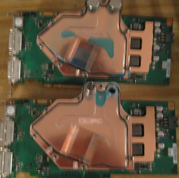

    Why is water getting in here?
    Look at the attached picture, do you see where the water is puddling up inside of my blocks? It shouldn't be ale to get in there! It is squeezed in between the copper and the lucite, and I don't get it! Shouldn't the flow going down to the left, along the bottom, and up out the other side, and not be able to leak through the section that is put there to make a channel?

    its called no O-RING

    The lower right hand corner of the bottom picture looks like it was leaking all the way through. Not good at all.

    Yeah I am a bit pissed about it, I told myself this was the last time I would rebuild this system, and once I get it all together I notice the video card is leeking about a drop a day. There is an O-ring, but it wasn't installed right. This is the second time I have had this problem with full cover blocks and their HUGE o rings. From now on with a new block I am going to take it apart and inspect the oring myself first.

    I just figured out that the copper plate is not perfectly flat.... That REALLY sucks too because I was very happy with the build quality of these blocks until now... Though now that the outer o-ring is installed correctly I don't think it will leak anymore, but the blue water in the center channel is not very attractive.... I would have expected more from $135 water blocks, and it happened to both of them....

    Yeah after fixing the O ring it no longer leaks out of the block, but the inside of the card is still leaking where it shouldn't, It doesn't seem to hurt flow because after 20 minutes of COD4 (at 1920 x 1200 4xAA 4xAF) temps on both cards are 35C and realtemp says my E8400 @4ghz is at 29/30C.

    there's water there because there's no oring to prevent it from NOT going there...

    Are you sure there isn't an inner O-ring. Its highly unusual.

    although i dont quite like how the blue liquid looks in there, i think thats how its supposed to be...take a look here
    http://www.xtremesystems.org/forums/...xspc+gpu+block
    or XSPC site
    http://www.xspc.biz/razor9600gt.php
    it appears that the "forgotten" o-ring is just not a part of the block..
    i doubt emailing xspc would yield any results but you could try...otherwise you could modify the acrylic to fit one oring yourself

    I think that some water is going to get in the middle portion of the block. It's not sealed so there is potential for a bit to flow in between the surfaces of the copper and acrylic. The majority of the water should be flowing through the gpu portion of the block and should work just fine. Just think of it as some extra cooling for the middle portion.

    it seems that XSPC blocks, same as the EK blocks, dont create a barrier between the channel and some coolant can flow over the mid section... but a majority of the coolant flows through the channels as designated...
    it may have been a matter of seating your O-ring properly?

    It does suck big time, but looking at the higher res pics, you can see a bit of a gap between the plex and the block

    Yeah, you can see that the water path itself is sealed on the outside, so there shouldn't be any water leaking out of the block itself, but the inner space is going to allow seepage. Not really an issue, except from an aesthetics point of view. I doubt it's affecting flow much, if at all.
    HOWEVER, in the OP's pictures, it's obvious that the O-ring itself is leaking, particularly near the bottom-right screw. That's not good at all. Time to RMA some blocks, I think...
