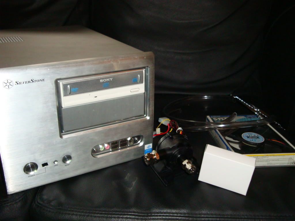

I've wanted to do this project for a little while now because there is pretty much no other way to get decent cooling with this motherboard/case combo. I also wanted to really see how far this mobo/cpu would overclock. Finally, 3 years and a new system later, this system is running with good temps and maxxed freqs.
Specs:
Mobo: AOpen i915GMm-HFS
Case: Silverstone SG-01
CPU: Pentium M 760 (2GHz)
RAM: Kingston HyperX DDR2-533
The system with some of the stuff to go in it:
Inside the system with air cooling:

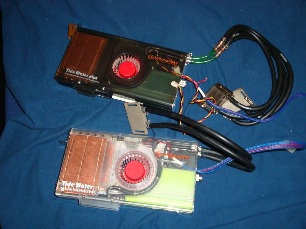

About the Thermaltake Tidewater: I originally purchased this because the air cooler was so poor. This 'all in one' watercooling system was plagued with problems though. First, the blower fan is really really loud.. Thermaltake lied when they said it only generated 25dBa.. more like 35. Second, the pump died after less than a year. So I got the Tidewater plus with 2 waterblocks, for the GPU too. That pump also died. It seems Thermaltake just discontinued the Tidewater series recently.. no traces of it on their website.
The tidewater units before going under the knife:

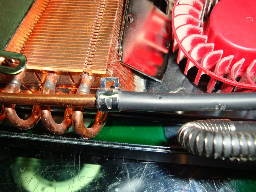

I don't know why they used some non-flexible hoses inside this one, it started leaking when I was taking it apart:

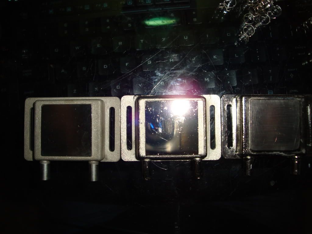

Three nickel-plated copper waterblocks. The rightmost one has poor machining and wasn't used:

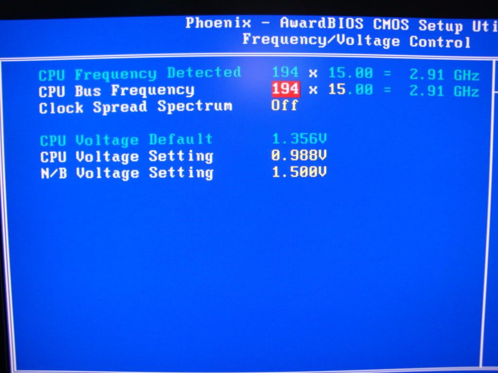

The first thing I did when the system was all apart, was pin-mod the CPU socket. By grounding VID5, the voltages between 0.7v and 1.196v are +0.512 (so really they're 1.212v-1708v). The voltages above are normal:

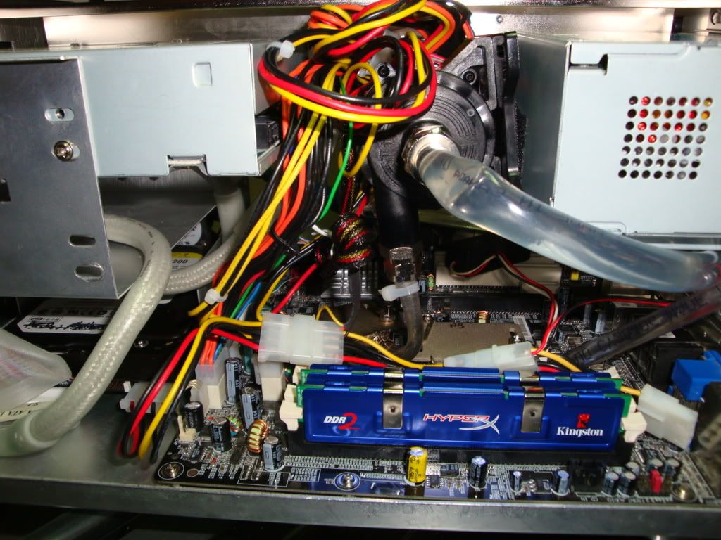

Mounting the pump and reservoir required creative use of velcro, lol:
Velcro brand! lol. Came with the res.

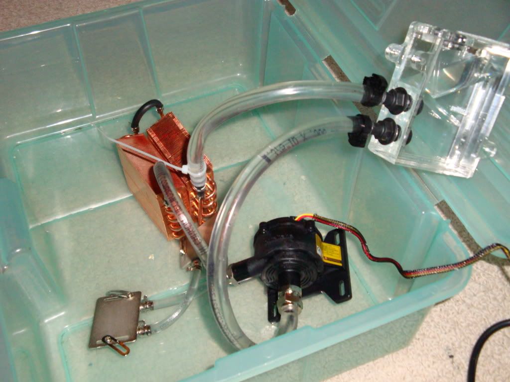

Initial leak testing:
Out-of-case testing:

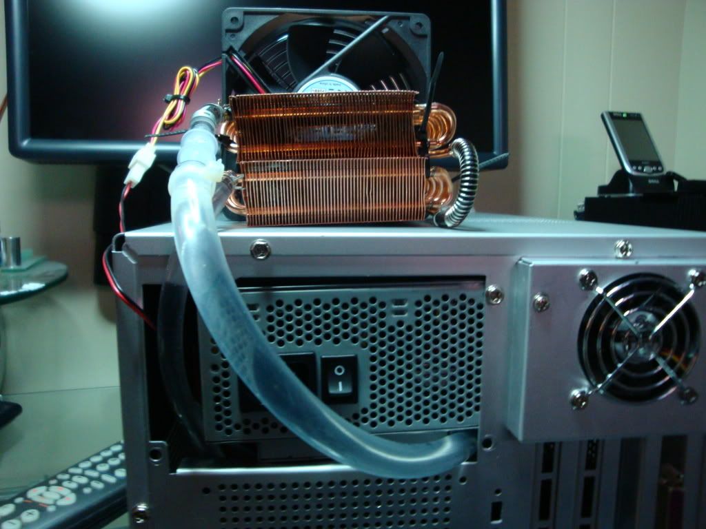

And 4 days later, inside of the case with water cooling. That big fat kink has no effect on the actual temps:
Closed up:
The final stable overclock was a bit disappointing at 2.72GHz but it did boot to the bios at 2.9GHz. The CPU voltage there lies, it's actually running at 1.5v:
