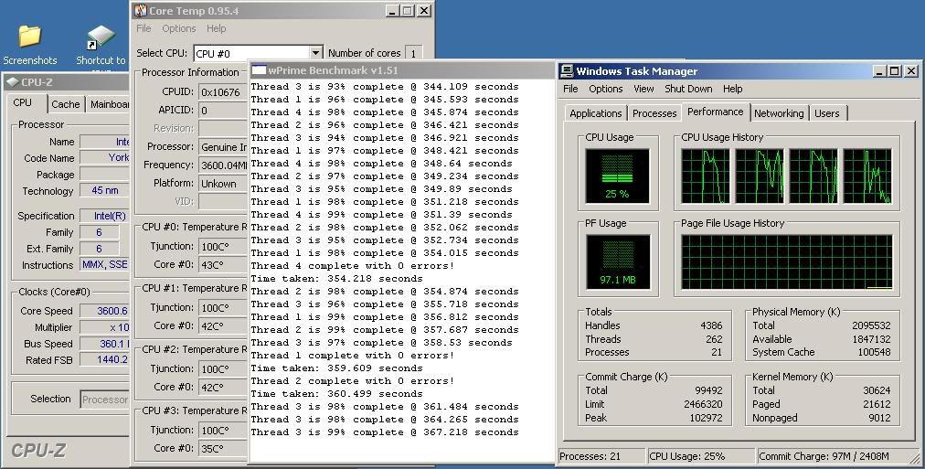

    Last night i tested Retail Yorkfield QX9650 on GA-P35-DQ6, after noticing odd behaviour on the weekend while benching under DICE.
    What i had previously observed was in quad core benches my scores were lower clock for clock than other's results on hwbot (not just tweaking, a whole 150-200MHz slower). Then i found that in wPrime, one thread (3) was consistantly slower than the rest by a great deal, to the point where the end of a 1024M run should have been finished yet thread 3 was still only at 97% and still running for a good 6s+ after that.
    Here's a screeny of 1024M at 3600MHz with thread 3 still running.
    This screenshot is not as obvious as my DICE results which had 1,2,4 all finishing at the same time, then 3 later.
    Thinking it might be a board/BIOS conflict with my X38T-DQ6, i swapped onto P35-DQ6 on air at 3600MHz.
    I ran a series of checks and noticed the same behvious yet again.
