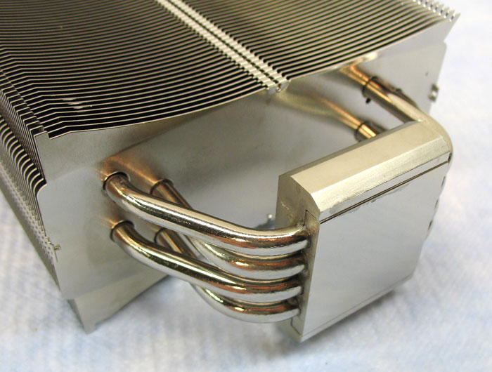

The ultra 120 has had considerable success even though the cpu contact has ridges which can be felt with a finger nail. For comparison here is a picture (this picture is from a website) - i didnt think of taking pictures until half way through the last heatsink.

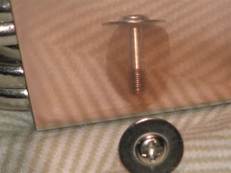

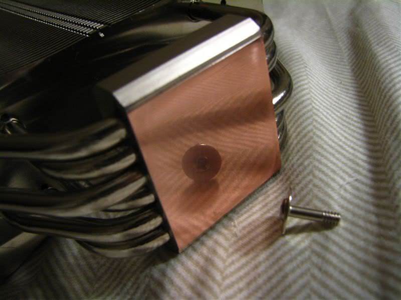

My method of lapping is to put a few drops of water on a flat surface like your kitchen worktop, place the sandpaper ontop, wet the top of the sandpaper with a few more drops and begin lapping. Moving in circular motions with a bit of downward pressure, I rinse away the black debris build up every few minutes. Rotate the way its held then repeat. After 2 hours of elbow grease, this is the result:
Neat eh? Well I decided to lap the processor too. I did this slightly different because I didnt want to get the CPU wet. Instead of putting water ontop of the sandpaper i did it dry and every minute wiped the processor and sandpaper with acetone to clean the debris build up. Several minutes later its smooth and mirror like, streaks can be seen but cannot be felt. I was happy with this.
