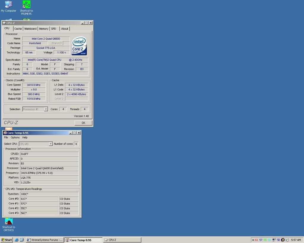

    If you own a Q6600, please reply with your VID and the stepping of your chip. The VID can be found using coretemp. If you're using vista, coretemp will not display the stepping in some cases, so you can use CPU-Z (it's listed under "revision") to get the stepping.
    Here is a shot of mine for reference:
    If all else fails, look on the box your q6600 came in; the last 5 letters after the Q6600 in the production code will tell you the stepping. "SLACR" means it's a G0 while "SL9UM" means it's an older B3. Here an example shot taken by XtremeTiramisu to give you an idea:
    So, I have a B3 w/ a VID of 1.2875v
