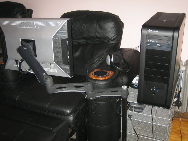

And now a batch of photos of the finished product:
TJ07's are nice when too much cooling is just right, eh?

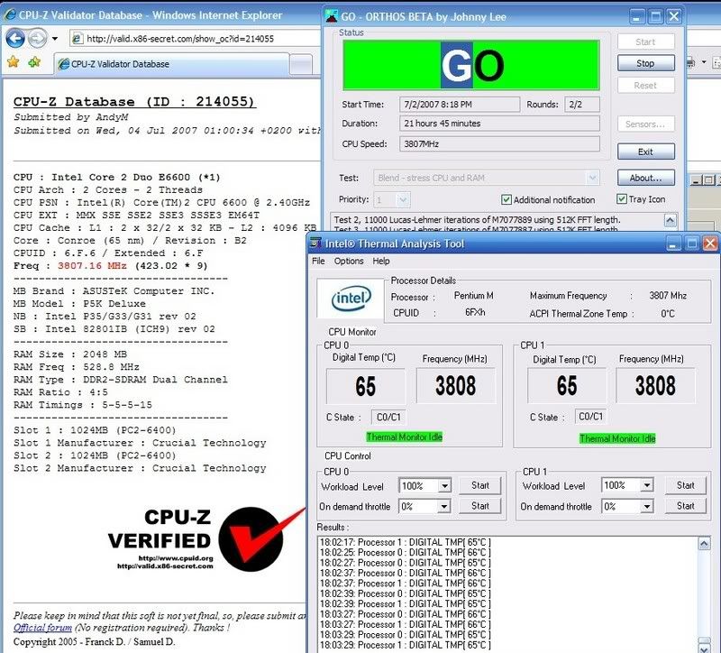

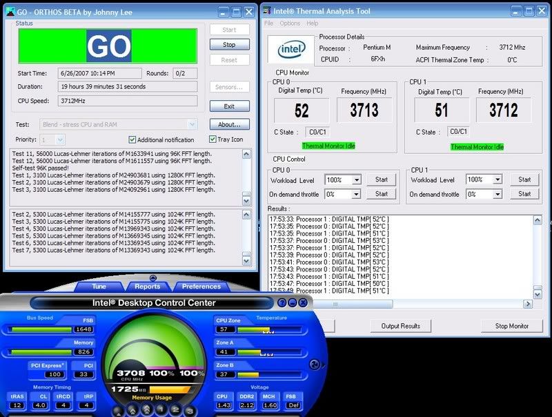

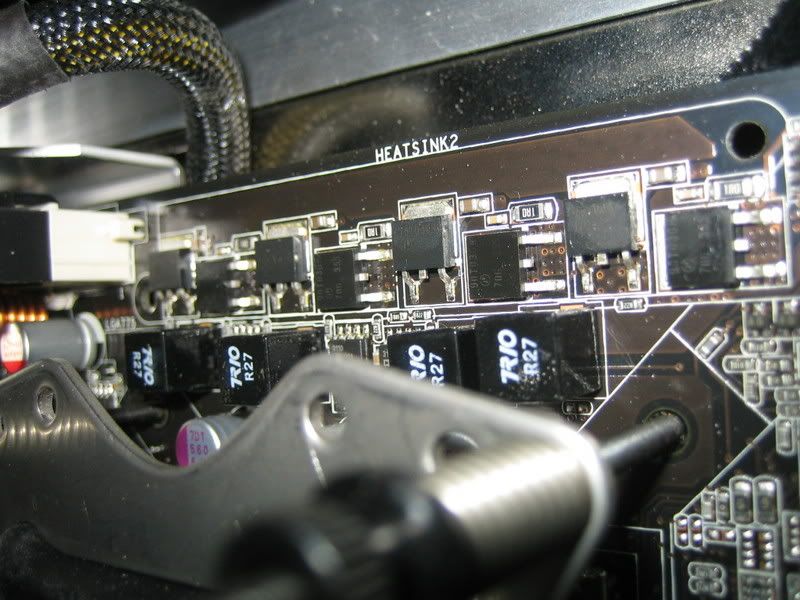

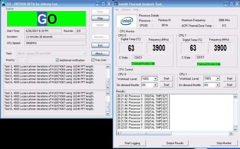

Below pics are some changes to the machine beyond the initial build...different MB, more blocks, and other misc. items. More info on these random photos buried in the thread
