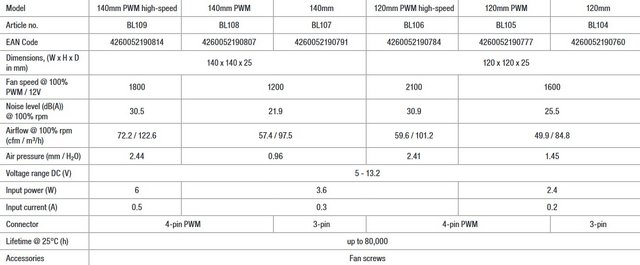

Before we move on to the Pure Wings 3 from be quiet!, let's first take a look at the specifications. If we focus on PWM models, there is always one slower and one faster (high-speed) variant across formats. In terms of 120mm fans, this means that the slower one (BL105) officially tops out at 1600 rpm, while for the high-speed one (BL106) it’s 2100 rpm. The 140mm Pure Wings 3 fans are slower – with a maximum of 1200 rpm (BL108) and 1800 rpm (BL109) respectively – but still, because of the larger cross-section, they are supposed to achieve higher airflow at a lower noise level. The maximum airflow of the Pure Wings 3 140mm fans is advertised at 97.5 and 122.6m3/hr. For the 120-millimeter ones, it is 84.8 and 101.2 m3/h.

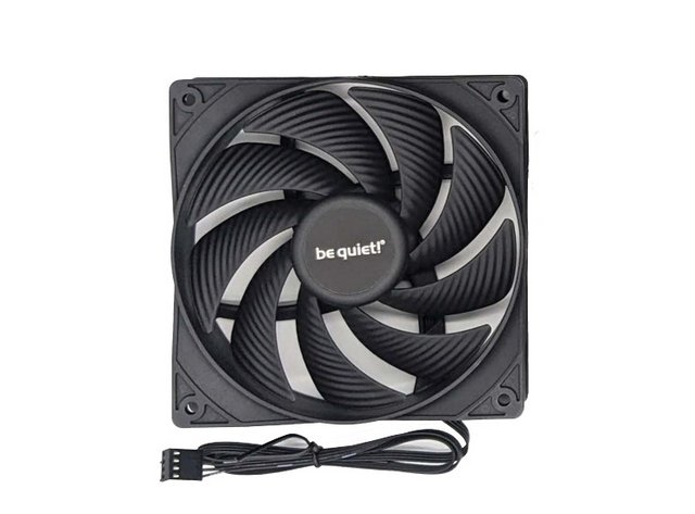

The be quiet! Pure Wings 3 looks very elegant and is extremely well made. Their unique selling point is the inclusion of the be quiet! closed loop motor control. Rather than relying upon the motherboard to actually read the fan speed, compare it to the desired speed, and then adjust it on the fly, most systems just set it to what you tell it and never actually find out how quickly the fan is or isn’t spinning. The Pure Wings 3 goes for a closed loop controller which actually does what you might expect your motherboard to do, namely see if the speed the fan is actually spinning is what it should, and adjust it constantly. Even as your fan ages and thus slows, it’ll speed things up to ensure you get the full cooling effect. It’s a genius bit of technology, particularly key on a set of fans designed for radiator use as we have here.
The sticker is as usual on the non-rotating side and contains all the important data for the system assembler like the short form BQ PUW3 and the part number 12025-HR-PWM as well as the voltage DC 12V and a maximum possible power consumption of 0.45 amps and some test seals like CE and TÜV. As for the frame, we’re dealing with something basic with a square frame. However, there are no rubberized silentblocks to reduce any parasitic vibrations generated when the mill turns. It is important to add that the high-speed variants use nine blades instead of seven, which is the number used with the slower models. Those fan blades with optimized angles make for increased air pressure.
Pure Wings 3 comes with a 4-pin PWM connector, which makes it possible to adjust the speed of the fan in the BIOS, with their PWM models, but can also be obtained as a 3-pin on their standard model. It gives the possibility to adjust the speed based on the temperature of the CPU, and they can reach a maximum of 2100 rpm, with a noise level of 30.9 dBA. Rifle bearing technology contributes to a very long lifespan of up to 80,000 hours.
The high-speed version tested here is better suited for radiator use.
