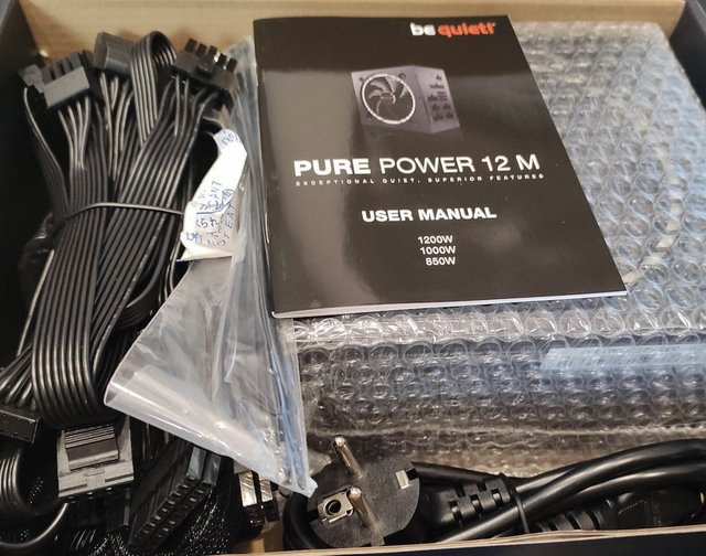

The contents are neatly organized. The be Quiet! Pure Power 12 M takes up the right side and is encased in bubble wrap. You’ll find a basic multi-language manual on top of it and a stack of all-black cables to the side.

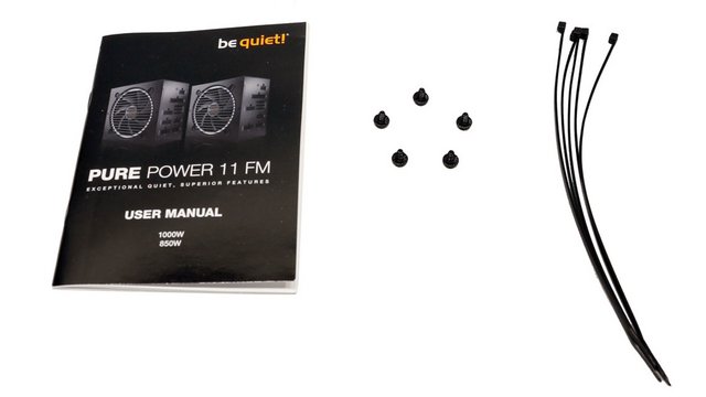

The bundle includes fixing bolts, zip ties, the user manual, and cables.

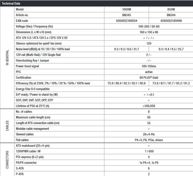

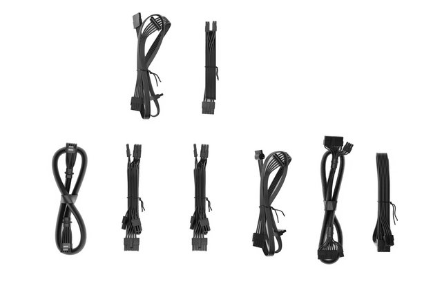

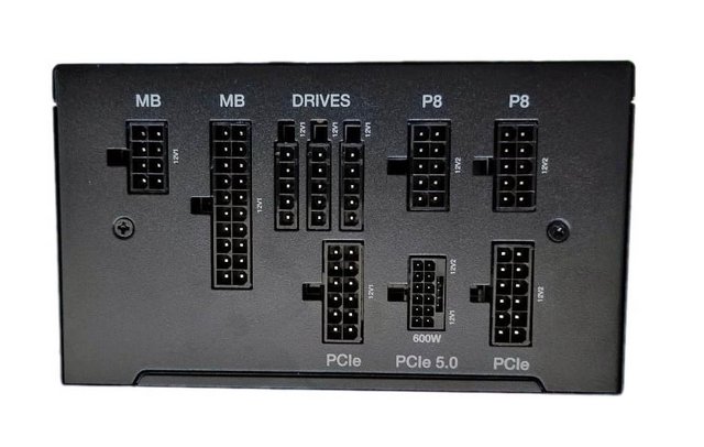

A total of eight modular power cables are included out of the box. All modular cables other than the ATX 20+4-pin cable are flat and easy to bend, making them extremely easy to work with. The ATX 20+4-pin cable is sleeved rather than flat. 16 AWG wires are found on the ATX 24-pin, ATX/EPS 4+4-pin, and PCIe 6+2 pin bundles. Everything else is 18 AWG, which is standard and to be expected.
The following modular cables are included out of the box:
- 1x ATX 20+4 pin, 55.0cm
- 1x ATX 4+4 pin, 60.0cm
- 1x EPS 8 pin, 60.0cm
- 2x PCIe 6+2 pin, 2 connectors each, 50.0cm to first connector, 15.0cm spacing thereafter
- 1x SATA/Molex/Floppy, 5 connectors, 50.0cm to first connector, 15.0cm spacing thereafter
- 1x SATA, 4 connectors, 50.0cm to first connector, 15.0cm spacing thereafter
- 1x SATA, 3 connectors, 50.0cm to first connector, 15.0cm spacing thereafter
These are specified measurements from the manufacturer. Most users should have no problems with be quiet's Pure Power 12 M - 850W in modern cases. 50cm to the first connector is the general standard, and this power supply met or exceeded this recommendation in all counts.

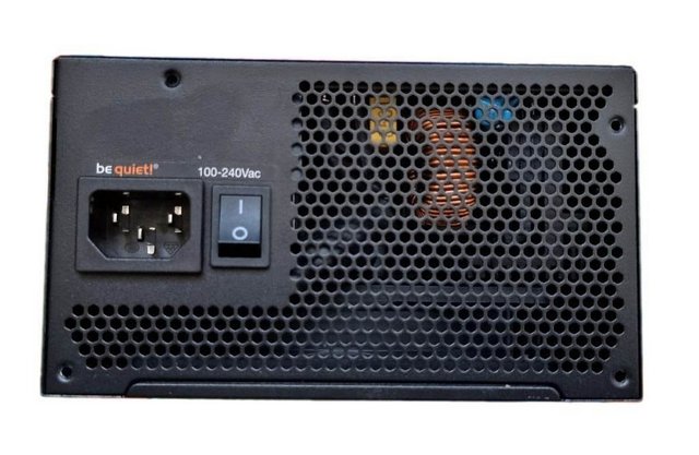

Exhaust heat is allowed to leave at the back of the power supply through the secondary honeycomb mesh opening. What you will find here is a vertically aligned male connector for power input on the western edge along with an on/off switch next to it. You will also find a sticker with be quiet!'s logo here. The low resistance honeycomb mesh design is implemented to maximize airflow and minimize air resistance. This is done as heat needs to leave the power supply as easily and efficiently as possible, because the Pure Power 12 M - 850W incorporates only one 120mm fan at the bottom. The connector could be implemented in a more efficient manner in my opinion, as the power input connector and switch took up a bit more room than average at the back. As with all active PFC power supplies, the be quiet! Pure Power 12 M - 850W has automatic full range 100V to 240V AC line voltage selection, so the user does not have to worry about manually selecting input voltage.

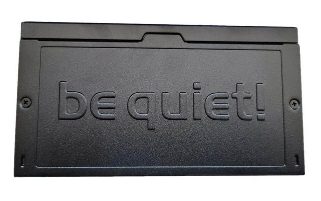

From our view below, you can see the full branding is implemented on one side, where you can spot be quiet's logo prominently embossed.

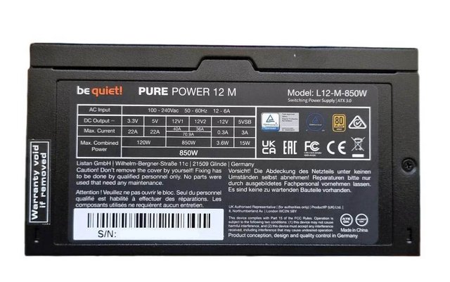

The other side is the specifications label. To make sure you will always see the text right side up, the orientation of it is different on both sides, so whatever side facing the user after installation will always be correct.

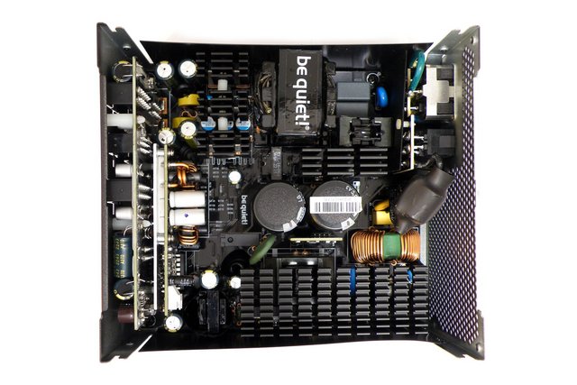

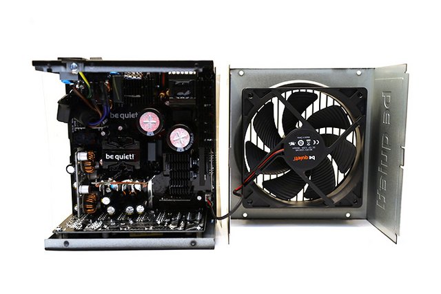

As always, we opened up our be quiet! Pure Power 12 M - 850W power supply to take a detailed look at what is going on inside. Please note that doing this at home may void your 10-year warranty thanks to a seal that extends over one edge of the power supply. But for the benefit of you, we cracked ours open so you do not need to, haha. There are no user serviceable parts inside. Disassembling the be quiet! Pure Power 12 M - 850W is quite straightforward with the removal of four screws next to the fan mount. We see a 120mm fan that provides cooling to the be quiet! Pure Power 12 M - 850W's internal components. It is connected to an add-in board using a 2-pin connector. A 120mm fan is rather small nowadays for a power supply with a bottom mounted fan, but if not a lot of heat is being generated, it should not be much of an issue. The fan is a be quiet! BQ QF2-12025-HS, as shown in our photo above. The BQ QF2-12025-HS is a rifle bearing fan specified at 0.30A for a maximum of speed of 2000 RPM. Fans with rifle bearings are quiet and have much longer lifespans compared to sleeve bearing fans and is quite suitable for this application.

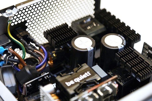

Our photo above shows an overhead view of its internal components. Its OEM is HEC, a reputable OEM. At first glance, the build quality appears to be excellent. There are three main heatsinks inside. Despite the large heatsinks, there is ample space between parts for better airflow. There are no surprises internally. Heatsinks are attached well and soldering is decent.

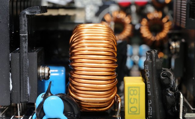

The transient filter starts on the AC receptacle and continues on the main PCB.

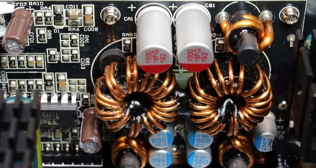

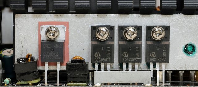

The APFC converter uses three Infineon FETs and a CREE boost diode.

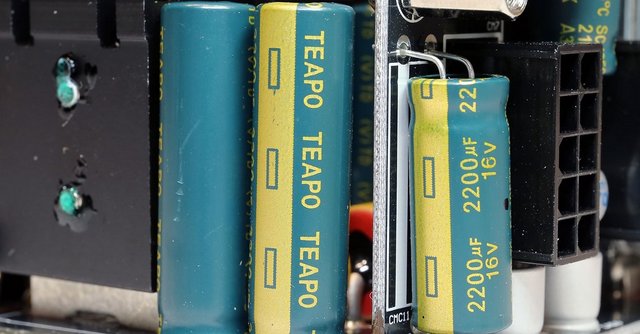

On the primary side, we can see two Taiwanese-made Teapo capacitors. Japanese-made capacitors are not specified on the marketing material, and as you will see, you will not find any Japanese-made capacitors in this power supply. Our version of be quiet's Pure Power 12 M - 850W series power supply incorporates two 400 V / 470 µF , 105c-rated capacitors in parallel. That said, the Pure Power 12 M - 850W is priced competitively for a fully modular 80 Plus Gold unit, so the money savings have to come from somewhere, haha.
The APFC controller is a Champion CM6500UNX, supported by a CM03AX IC.

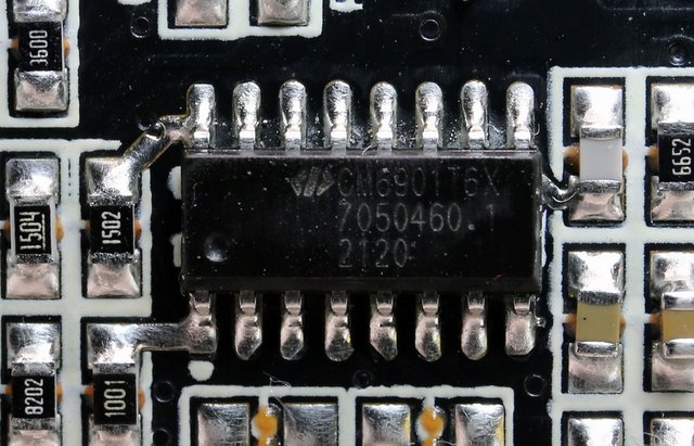

The resonant controller is a Champion CM6901T6X.

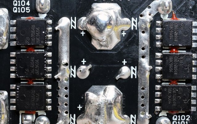

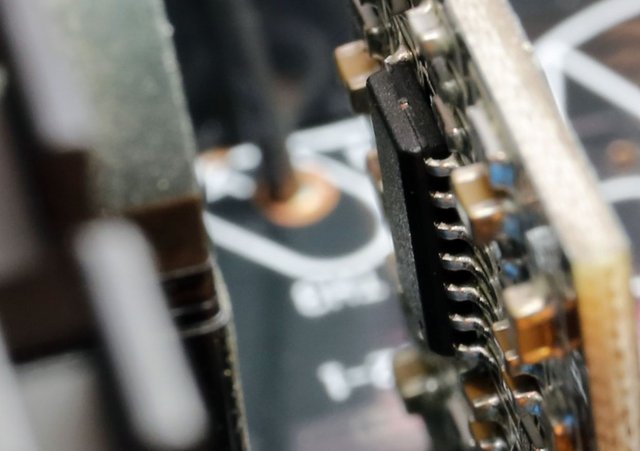

Six Hunteck FETs regulate the +12 V rail. They are installed on the solder side of the main PCB.

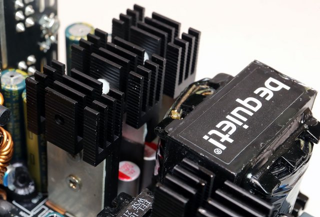

Three heatsinks above these keep operating temperatures under control.
Teapo electrolytic filtering caps.

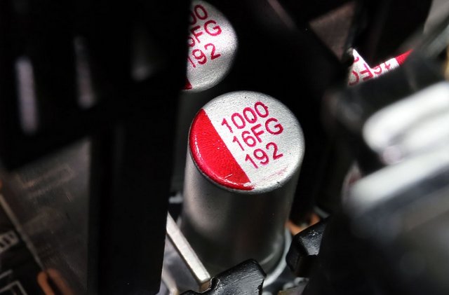

Many polymer caps are also used.
Two DC-DC converters generate the minor rails.

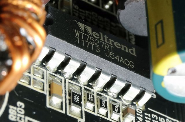

The supervisor controller is a Weltrend WT7527RT.

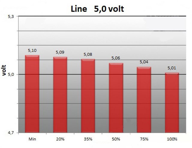

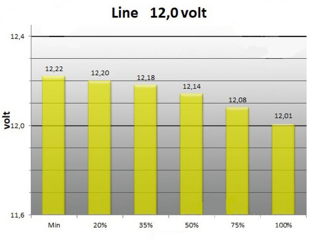

Voltage Regulation
Voltage regulation tests are performed by connecting all power lines to our PowerKiller simulating the behavior of the power supply with loads comparable to those of a real location.

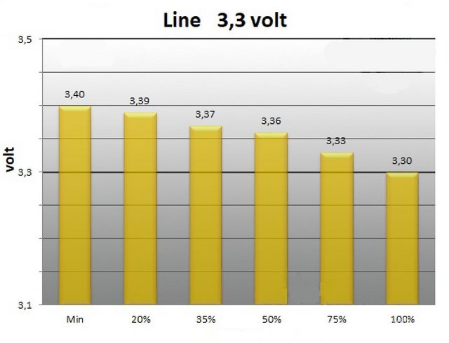

Line +3,3V
Average voltage 3,358 volt
Deviation from the ideal value (3,33 volt) = +0,85%
Line +5V
Average voltage 5,063 volt
Deviation from the ideal value (5,0 volt) = +1,26%
Line +12V
Average voltage 12,138 volt
Deviation from the ideal value (12,0 volt) = +1,15%
Given the excellent premises of the first test, we were sure of finding new confirmations with the linear load test. The average tension remains slightly higher than the reference one on all three lines, both for the excellent stability and for skilfully increased starting values. It therefore appears clear that all powered peripherals will receive adequate voltage over the entire range of use.

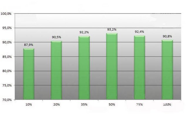

Efficiency
The efficiency demonstrated by be Quiet! Pure Power 12 M - 850W during our tests confirms the 80plus Gold certification by an appreciable margin.

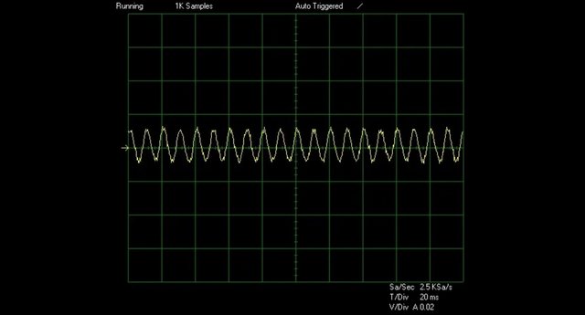

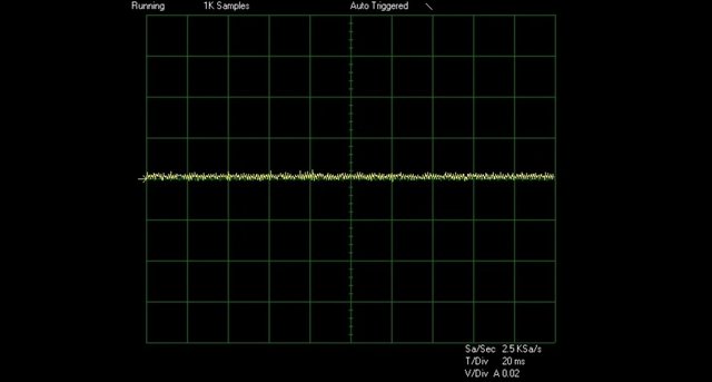

Ripple
If you were thinking the ripple results were going to be the Achilles heel of the be Quiet! Pure Power 12 M - 850W, then you’re set to be (pleasantly I hope) surprised. On the whole, the results are surprisingly low and particularly so in both the 3.3V and 5V channels with the highest score recorded, from both of them, only being 5.8. And just to put this into context, the maximum allowed under EU standards is 50. Admittedly, the 12V rail is a little more excitable, but still hugely within acceptable limits. – On the whole, while it might not be listed among the be Quiet! Pure Power 12 M - 850W’s key features, a low ripple noise is definitely present here!

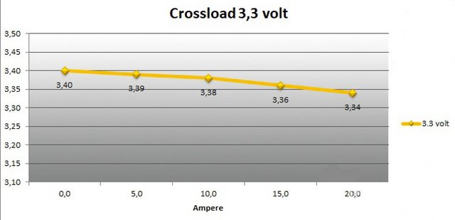

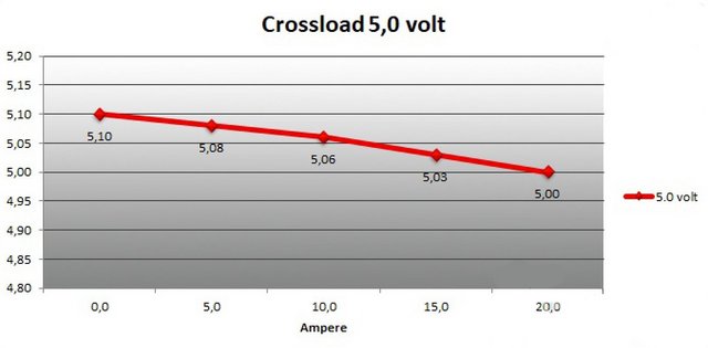

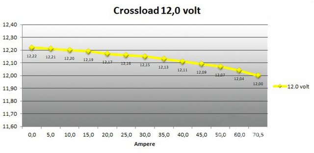

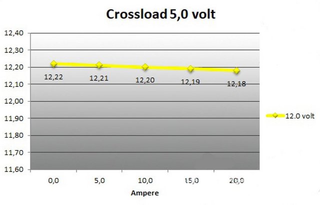

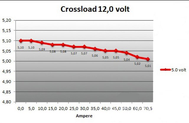

Cross Load

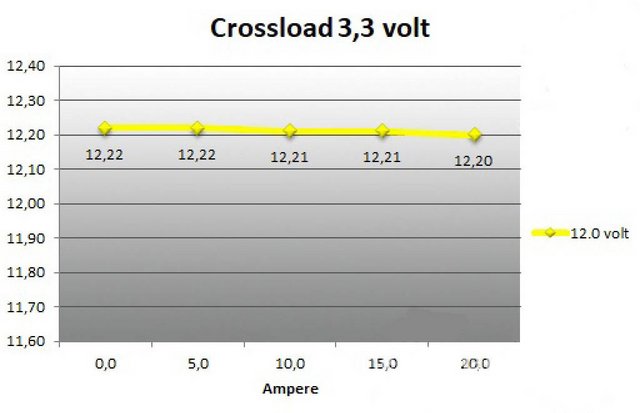

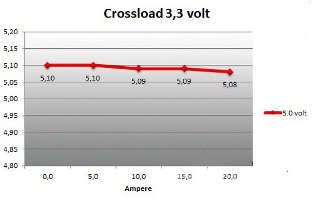

Line +3,3V
Maximum Vdrop 0,06 volt (1,76%)
Line +5V
Maximum Vdrop 0,10 volt (1,96%)
Line +12V
Maximum Vdrop 0,22 volt (1,80%)
The Cross Load is archived by the Pure Power 12 M - 850W with excellent results: the Vdrop remains contained within 2% on all lines of interest.

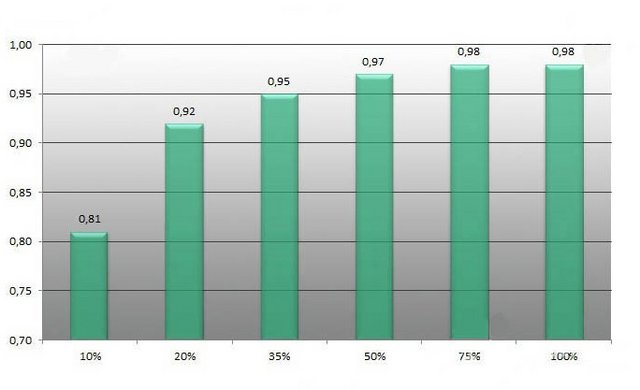

APFC
The power factor control system behaves appropriately for the product range, the progression is excellent and the power supply reaches the almost absence of phase shift between voltage and current already at 75%. We have observed better behaviors in the recent period, but the differences are so small as to be largely negligible, which is why we can only be satisfied with the electrical performance ensured by this power supply.
