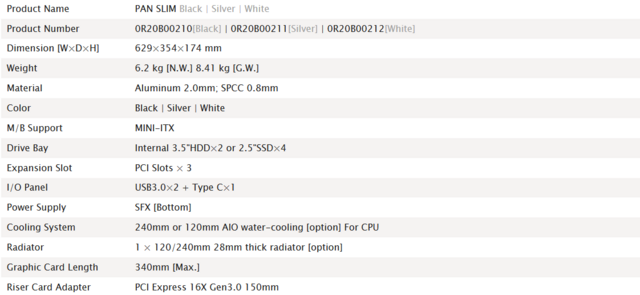

    Other detailed specifications.

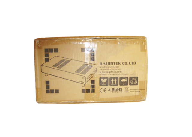

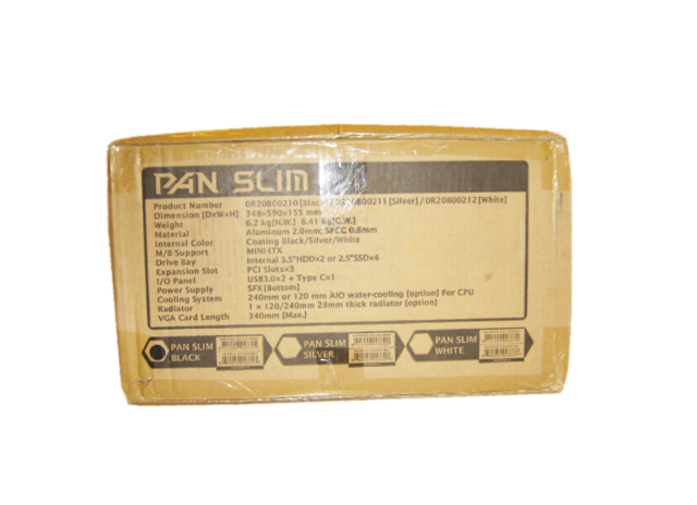

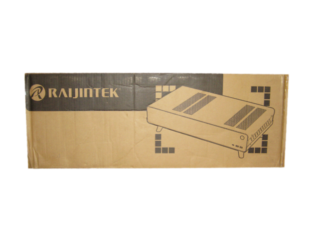

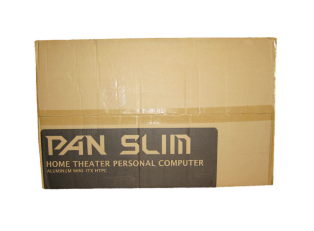

    The packaging for the PAN SLIM is simple and to the point.
    It comes in a brown box with black print and the front has a drawing of the case alongside its model name.
    Turning the box around, there are four more images.
    Raijintek placed it's branding on the right side.
    Raijintek placed the specifications of the enclosure on the right side. The color variant of the case can be seen underneath. We are reviewing the black variant.

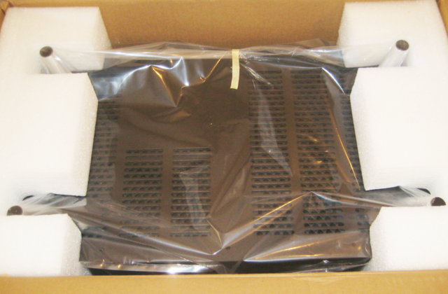

    Inside of the box, you have the case wrapped up in plastic and then two foam panels that hold the case up away from all of the edges and absorb some shock from when the box gets tossed around.

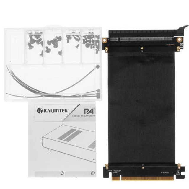

    Also inside you do get an instruction manual which has a picture and count for all of the screws right on the front. Then you get a bag filled with the case screws, rubber hard drive mounts, and zip ties. This is a small case and they give you a good amount of zip ties to get your wiring in order. You also get a flexible PCIex16 riser.

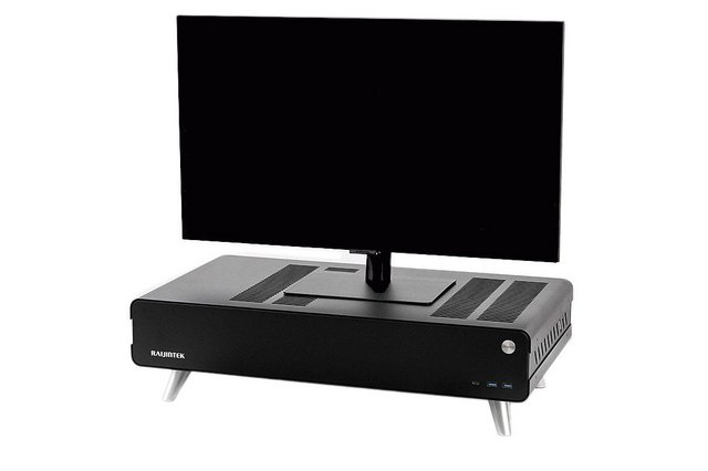

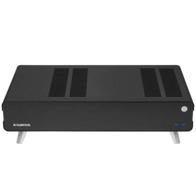

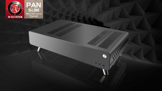

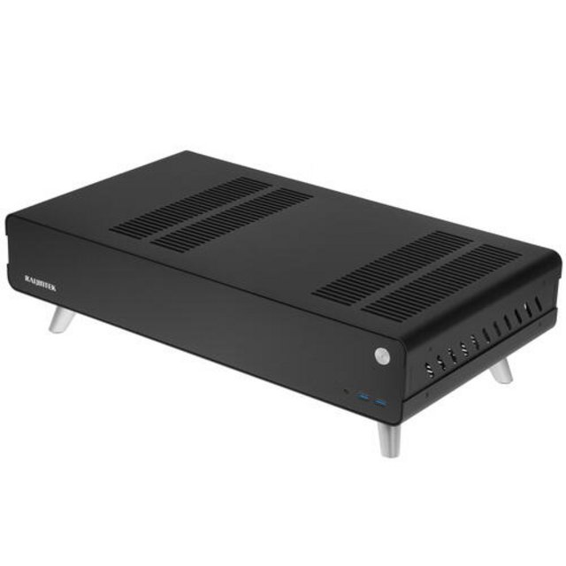

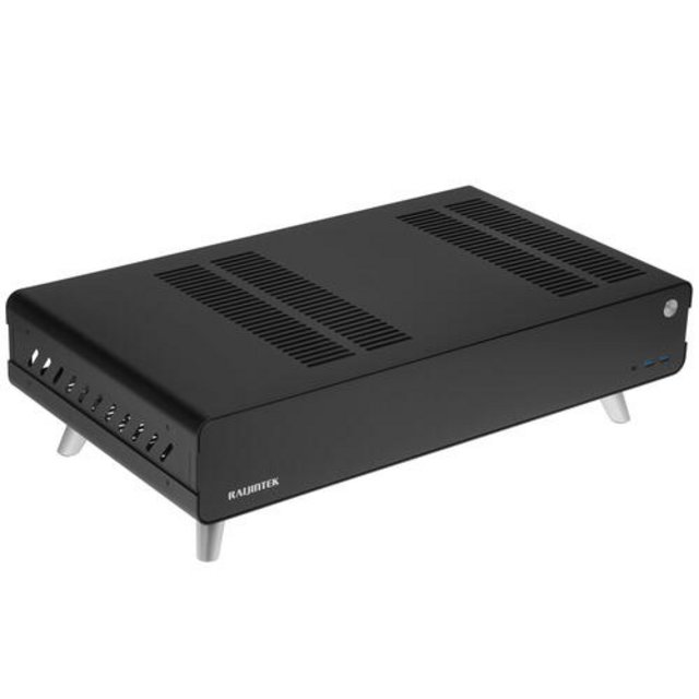

    Pan Slim features a very minimalist outward appearance. If there is any case I would identify for home theater use, it would definitely be the Pan Slim. Unlike many of the other chassis we have seen here targeting the gaming or standard computer user, this one looks much more like a video cassette player or an audio receiver with the full black front. In terms of sizing, Raijintek's Pan Slim measures in at 590mm in width, 348mm in height, and 155mm in depthbweighing in at 8.2kg with its steel and aluminium construction.
    Material choices are pretty good, as everything feels pretty sturdy, though you will see some of the internal reinforcements later on. In order not to spoil the design of the aluminum case, the externally exposed screws have been reduced as much as possible. There are 2 screws each for the left and right sides to fix the side frame and the upper and lower frames, and there are a total of 10 screws for fixing the lower frame. Above all, it has a unique shape with long left and right sides and low top and bottom, so you can see the concept different from the existing ITX case at a glance.

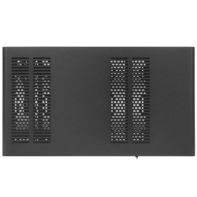

    Pan Slim has air holes all over the chassis, from the top, bottom, side, and back. On the top of the case the right openings allow for air to pass through the VGA card. The left ventilation area is located right above the AIO cooler's place.
    The front of the Pan Slim is where you can really see the Raijintek styling. If you look at it from the front, it has a luxurious monitor stand, similar to the Xbox.

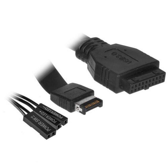

    Τhe height of the stand is 64 mm, which is higher than the existing cases. There is enough space to slide the keyboard in like a monitor stand, and it is designed to allow smooth airflow through perforations in several parts of the chassis. It has a large round power button with led on it to the front right top and beneath that there are 2 USB 3.0 (USB 3.2 Gen 1) and 1 USB 3.0 (USB 3.2 Gen 1) Type C ports. I was really happy to see the Type-C connection, not enough cases are including them. The Raijintek logo etched into it in the bottom left corner. Unfortunately there isn't any audio port in the front.

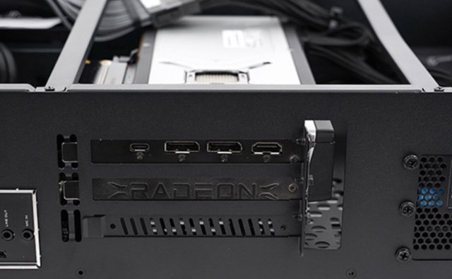

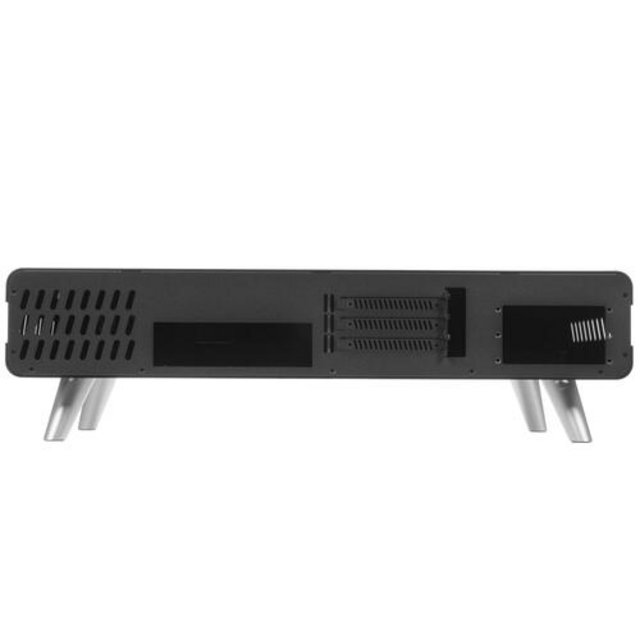

    The back side of the case looks nearly the same as the front/left side. This also gives a better angle to see the small wings on the back of the case on each side where the aluminum panels stick out. You can also see that those panels have a brushed finished and are anodized black and then the outside edge has been re-machined for a little bling. The motherboard rear I/O hole is on the left. There is a dedicated hole for the graphics card right next to it, and three PCI slots are designed to accommodate flagship graphics cards. On the far right is the SFX power supply place.

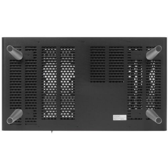

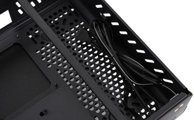

    The last area to take a look at is the bottom of the Pan Slim. There are plenty of vents across the entire span of the chassis.

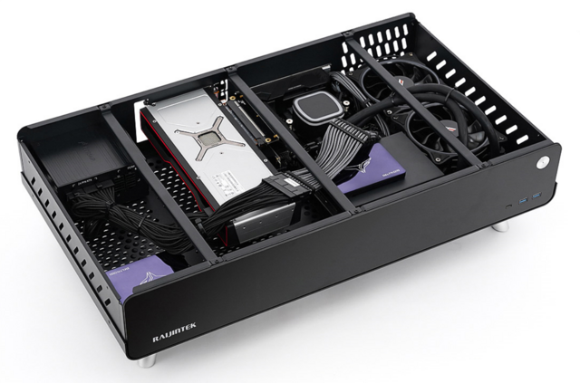

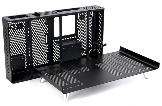

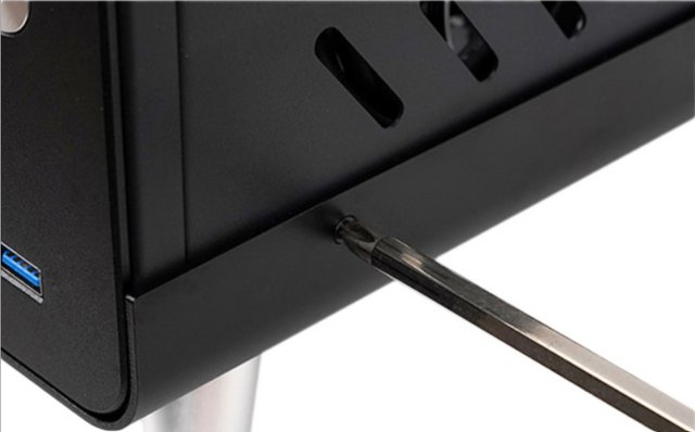

    Detaching the frame is simple. It can be easily removed by removing the 4 side fixing screws and 10 bottom fixing screws. The upper frame is fixed with 4 side screws.
    When you open the top frame, you can see that there are a total of 3 frames fixed inside to increase the internal strength of the chassis. It can be divided into four main sections.
    All the cables within the Raijintek Pan Slim are black.

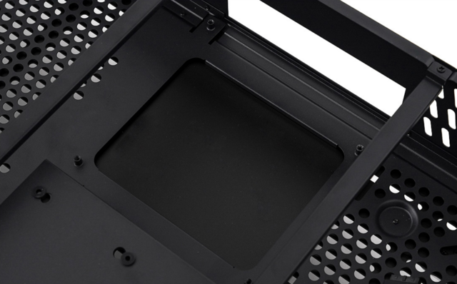

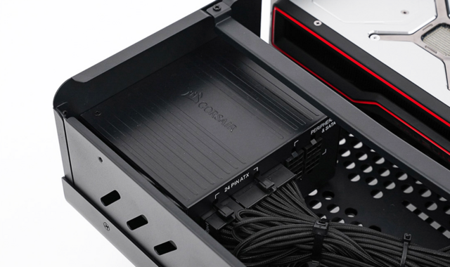

    On the far left is the place for power supply unit. The Raijintek Pan Slim can fit an SFX / SFX-L power supply. In front of this area a dedicated SSD caddy is configured.
    In the middle, there is an area where a mini ITX sized board will go.

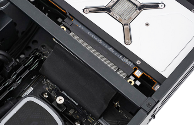

    As this case is intended for mini ITX motherboards, the riser is already pre-installed to the case.

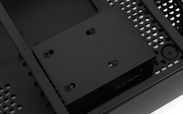

    In addition, there is an HDD cage, which offers enough space for a 2.5-inch drive and two 3.5-inch HDDs.

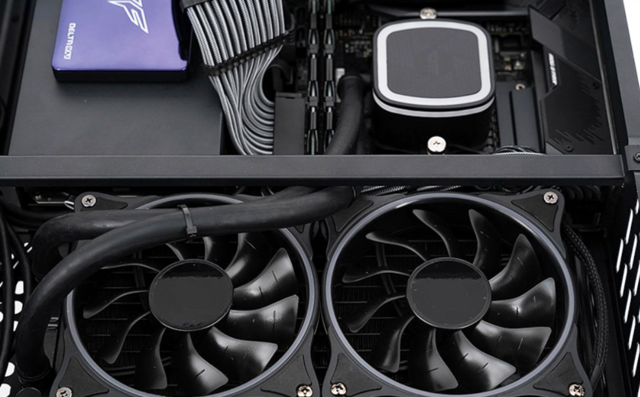

    Two 120 mm cooling fans or an 120/240mm integrated water cooler can also be installed through the space on the right. Fans here, which will help with airflow in such a small case. I think it would have been nice to see Raijintek include these two fans. It also would have been nice to see some mesh here to prevent dust from getting into the sides.

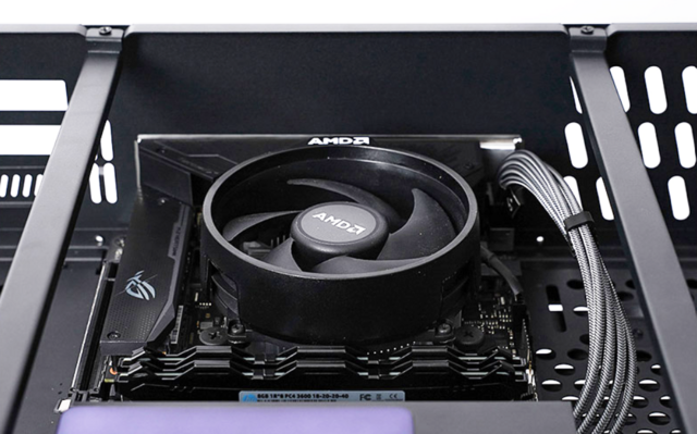

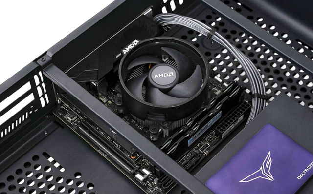

    If there is anything I learned about computer and building, it is just the fact the smaller you go, the more challenging the project becomes. This is only natural, as working with smaller components becomes quite a bit harder as we move into tighter environments. The first step I did was to install an ITX motherboard into this enclosure. The case height is about 110 mm, so it is not possible to install a tower type cooler. However, it is possible to install the bundled cooler or flower type cooler provided when purchasing the CPU.
    The Wraith Stealth cooler provided by the Ryzen 5 5600X was able to confirm that it was possible without difficulty.

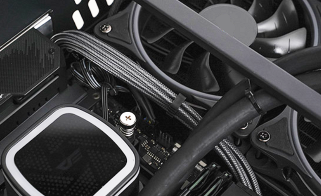

    Next to the PCB on the right side, two 120 mm fans or a 120/240 mm radiator can be mounted.
    The official manual informs that it can be installed up to a thickness of 28 mm radiators.

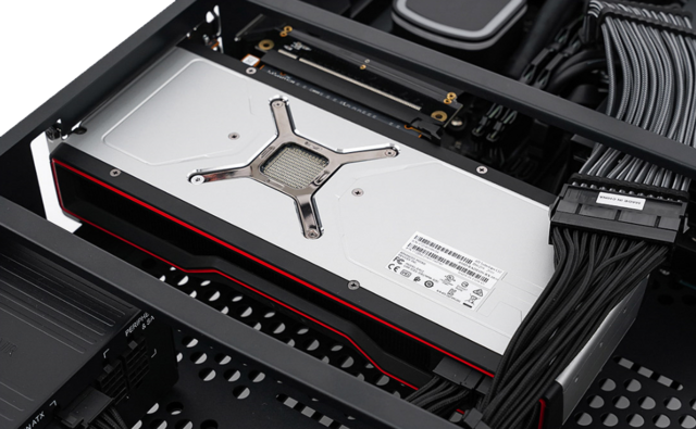

    The graphics card itself is placed to the left of the motherboard. A riser cable is also provided as standard for easy graphic card connection in a narrow space.
    It was also possible to install a Radeon RX 6800 graphics card without difficulty.

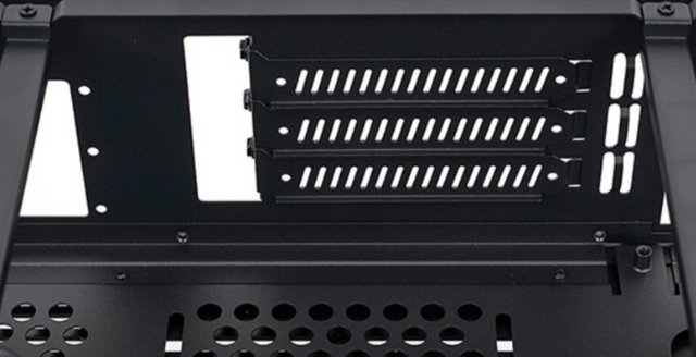

    The graphics card can be equipped with high-end models up to 340 mm. Everything in the rear is also where you would expect it to be, readily accessible as it is all flush with the exterior.

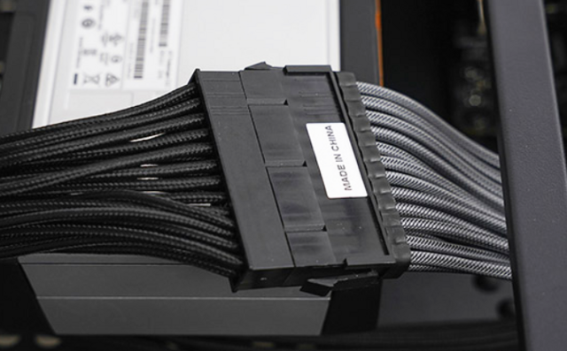

    My next step in installation was to put the SFX power supply into this case. Although only the SFX standard is indicated in the product manual, I was able to check the free space where SFX-L power can be installed. Although it is an ITX case, it is designed with a long frame on the left and right, so there is ample space. Only SFX and SFX-L standards can be installed in the power supply part.bnI would recommend using a modular power supply if you can help it, as the extra cable bundle clutters up the internal area.

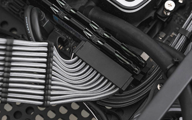

    Commercially available SFX / SFX-L power is typically used for small mini PCs, so most of them have shorter cable lengths than standard ATX power. For this reason, you will need an extension cable with some SFX / SFX-L power units. After plugging all the cables in, I routed the extra cables away from the motherboard to allow as much air to travel through the case.

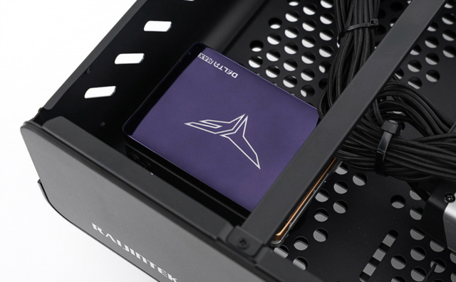

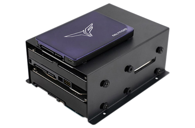

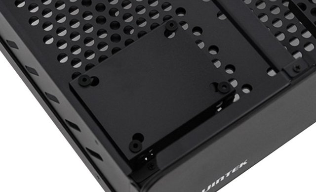

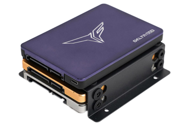

    On the other side, there is space for two important things. One is the 2.5" drive caddy, which can hold up to three drives and another caddy which can hold 2 x 3.5" (HDD) and 1 x 2.5" (SSD). However, this caddy can also be removed if you do not need to mount this much storage in this area.
    Storage options here are mounted with screws.

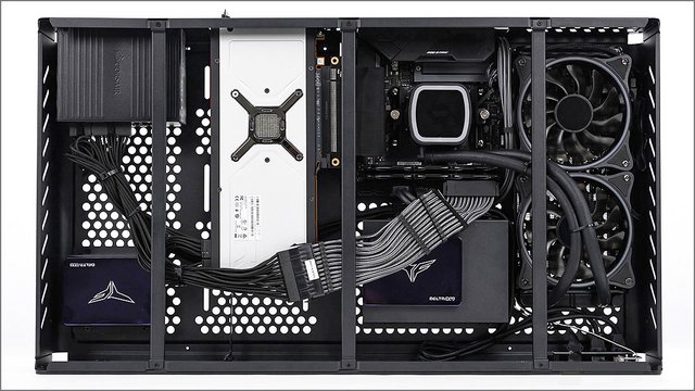

    From here, you can see the finished look of the machine.
    Overall, the installation was a pretty easy installation, and a lot of the space limitations are understandable as the intention is to fit everything into a small area. I still would have liked to see some fans included on the side of the case, as I definitely had the space for them, and they would have calmed any fears I had about keeping the system cool.
