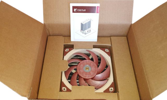

    Noctua didn't put much work into the package here. You can tell they haven't wasted any money at all on the packaging and frankly I think this is a good thing. The front of the box tells you the crucial thing you need to know, what the product is.Other than that the box is entirely blank, Noctua make an assumption that most people will be ordering this online and/or will know what it is before they buy it so therefore lavishly decorated packaging is just a bit gimmicky and not needed.
    Everything was packaged quite carefully and well protected. Open the main box and immediately you will see that the hardware accessories are packaged individually in a separate box. The cooler itself is packaged with the fan/s pre-installed.

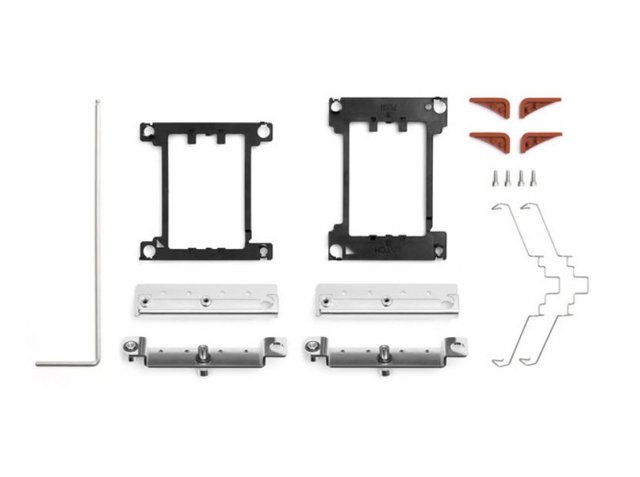

    The accessories are clearly labeled with images depicting exactly what is inside. The heatsink's SecuFirm2 mounting system includes two sets of brackets in order to support both square and narrow-type LGA3647 sockets.

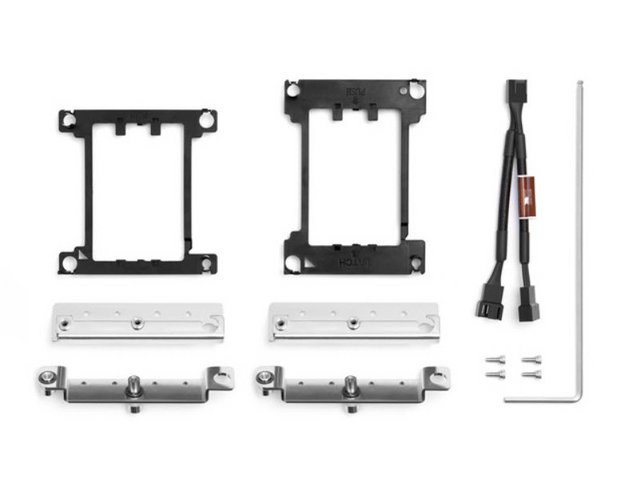

    NH-D9 DX-3647 4U:
    Y-split cable

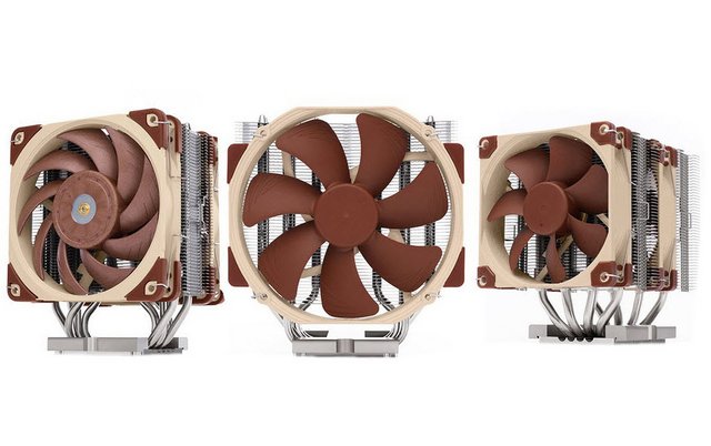

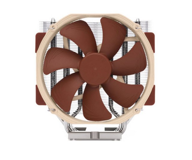

    The Noctua NH-U14S DX-3647 is a traditional single-tower-style heatsink. The heatpipes and base are out of nickel-plated copper while the fins are out of aluminum.

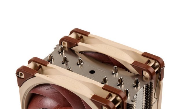

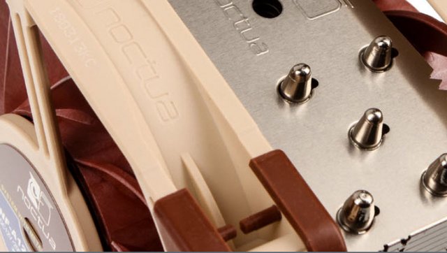

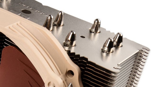

    The top view of the tower shows the termination points for the six nickel-plated copper heat pipes. Noctua's logo and name are embossed in each of the fins. This adds a nice visual touch, especially if you have a side window on your case.

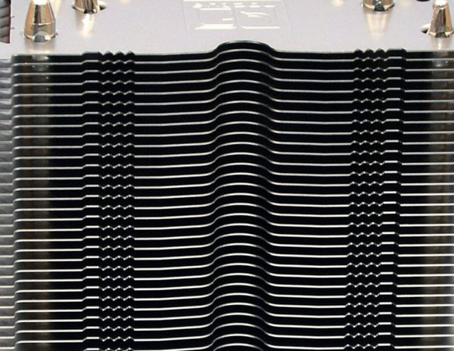

    The fins in the array are slightly tapered inwards toward the center.

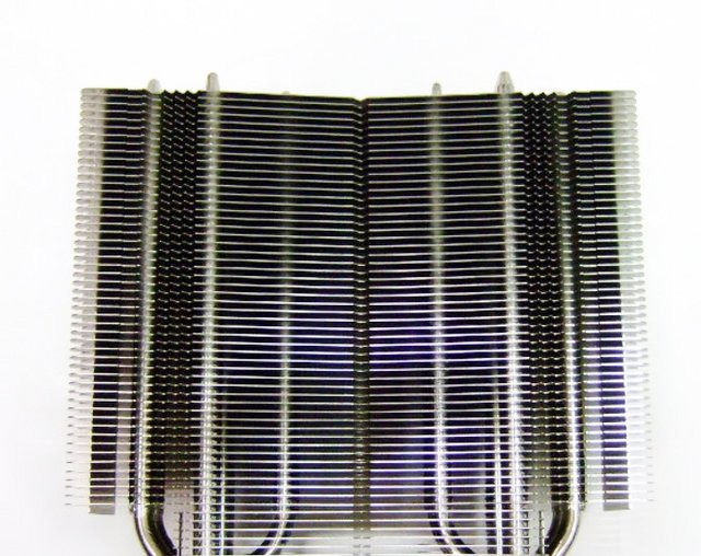

    Each of the six U-shaped, nickel-plated copper heat pipes pass through the aluminum fin array to deliver the best possible cooling performance. The heatpipes are connected to the fins well, with no visible gaps to be found. Some coolers have the heat pipes all in alignment with each other, but the heat pipes of the NH-U14S DX-3647 are staggered to maximize their exposure to the airflow. I've noticed that this staggered design method seems to yield the best cooling results.
    Here again I need to mention that a second fan can be installed easily, so if you like to go for a push-pull configuration and perhaps shave off another few degrees of your CPU core temperature.
    The heatpipes are positioned in eclipse type alignment rather than in a straight line, this is more noticeable when observing the heatsink from an aerial point of view.

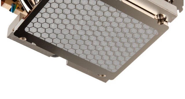

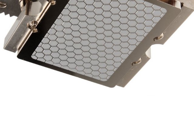

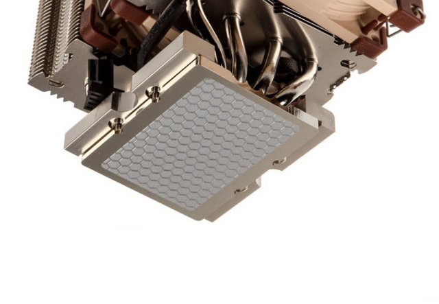

    The nickel plated copper base is smooth with very fine machining marks that I have seen on each of the Noctua heat sinks I have looked at. So far this surface has not been an issue as far as cooling performance is concerned. At 70x56mm, the copper contact surface of the new DX coolers is more than double the size of the standard models. All three DX-3647 coolers come with NT-H1 thermal compound pre-applied, which ensures optimal bond-line thickness and saves precious time during installation.

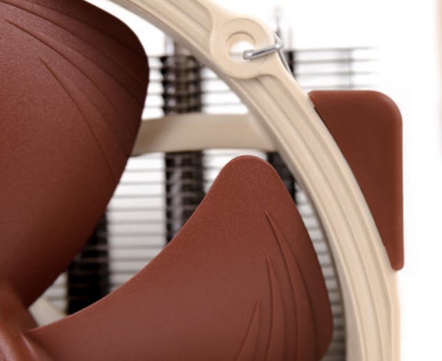

    A Noctua cooler simply doesn't feel right without one of their beige and dark brown fans that look, well, unique would be a nice way to describe these. The NF-A15 PWM fan they used on this cooler spins at a maximum 1500 RPM. Integrated anti-vibration pads made from extra-soft silicone minimise the transmission of minute vibrations.
    As can be seen, Noctua utilized flow acceleration channels to improve overall performance while keeping noise to a minimum. Noctua's Stepped Inlet Design adds turbulence to the influx in order to facilitate the transition from laminar flow to turbulent flow, which reduces tonal intake noise, improves flow attachment and increases suction capacity, especially in space-restricted environments. With the tips of the fan blades ploughing through the boundary layer created by the Inner Surface Microstructures, flow separation from the suction side of the blades is significantly suppressed, which results in reduced blade passing noise and improved airflow and pressure efficiency. The NF-A15 features the further optimised second generation of Noctua's renowned, time-tested SSO bearing. With SSO2, the rear magnet is placed closer to the axis to provide even better stabilization, precision and durability. In order to guarantee the highest possible degree of manufacturing precision, minimum tolerance and excellent long-term stability, the NF-A15 PWM sports a CNC milled bearing shell made entirely from brass.
    The Noctua NH-U12S DX-3647 is a tower-style heat sink. The NH-U12S DX-3647 is symmetrical with grooves for fan clips on both sides.

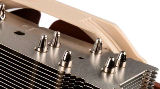

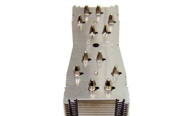

    The top view of the tower shows the termination points for the five nickel-plated copper heat pipes. Noctua's logo and name are embossed in each of the fins and adds a nice touch if you have a case window.
    The heatsink fins utilize aluminum as its material due to its lightweight properties as juxtaposed to copper -- this is to allow the construction of larger heatsink's without stressing too much on the motherboard due to weight. The sides of the aluminum fins are folded flat to create better channels for airflow across the entire fin achieve better cooling performance and a more even airflow. Noctua's NH-U12S DX-3647 takes a hybrid approach in the heatsink fin leading edges compared to their previous designs. It still retains a low angle V-shaped slope towards the center,but includes bits of zigzag edges first seen in the NH-D14. By doing this, the company attempts to maximize its ability to permit airflow between the fins with minimal resistance and turbulence noise -- all with a negligible decrease in heatsink surface area. There are fifty aluminum plates on the radiator. The spacing is fairly tight. From my calculations, the total surface area of all the cooling fins combined is actually approximately 0.54 square meters, which is expected for a heatsink of this size.
    The heatpipes themselves are made from nickel-plated copper and feature a staggered arrangement to maximize the dissipation of heat throughout the fins. There are pre-installed mounting screws and included processor clips (square type and narrow type without Omni-Path fabric connector, with fabric connector on request), which make it easy to install. The CPU block is also made from nickel-plated copper and features a textured design to help improve surface area. If you look closely, you can see some of the wavy machining marks in the mounting surface.

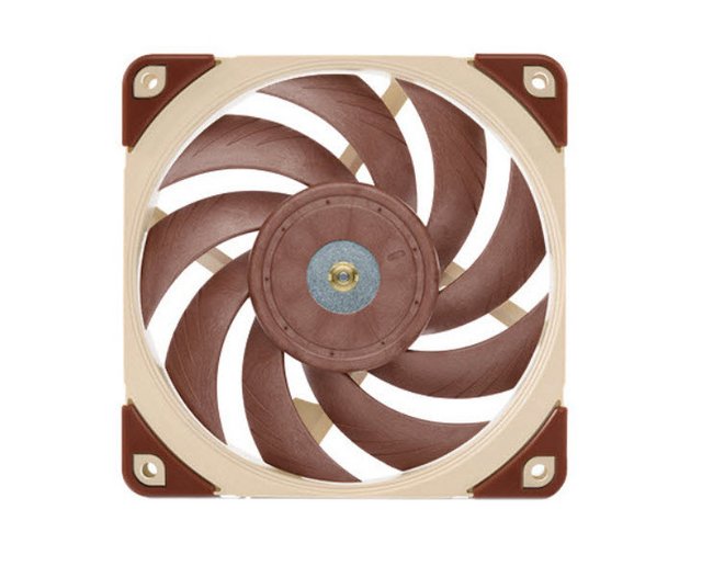

    Thanks to its large surface area, the NH-U12S DX-3647 use dual fan configurations with two NF-A12x25 fans. It certainly wouldn't be a Noctua cooler without their unique fan color. I may not be a fan of it, but I always know a Noctua product when I see it just like everyone else. That fan color is simply unmistakable. Noctua chose a PWM fan for the NH-U12S DX-3647. The included NF-A12x25 fans could be considered Noctua's secret weapon- just try finding SS02 bearings, AAO frames and Sterrox. Wait, Sterrox-what? It looks like a normal nine-bladed fan to me, why all the fancy words? In short, Noctua uses fancy words because there's some serious aerodynamic engineering behind the fan. It's worth it to take a moment and explain some of the features, because you'll quickly realize why Noctua has garnered such a reputation for their fans. First, the SSO2 bearing. SSO stands for self-stabilizing oil-pressure bearing. This bearing type combines an oil-based bearing that is stabilized by an additional magnet placed closer to the axis of the rotor. Not relying solely on the CNC milled brass bearing shell for stabilizing something that revolves 1,200 times per minute probably helps Noctua achieve a 150,000 hour MTBF for the fan, and that gets backed by a six year warranty, one of the longest I've seen in a rapidly evolving market like enthusiast hardware.
    AAO stands for Advanced Acoustic Optimization, and describes the features Noctua added to the frame to reduce vibration and increase efficiency with respect to noise. To do this, they've integrated (silicone, I'm assuming) anti-vibration pads on all corners (the NH-U12S DX-3647 comes with an additional, thicker set of pads that can be swapped out on a second fan in a pull configuration) and a series of steps or ridges along the intake rim to rough up the incoming airflow (the smooth intake flow of air will get mixed up anyway by the blade. Doing so a bit beforehand will reduce noise when that occurs). This Stepped Inlet Design has the side effect of increasing performance respective to a smooth curve when placed against an intake filter or other restriction. Noctua doesn't stop there with their acoustic optimization though, as the inner surface of the frame is filled with microstructures (It helps reduce the noise of the blades as they pass by while improving airflow. I'm assuming the effect might be similar to the use of dimples on a golf ball). The NF-A12x25 PWM doesn't stop there with the engineering. The NF-A12x25 has a record tight tip clearance (distance between the blade tips and the inside of the frame) of only 0.5mm. This highly ambitious design sets a new benchmark for 120mm fans and helps the NF-A12x25 to work more efficiently against back pressure, such as on heatsinks or radiators, by reducing leak flows through the gap between impeller and frame. The centrepiece of the NF-A12x25's motor hub is made entirely from steel and the axle mount is reinforced with an additional brass structure. In combination, both measures ensure ultimate precision and increased stability in the critical hub area. The NF-A12x25's impeller is made from Noctua's novel Sterrox liquid-crystal polymer (LCP) compound that features extreme tensile strength, an exceptionally low thermal expansion coefficient and damping characteristics that are ideal for reducing resonance and vibration phenomena in advanced fan-blade designs. Supporting fully automatic PWM speed control, the fan uses Noctua's custom-designed NE-FD1 PWM IC that integrates Smooth Commutation Drive (SCD) technology. By providing smoother torque impulses, SCD suppresses PWM switching noises and thus makes the fan quieter at low speeds. The latest version of Noctua's advanced Smooth Commutation Drive system ensures superb running smoothness by eliminating torque variations and switching noises. This makes the fan remarkably quiet even at very close distances. If you want to read even more about some of the technologies that go into Noctua's products, they have some extensive information available on their website along with some helpful diagrams that help explain some of their trademarked features. It features rotational speeds ranging from 450 to 2000 RPM.
    First impressions of the NH-D9 DX-3647 4U are very positive, it looks great and has a look and feel of great quality about it that is rare for a cooler of this size. It may be quite small, but overall it feels pretty heavy, no doubt due to those thick and plentiful heat pipes. The fans comes pre-installed, although it will need to be removed to fit the cooler to your motherboard. It's just put here to reduce the packaging size. It may be tiny, but the cooler uses a dual-tower design, with the sides of each tower partially closed to help better direct airflow through the fins, rather than losing it through the edges. As for looks, Noctua has continued the trend of mixing tan, burgundy, and silver. The heatsink is completely silver, because of the material choices of aluminum and nickel plating around the entire unit. The fans are the tan and burgundy colors, which might clash with the gamer-centric flashy blue, or fire engine red, but it stands out for its non-conventional colors. Since Noctua has been doing it this way for so long, it at least gets brand recognition from any knowledgeable user.

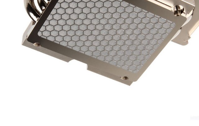

    The copper base plate and the heat pipes come with a gorgeous nickel playing and the CPU contact plate is polished to a mirror shine. At 70x56mm, the copper contact surface of the new DX-3647 coolers is more than double the size of the standard models. Tailored to fit the enormous integrated heat-spreaders of Intel's Xeon-based processors, this customised design allows for an optimal heat flow from the CPU over the base to the heatpipes and on to the cooling fins.
