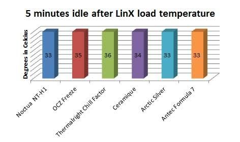

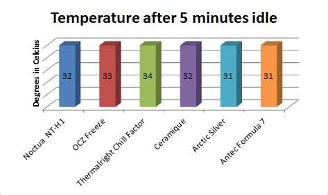

    here are some of my tests...
    i think thermal paste always works different from chip to chip (TDP) and from cooler to cooler...
    ...some coolers works a little bit better with this paste and another with that paste.
    Also TDP and the temperature of the chip is important and for some paste even running time (burn in).
    But one is for sure: here are now 3 different tests/reviews up and in all is Antec Formula 7 best paste

    Every Paste was tested with LinX. 10 minutes for little burn in - then restart and the 10min measured run. After that changed paste and cleaned cooler and cpu...
    Antec Formula 7:
    Artic Cooling MX-2:
    OCZ Freeze:
    Thermalright Chill Factor:
    Xigmatek Soft Pak:
    ...the difference between the top 3 is not that big but the Antec Formula 7 is the best paste and really stable (no temperature jumping and need no time for burn in) :
    I will do more testing next week (i will try to get some other thermal paste and do some longer tests). With Gulftown and higher TDP the results should be a bit different. I think the temperature difference between the paste's will get bigger....
    Some sub zero results will also follow soon...
    Thanks to Antec for sending me that nice thermal paste
