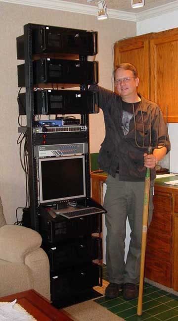

    So, I'm a professional staff electrical engineer for Motorola Inc, designing public safety communication systems. Now what? I build a rack of machines of course!!!
    Here it is, as well as me, after cleaning out the hamster cages....
    Anyone familiar with sharp farm implements will notice that I'm holding a manure fork, not a straw/hay pitchfork. Anyone doubting this can look here I have the number 74223 fork....Didn't know they still made it....Good to know that cr*p hasn't changed much over the years....Those hamsters are quite the producers of manure, particularly with the special DDT chow....
