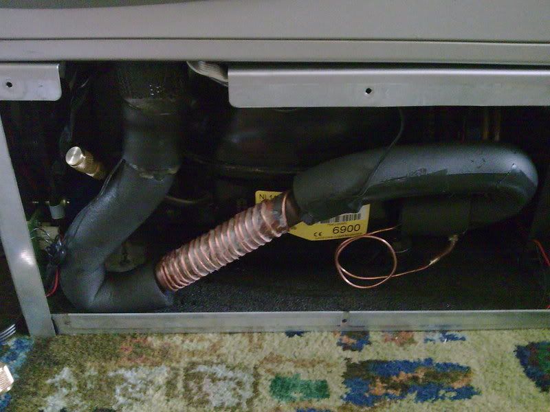

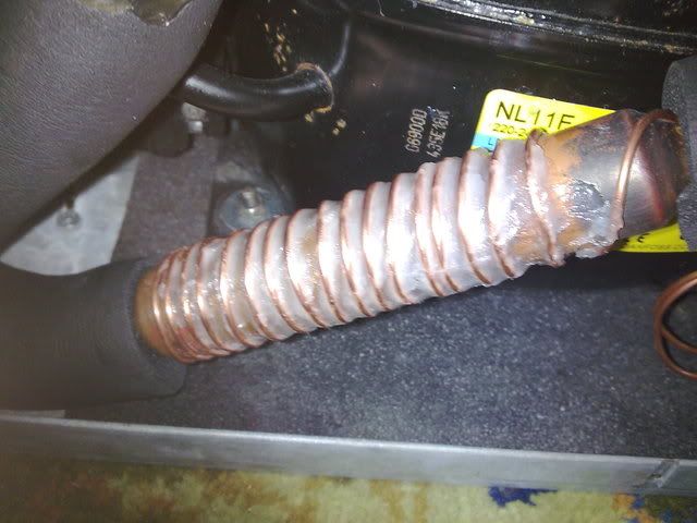

    desuperheat coil and condencer this is the only pic i got lol also add rubber tap washers to the compressor mounts and the condencer for vibration dampaning

    Looks very good and very well done, but one question, are you soldering or brazing? Maybe its the cam but it seems like solder.

    From what I can see it looks like nice clean brazing work. Good job. Your choice of purge gas may not sit well with some on here though. You probably don't need to run it quite as high as shown in some of those pics, but no matter really.

    yeah its soldering but silver solder and silfulx with a power full blow lamp ,had to give my oxy/act bottles back a while ago so this was the best i could do
    lol edit! well there brazing rods so its brazing to me lol

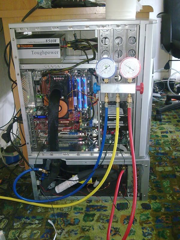

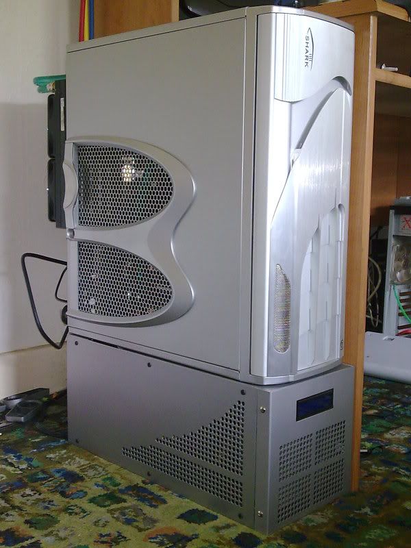

    right just a quick update after building up the pc around the vapo and case it looks like this
    i did have my old ati x850xt's in as my 8800gt's were not ready yet

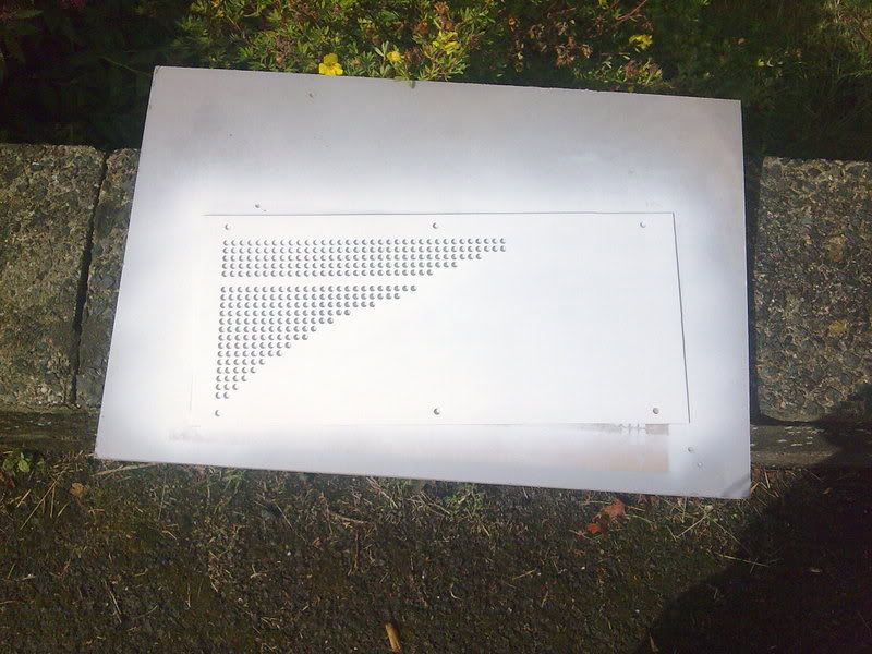

    all vapo case pannels were prep'd sprayed white then silver from cans the one side had a few dent's in it so it was filled then painted

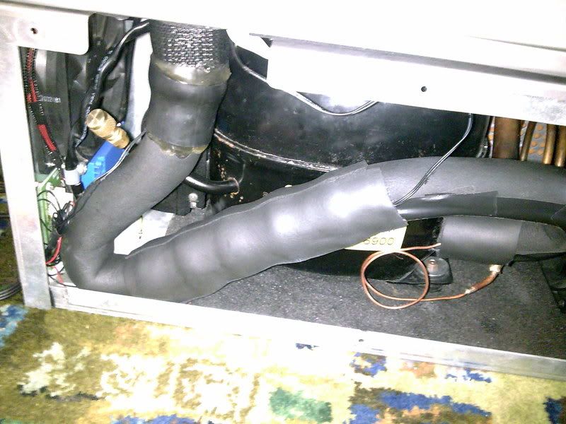

    i saw how some people soft soldered the cap tube to the accumilator and how others had used thermal paste me i just used vaseline as it was all i had to hand then i doble rapped it with armaflex tape
    put water cooling back in and the 8800gt's all done this is how it looks now
    also add'd a temp probe to suction line and compressor
    q6600 G0 @ 2.4ghz 95w
    R134a gas, temps holding nice sholud work well on 404a i hope lol
