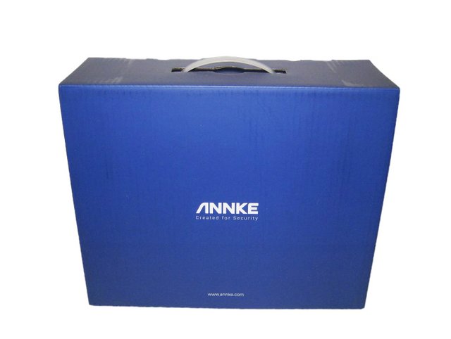

    This section of our Annke NVR N48PAW review will focus on the packaging and its contents. The N48PAW ships in a simple cardboard box. It’s a sturdy blue box that does a great job to protect the NVR. This cardboard face features the brand's name and logo.
    A sticker appears at the right side. It shows the model number and serial number.
    Inside, the appliance itself is protected by foam spacers, and is also wrapped in a thick plastic bag.

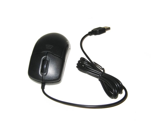

    USB optical mouse.

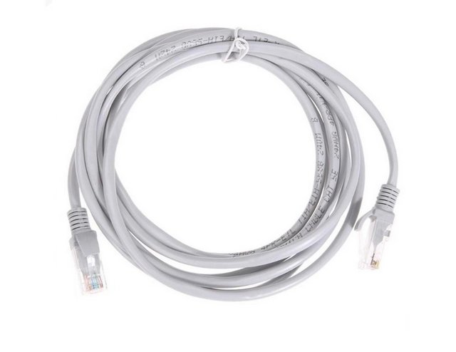

    Ethernet cable Cat.5e.

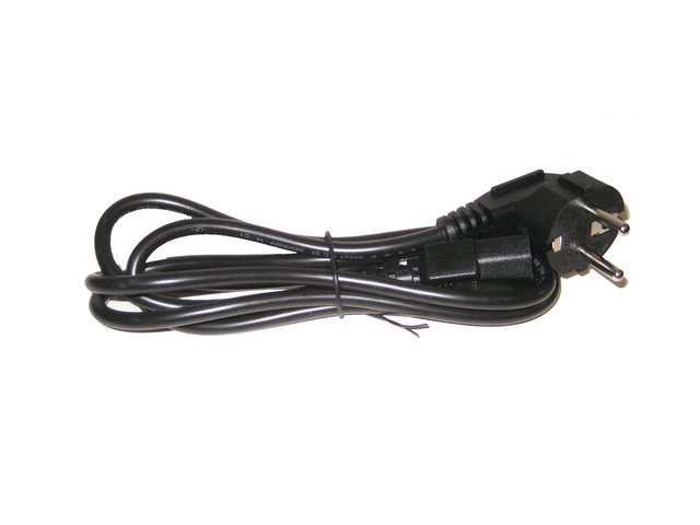

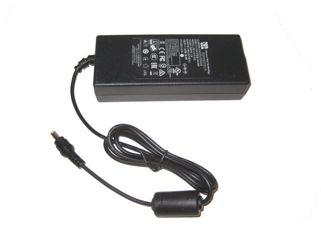

    AC power cord and Power brick.

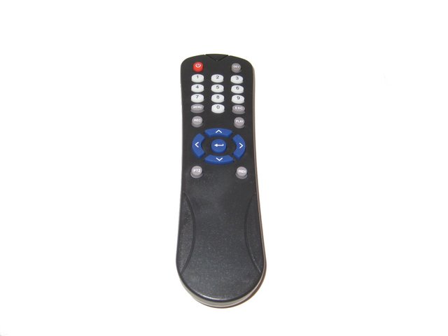

    Remote Control.

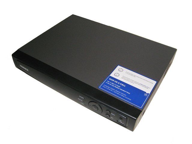

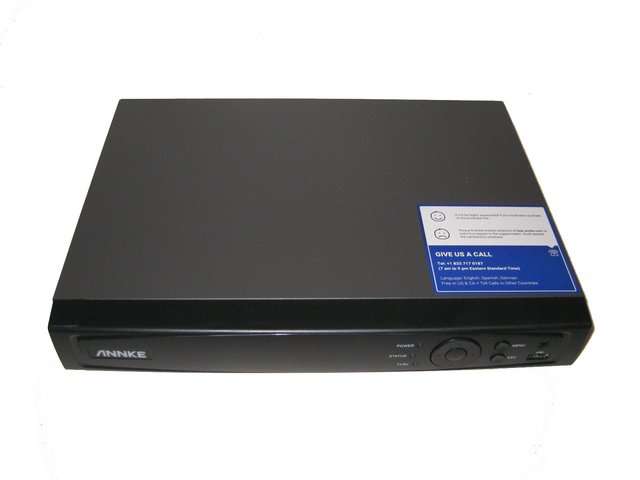

    The NVR looks a bit like a cable set-top box without an LCD display. I can’t imagine any NVR system being completely inconspicuous, however, this system does a fine job blending into the background. The NVR would blend in with any entertainment center containing your everyday media devices. The top of the NVR is plain. At only 12.4" x 9.4" x 1.9" inches, it’s not going to occupy that much space, but be aware that it does need to be in a well served place because you will have to add lots of Ethernet cables on its rear panel. The device is covered by a Gunpowder metal finish and, overall, it does have a slight industrial design, save for the black plastic front panel which helps distance the NVR from the looks of a regular Ethernet switch.

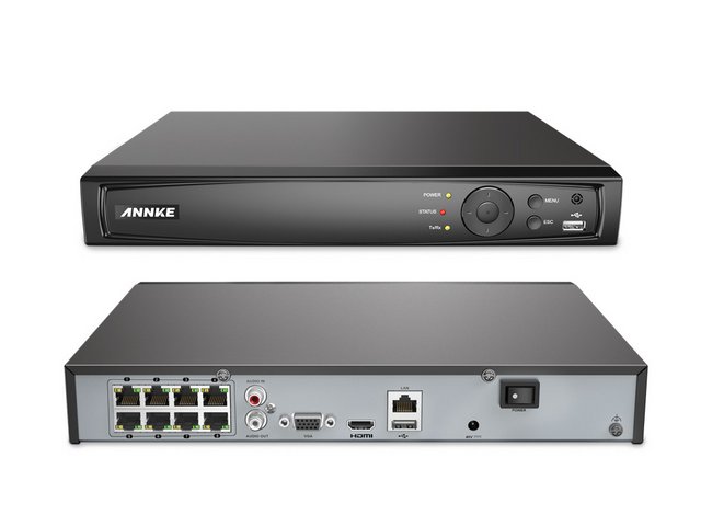

    The front of the NVR has LED indicators for power status, hard drive activity, and network activity. On the front panel, Annke has added all the controls and a USB port – it seems that the manufacturer was generous enough to add a secondary USB port on the rear panel as well (the front is useful for adding the provided mouse, while the secondary USB can be used to add external storage). Next to the IR receiver, there’s the Menu and the Esc button, followed by four directional buttons to help you navigate the menu.

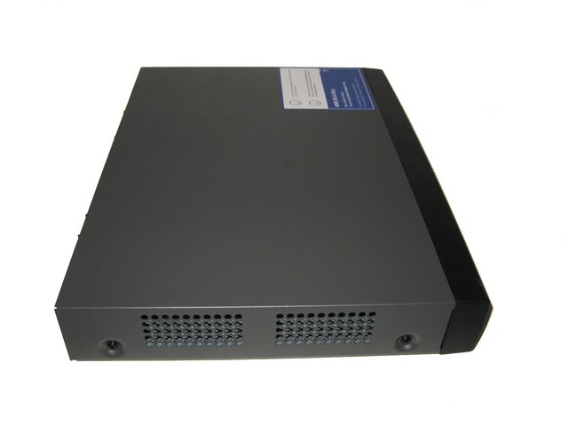

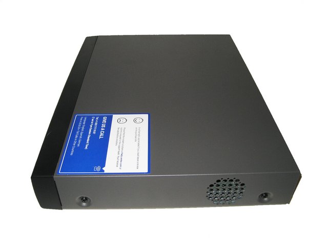

    The manufacturer did take seriously the heat management (considering that we’re dealing with a PoE device), so all around the case, there are various ventilation cut-outs. There is also a cut-out for a fan, but there isn’t one installed, the NVR relying solely on passive cooling. So it’s going to run silently and the good news is that the NVR N48PAW maintains a proper temperature (sure, it does get warm when you connect more than a couple of PoE cameras, but the NVR does not overheat).
    I saw some ventilation holes as well on the right side and on the bottom.

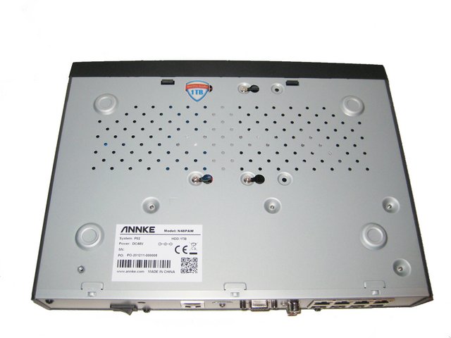

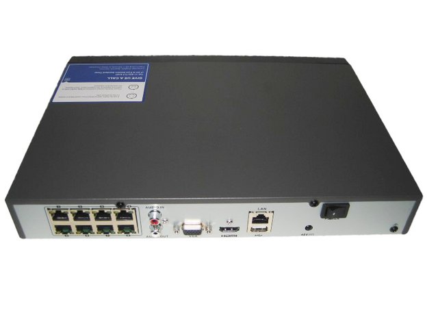

    Switch the NVR on the other side and here is where you can see all the remaining ports and connectors. First, there’s the DC (48V) power port and the On/Off switch which are followed by there’s the aforementioned USB port and the Ethernet LAN port. Next to it, there’s the mandatory HDMI port (there is indeed an HDMI cable inside the box). Further to the left, there is the good old VGA port and Audio In/Out ports. Lastly, there’s the the block of eight PoE ports which, just like the LAN port, are limited only to 100Mbps. But, considering the nature of the Annke NVR N48PAW, Gigabit ports would have been overkill, so Fast Ethernet should work just as well (and keep the price tag a bit lower).
    The bottom contains the model number, serial number, and external access code.

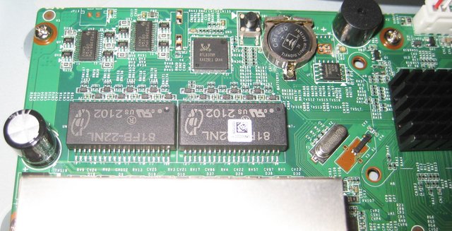

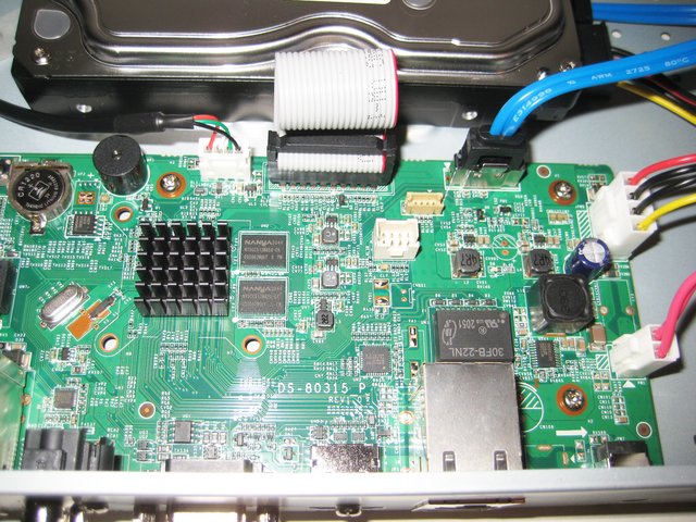

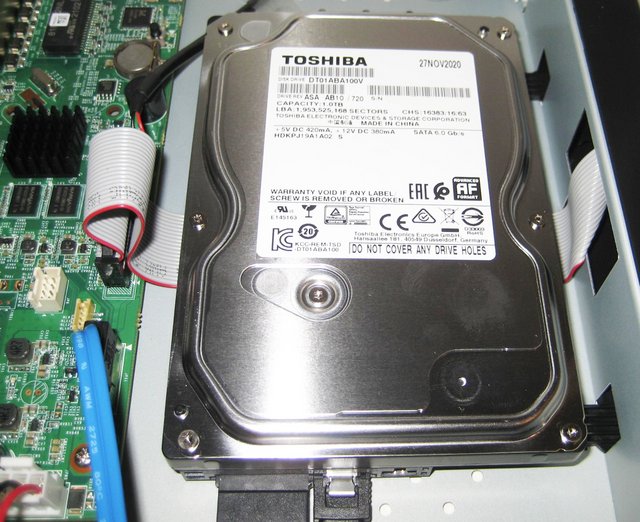

    I decided to open up my unit in order to see what components can be found in the Annke NVR N48PAW. There are two screws on the rear and two on each side that I had to remove and then I just slid the top panel towards the rear side. This way, I got the full view of the internal components and the PCB.
    I could identify two 81FB-22NL transformers from YCL, two TPS23861 IEEE 802.3at Quad Port Power-over-Ethernet PSE Controllers, a RTL8309N Realtek 10/100/1000Mbps Ethernet switch controller and two 512MB DDR3L RAM chips from Nanya (NT5CC512M8EQ-EK).
    The ANNKE surveillance system comes with a preinstalled 1TB hard drive as well from Toshiba (DT01ABA100V 1TB 32MB Cache 5900RPM SATA 6.0Gb/s 3.5") and it does support remote access. Following its 265 plus video compression, the streaming videos are much smoother and also they don’t take up much space. So, in the end, you get to save those bucks you would have used in buying an extra HDD.

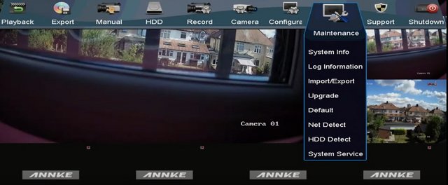

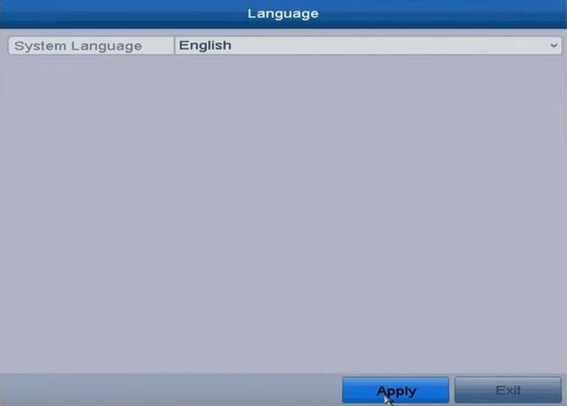

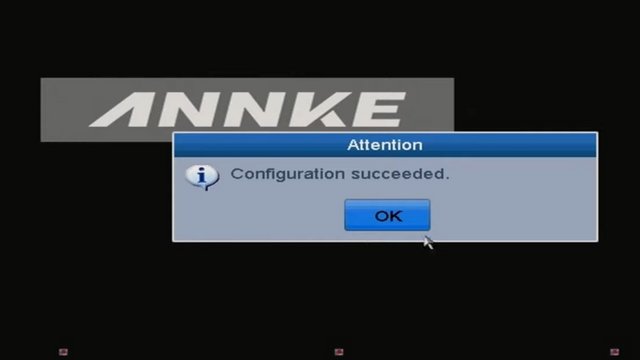

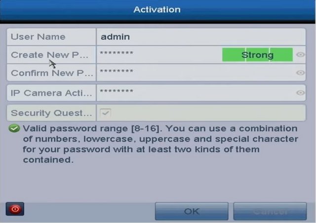

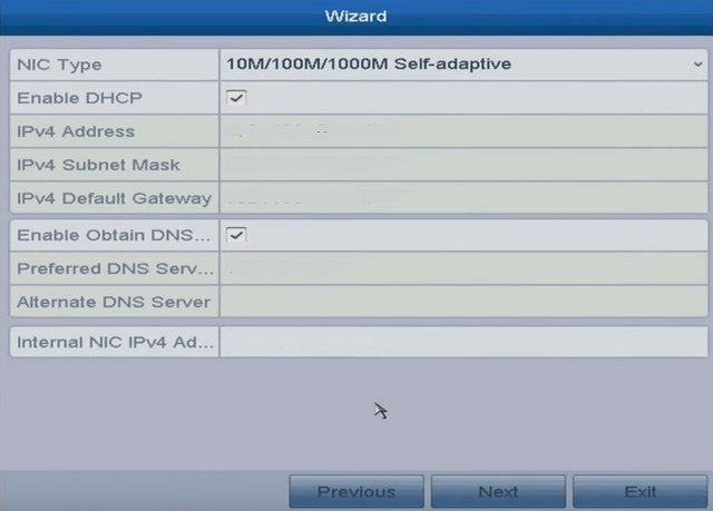

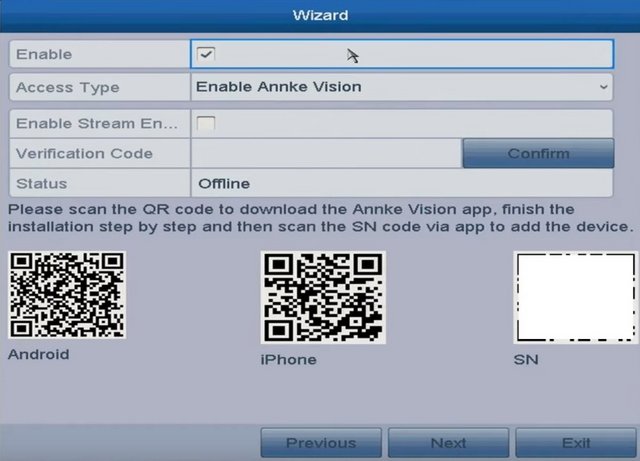

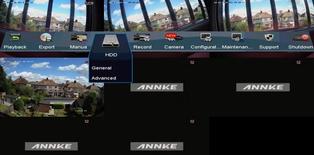

    Once you’ve installed the cameras you can plug the DVR into a HDTV or computer monitor. You then attach the system to your router, plug in the remaining power adapter, and plug the mouse into the USB port. Using the mouse, present in the package, we will be able to manage each parameter of these cameras by simply clicking on the right button of the main screen. Once all the hardware is set up, you can begin the on-screen setup this is a pretty simple process. The first time you turn on the system you will be asked to activate it. This requires nothing more than choosing an administrative password for the system. You next choose an unlock pattern in order to avoid having to reenter a password repeatedly. Finally, you go through the setup wizard.

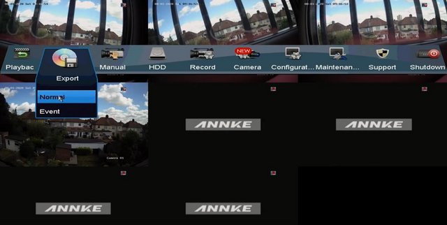

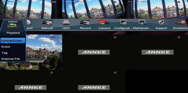

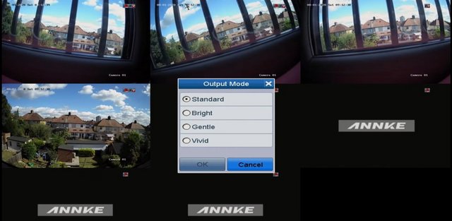

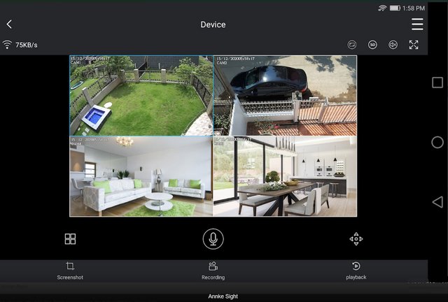

    Live view is the default display mode, and once you finish the setup process you’ll see all of your connected cameras in a nine-panel display (the ninth window is empty). You can toggle to a full-screen single-camera view, a 2×2 four-camera view, or an eight-camera view via the menu bar across the bottom of the screen. Clicking on any individual camera view brings up the menu bar for that camera. Options here include the ability to play back recorded video, activate live audio, and operate zoom on that particular channel. Image and camera settings, including motion detection, are also accessed here. Still on the motion detection, the system sends instant push notifications with snapshots to your email and the ANNKE app. With the customizable motion detection zones, the number of false alerts will be minimal and more accurate.

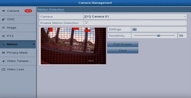

    The NVR itself just records things, the motion settings are on handled on the camera itself. You can manage this from the NVR interface, or from within the camera interface. The motion settings can be used for motion only recording allowing you to maximise the storage, but the main reason for an NVR is 24/7 recording.

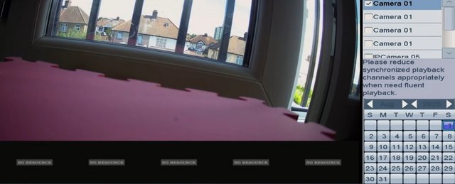

    Just check the channel or channels if you want to switch playback to another channel or execute simultaneous playback of multiple channels.

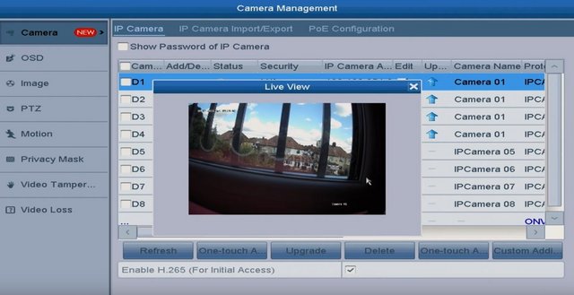

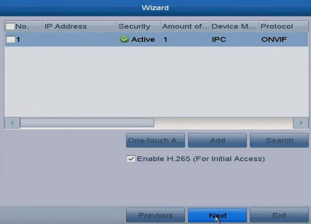

    Before you can get a live view or record of the video, you should add the network cameras to the connection list of the device.

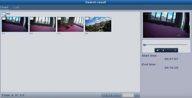

    Playback the record files of a specific channel in the live view menu. Channel switch is supported. Recorded files can be backed up to various devices, such as USB flash drives, USB
    HDDs or a DVD writer.
    Record files will be shown by chart or list in the export interface ,choose the files you want and click Export button to start exporting.

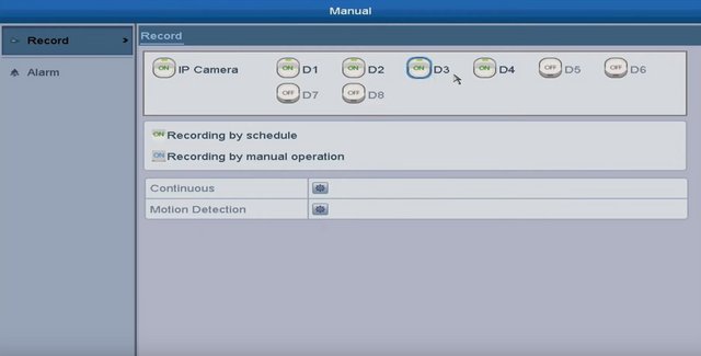

    Two kinds of record types are introduced in the following section, including Instant Record and Alarm.

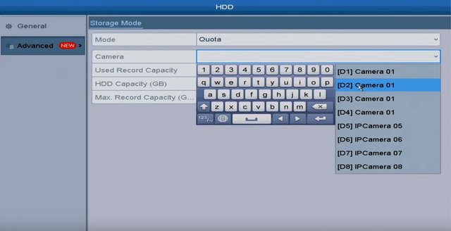

    You can group the HDDs and save the record files in certain HDD groups.

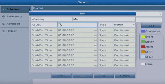

    Set the scheduled recording, and then the camera will automatically start/stop recording according to the configuration of the schedule.

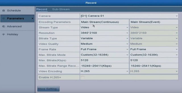

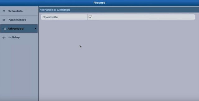

    You can set up record encode parameters on Annke DVR.
    You can choose a higher resolution of your cameras to have a more clear view, enable orH.264+/H.265+ to have a longer recording time, and choose automatically overwritten HDD to continue long recording.

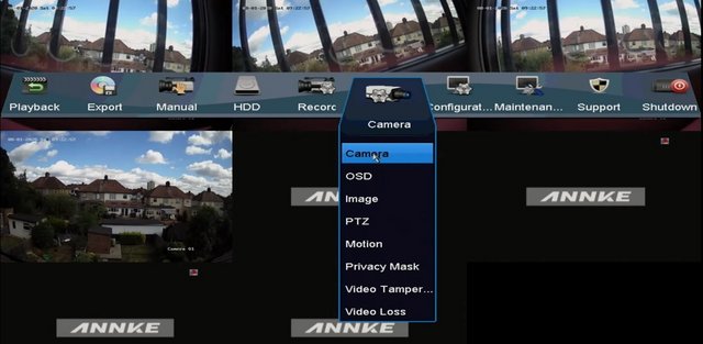

    The basic information of the camera lists on this Tab. You can configure the basic setting of the IP cameras.
    The live view screen on the Web interface allows us to monitor cameras lively on the computer.

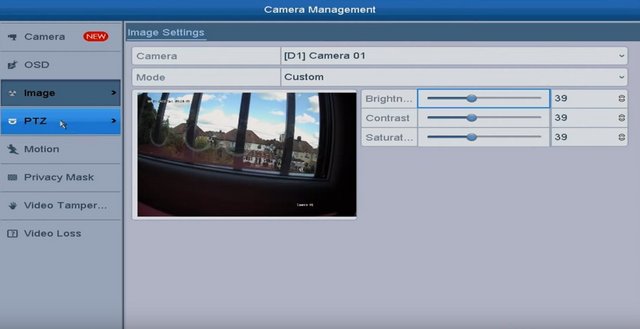

    You can configure the OSD (On-screen Display) settings for the camera, including date /time, camera name, etc.

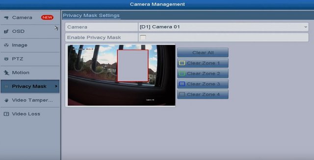

    If the camera is installed in a public place, some of the areas can not be monitored without permission due to the privacy law in some countries.

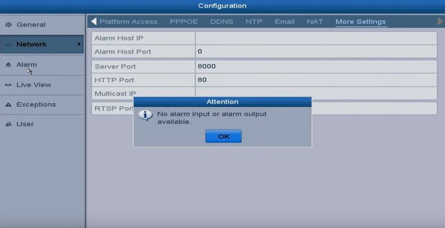

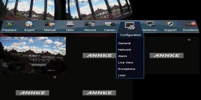

    You can set up more settings such as User name, exceptions, etc.
    You can enable the Cloud P2P, and check the network status and find the verification code on this page.

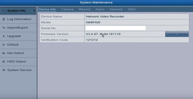

    You can view the system information about Annke NVR N48PAW.

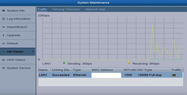

    You can view the statistics about the bandwidth of IP Camera, Remote Live View, Remote Playback, and Net Total Idle.

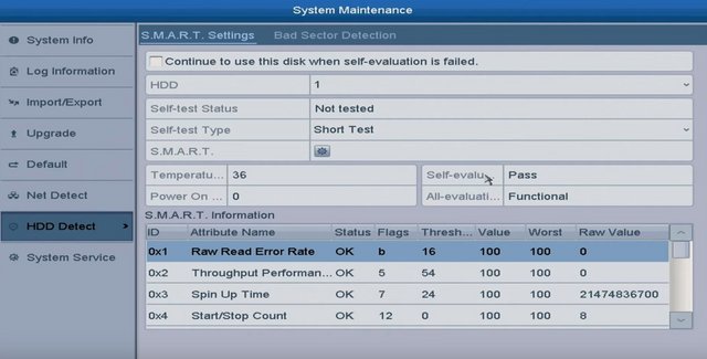

    You may check the status of the installed HDD so as to take immediate check and maintenance in case of HDD failure. You can rely on the storage of all your movies hard drive present within the NVR, which matters 1TB of space (981GB real). We point out, however, that after two weeks of use, of all 4 cameras, 10% of the total space has already been occupied. We therefore recommend setting theauto deletion of old movies, which can be managed manually.

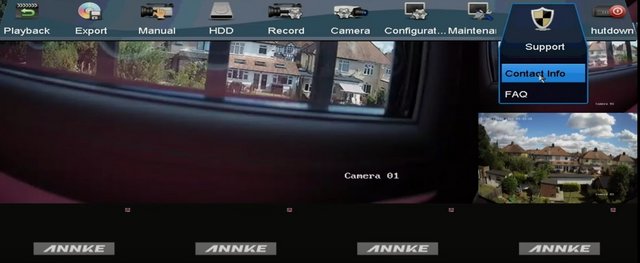

    Contact info Tab.
    Finally a Shutdown-Reboot Tab.
