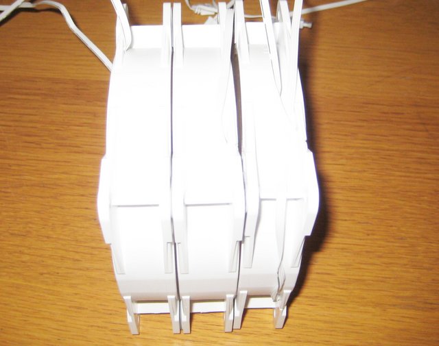

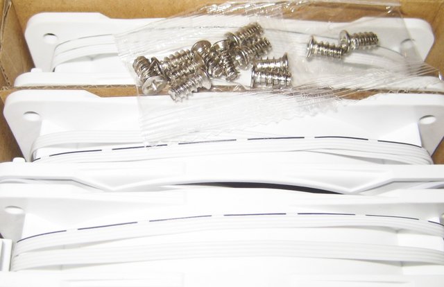

    Inside the box, the fans are inserted almost close to each other and are separated by cardboard partitions, and on top there is a small bag with twelve screws for fastening the fans. These screws are necessary for installing the fans on your chassis. There is no lighting controller provided with it.

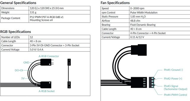

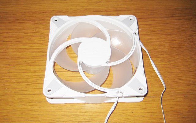

    The P12 PWM PST A-RGB 0dB fans have a dimension of 120x120x25mm. The difference between any two mounting holes is a standard 105mm. the thickness of the frame on the mounting holes is 3.50mm. The mounting hole has a diameter of 4.50mm. It weigh 131 grams each with 163 grams declared in the specifications. The impeller diameter is 108,5 mm and its height is 18 mm. According to the specifications, the fan should consume 1,32 watts, we got an uncritically more – 1,44 watts.
    Externally, the new Arctic P12 PWM PST A-RGB 0dB looks neat and aesthetically pleasing. White and gray, always go well, here, too.
    There are two arrow symbols on the side frame. These indicate the direction of airflow and the direction of blades movement. These arrow symbols provide a visual aid to novice users in identifying the directions before the installation.

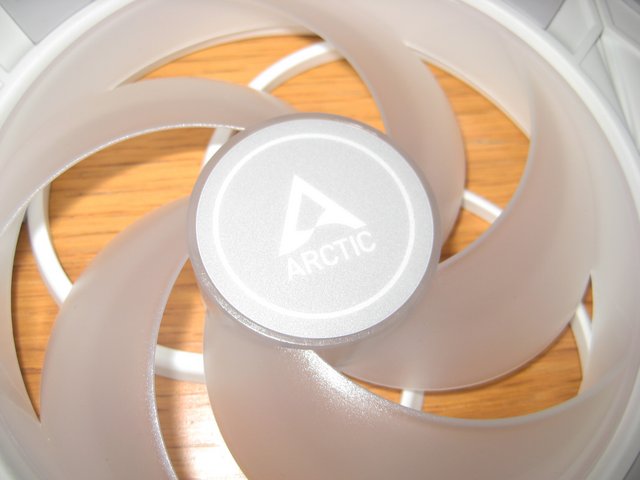

    The center has ARCTIC branding on it. The blades are translucent and their tips are connected to the translucent ring running across the diameter of the outer frame. The blades are made in the best traditions of the original Arctic P12 – sickle, aggressive and with sharp leading edges. The Arctic P12 PWM PST A-RGB 0dB fans use twelve A-RGB LEDs to completely illuminate the rotor. The backlighting of the fans can be controlled through applications for motherboards from four major manufacturers: ASUS Aura Sync, Gigabyte RGB Fusion, MSI Mystic Light Sync, and ASRock Polichrome Sync.

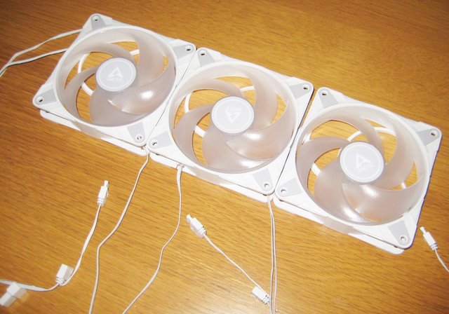

    Manufactured on a white plastic frame , each mounting corner of the fan has a gray color cut-to-size anti-vibration pad pasted.
    Another additional feature that Arctic included in this new Set of Fans is something called 0db Mode. Usually, when controlling a Fan over a PWM connection, it is possible to let a Fan spin between 0 and 100% of its Fan speed. (Though there are a couple of Motherboard Softwares that come with a Minimum-Limit). When letting a Fan spin beneath a certain percentage, it can happen that the Fan is not spinning long enough to keep its momentum until the next PWM cycle (See PWM Wiki Page for more information). This behavior can result in repetitive Clicking or Motor Ramping noises for each cycle, making it impossible to sit next to it. Therefore Arctic Implemented its own version of a Stop-Limit, which forces the Fan to stop rotating once the Fan speed reaches below 10%. They have a speed rating of 0 ~ 2000 RPM with a maximum airflow rating of 48.8 CFM and a static pressure rating of 1.85 mmH₂O. Their sound level is rated at 0.30 Sone.
    These fans are using Fluid Dynamic Bearings. ARCTIC has mentioned that they have used a combination of alloy/lubricant developed in Germany to reduce the friction within the bearing. This in turn would generate less heat and improves efficiency. This will increase the service life of the fans.
    On the opposite side we can see that the rotor is held with four quite thin plastic anchors and in the shape of the blades so as not to hinder the air flow. The fan stator diameter is 42 mm. It is closed with a plastic cap with stamped markings and electrical characteristics.

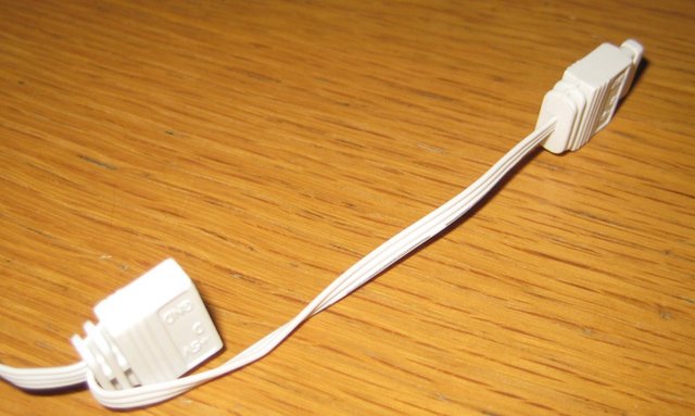

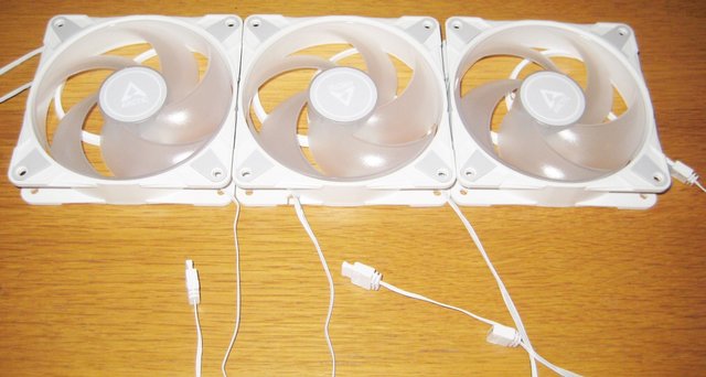

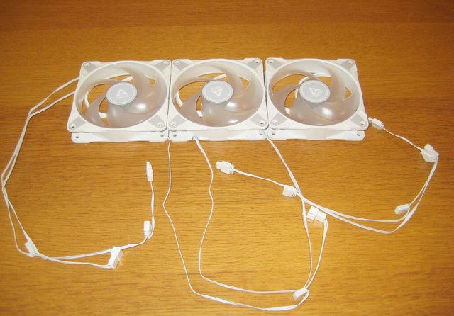

    Each fan has two sets of cables routing out of the center. One is the 4-pin PWM cable with the socket and the other is 4-pin 12V RGB female connector with an extended length on the male connector. This would allow for daisy-chaining the fans for a synchronous operation and uniform effect. The starting voltage of the fan is 5V. The fan is rated for 12V using 0.11A. The below picture shows the 4-pin PWM connector with the 3-pin socket connector.
    The below picture shows the standard 12V RGB female and male connectors. Both connectors, both power and lighting, have a good length of 40 cm.

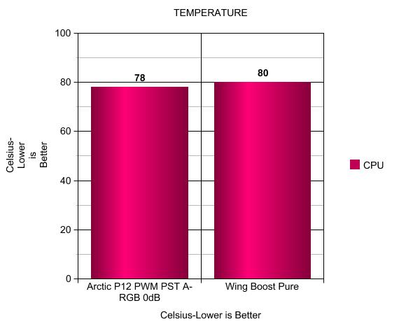

    Installing the Arctic P12 PWM PST A-RGB 0dB was easy, and it’s just like with all other Arctic products. We installed and secured it using the provided screws, then attached the PWM and addressable connections to it. To test the performance as a case fan, I put them in direct comparison to other fans. The test system consisted of a Ryzen 5 3600 , which is installed on a MSI X570-A Pro. This was cooled by a Alpenföhn Matterhorn Pure. Together with a GIGABYTE RX 5600 XT Gaming OC this was installed in a Fractal Design Define 7. To obtain comparable results, the CPU and GPU cooling were set to constant values. As a basis for the comparison, all fans were set to 900 RPM. This was the limit at which the P12 PWM PST A-RGB 0dB became audible from the closed case, from a distance of about 50 cm. In this case a slight airflow is audible, but I personally do not perceive it as disturbing. In order to warm up the case properly, 20 minutes of Prime95 ran with the settings “Smallest FFT” and Furmark. After 20 minutes load, CPU and GPU temperature were measured.
    It is noticeable that in this small test round, the P12 PWM PST A-RGB 0dB were the most efficient. The performance is positively noticeable.
    If we now want to replace a CPU fan, a similar picture emerges. To test this, I first put the standard fan of the Matterhorn Pure under load for 20 minutes with Prime95 and measured the temperature and then repeated the test with the P12 PWM PST A-RGB 0dB. Here the fan shows its not only suitable as a case fan, but also as a fan replacement for the CPU cooler, or even on a radiator.
