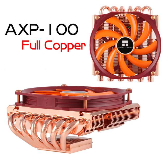

    Copper CPU coolers have been around for at least a decade now and although they do offer superior cooling efficiency compared to aluminum models both their price/cost and weight have made them a far less popular choice among manufacturers. That being said all-copper models I've seen released to date have been surprisingly popular among enthusiasts, modders and even some overclockers over the years so I'm actually surprised we haven't seen more over the years. Thermalright decided to offer its solution with the updated cooler Thermalright solid copper AXP-100. This low-profile, small form factor cooler sheds the aluminium fins of its sibling for the increased thermal conductivity copper provides. With the switch in materials comes a drastic increase in weight with the AXP-100 Full Copper coming in at 640 g with the fan. That is almost double that of the AXP-100 RH, and about the same as the AXP-100 Muscle. Offering a no-interference design with a height of just 47 mm, It will certainly prove to be an interesting option for those planning even the smallest of SFF systems.

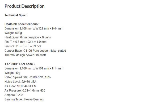

    The back lists the specs of the heatsink.
    The basic specifications of the fan are on the right side of the package.

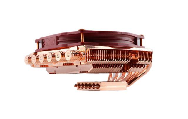

    The heatsink is made of copper as advertised. It looks simply great.
    The base plate, heat pipe, and radiatior fins are all made of pure copper.
    Due to the use of copper, the heatsink is extremely heavy for the size at 640 g. While the weight is not surprising considering the material choice, it does have added benefits, of which one is a stiffer, stronger design. The fins themselves feel solid with very little flex, and as a result, I found none of them bent upon initial inspection. Other benefits of copper include the ability for it to absorb more heat than aluminium. However, while that is true, aluminium tends to absorb and dissipate heat faster.
    There are a couple gaps in the fins at the edges of the heatsink that are used to get a screw driver down to the mounting crossbar.
    You may have already noticed a small detail that Thermalright added from the image featured on the front page. They put their logo on all the heatpipe end caps. It seems to be a small thing, but it shows the manufacturer's attention to detail.
    The cooler uses the well-known T-shaped "down draft" design, in which the air flow is directed perpendicular to the mainboard, which allows the cooling of the surrounding motherboard components at the same time.

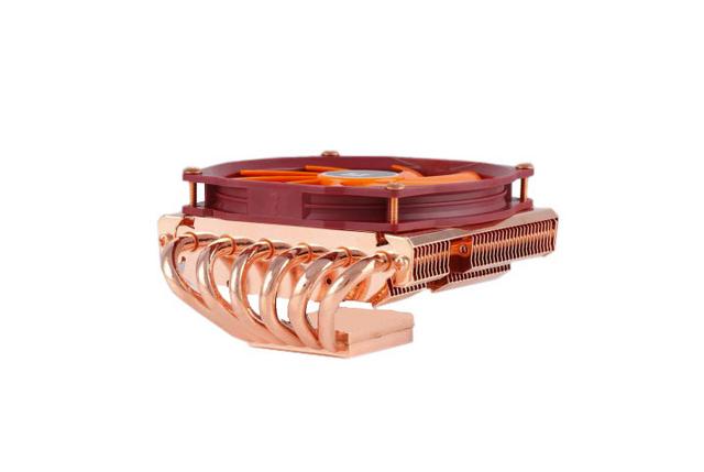

    Six 6 mm thermal tubes Thermalright soldered to the base of the cooler. Heat pipes describe the arc and connect the base with the radiator, which is located parallel to the socket.
    A bracket allow the fan installation. The scope of delivery includes screws for mounting the fan.The 100mm fan can be replaced with an 120mm-140mm fan by using the attached conversion bracket. The bracket can be mounted rotated in 90 steps. The mounting holes of the frame on the cooler are slit-shaped, thus allowing the horizontal or vertical movement of the fan by roughly 15 mm depending on the orientation of the fan bracket. By offset movement, interference with the graphic board installed in the PCIE slot can be avoided.

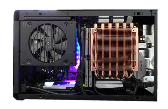

    Installed - Memory Clearance
    You can see there is plenty of room for medium to large heat spreaders to fit. Any graphic card can be used when this cooler is installed.
    Since it doesn't completely clear the memory area when it is slid to the left, very tall heat spreaders may cause issues in that slot nearest the CPU.
    This is what I meant about it adds flow to either side of the CPU cooler. As it is set now, it can add flow to the memory, but not as much as a dedicated fan cooler. If it were reversed, it would add flow to the MOSFET heat sinks, just in case you want to overclock still.

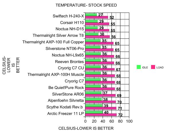

    Results - Temperature
    The AXP-100 Full Copper handled this testing really well. The Full Copper ran a few degrees cooler in every test, averaging out the results I found that the AXP-100H Muscle averaged 68C where the AXP-100 Full Copper came in at 65C so three degrees cooler on average. That is an impressive performance jump with the same heatsink and fan design, just with a material swap.
    You do have to keep in mind this cooler is TINY and is not made for high performance systems where you would have an AiO or larger tower cooler.
