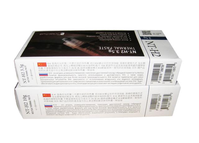

    Noctua's NT-H2 comes professionally and thoughtfully packaged, just as we'd expect it to. As with all the Noctua products, there is an overview of the key features on the front, and more detailed specifications and explanations on the back. Noctua has released the NT-H2 thermal paste in two different packages. A standard 3.5 g and larger 10 g tube.
    The sides have features printed in 5 languages.
    Noctua still sell its NT-H1 compound and it is also now being produced in larger 10g tubes. Noctua has extended this new format of package to its old thermal paste.

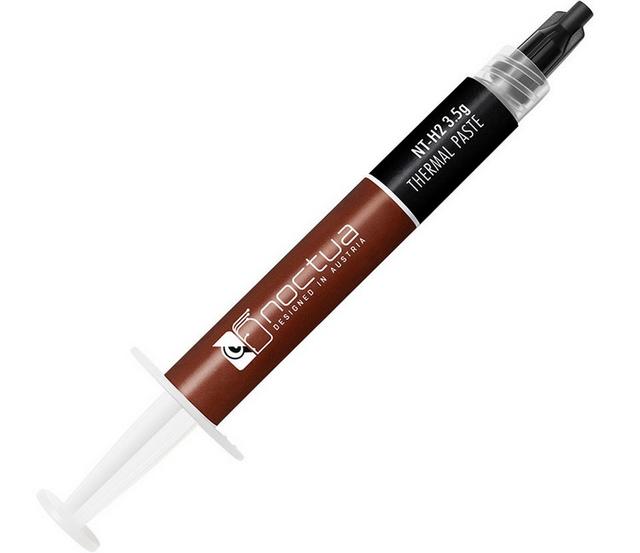

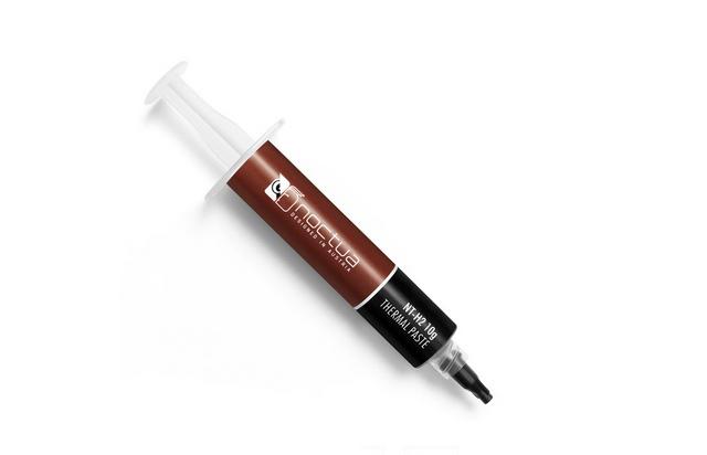

    Noctua's NT-H2 comes in a syringe. There is only minor information on the outside of the syringe, including a brief description and some usage warnings.
    The NT-H2 compound is a medium shade of gray in color, and it is very thick and dry. When spread out with a razor there is no shine, which is evident of the dryness. The compound is easy to spread. I have to say it's like the consistency of a thinned peanut butter. I guess that's the best way to describe it, but it is very easy to spread.

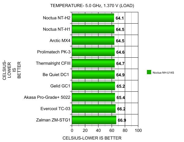

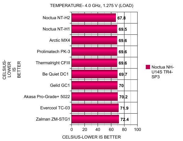

    The results on an 8700K show that thermal paste is still a very close contender no matter who the manufacturer is. It shows that whilst Noctua NT-H2 was the lowest on, it had a joint win with many other pastes from other vendors.
    For the TR4 load tests, it shows that Noctua NT-H2 was victorious again but this time by a large margin. Performance differences show more clearly the higher the heat load is. For example, the performance benefit of NT-H2 over other pastes may not show on a 95W 8700K processor, but will usually show very clearly on a 180W AMD Ryzen Threadripper 1950X CPU like in our case.
