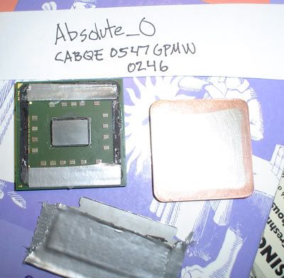

Hey Absolute, I got a question for ya. I put little square pieces of electrical tape at the corners of the core, stacks of four, cause I saw a post you put up in some forum saying it worked for you(in making seating of HSF or waterblock more stable). It's working good so far, but I was wondering if they stand the chance of melting and getting things messy...

No, it won't melt. The core is what gets hot and if you're running naked the core isn't really exceeding 40c, that won't melt the tape. Anyway the tape should be on the corners of the PCB and the PCB doesn't get as hot as the core it's maybe.... say 30c, which is equivalent to a hot day.Quote:

uhhh...i put them right at the corners of the core...not touching, but pretty close...the hottest my temps have gone is 45C, but I'm still worried.

dude, you're supposed to put the tape at the edges of the chip, not around the very centerQuote:

i don't have any pics of the 4 squares, but i've got a shot with 2 rectangles along the edges

tape goes on the edges of the PCB, to make them higher, so when you mount your hsf it's harder to hit the core from an angle and chip it. No point in snuggling the tape right up against the core.

the tape isn't on the core, but near it. Wish I had been a little more thoughtful and devised your setup though. I understand that you think I'm an idiot, I feel dumb right now too. Thanks for the help!Quote:
