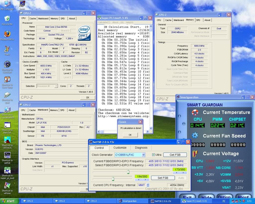

heres is my latest.very pleased with memory performance so far.
http://i39.tinypic.com/2hn5hzb.jpg
http://i35.tinypic.com/zmhxqx.jpg

zsamz,i dont have a dmm right now,so say im using vtt of 1.15 what would you suggest i should set in bios(to get 60-63%)to start with?ranges for trial and error that i can use for all three GTL's,the two cpu's and the NB?
thanks.
500 FSB would be awesome!
Alas I m using non-QVL RAM and someone else from XS told me it might be D9GKX.
Any much higher-430 to 440ish and I fail memtest #5 right at the very end of test even with PL 8 and NB volts up to 1.5:eek:
Is this indicative of having to master the read delay Pulls?
I had fun with my old chip:D I am currently running an E8500.
The chip in my Sig is actually a Cedar Mill Die which is half a late-Gen Pentium Dual-Core or a Presler Die. The 6X1 series was the one with 2MB of cache instead of 1MB like Prescott so in other words I actually had a chance playing Crysis on high:p:
The 631 model in specific Set the world record for Raw Speed Clocking in at about 8.1GHZ:shocked: on LN2 so I thought-why not-maybe I could pull off 5.0 on Air?Nope. But Max 4.5GHz@1.45V/15=301FSB*3.34=1003MHz DDR
PL 3 wasn't bad either-I got 50% OC! I kicked in the full 2:1 A couple times for 1200 and got R-9512 and t-68.3 with that setup but It wasn't really Gaming/Prime stable and I was already at the Chip's FSB wall anyway. It was swell but the swelling's gone down:p: So I got E 8500!
I am inspired now to see if I really can go higher with my E 8500/RAM/Mobo Combo when I have some free time.

Well it's been around >1yr since I packed away my DFI UT P35-T2R. But now I have dusted it off, flashed to 09/19/08 bios and plucked in my first of five E8600 Q820A599 cpus with 0537 serial number. Too lazy to do fresh WinXP install, so grabbed my DFI DK X48-T2RSB Plus WinXP install SATA drive and just used that :)
Haven't tried 32M stability, but started off with max FSB testing for 1M and cpuz validation. Ended up around 585FSB easy 1M, 590FSB finished but BSOD before I could save screenshot and 606FSB was best I could do for validation.
Using DFI MegaHalem air heatsink with 120x25mm Thermaltake 81cfm fan and Corsair AIRFLOW assisted PWM cooling :D
http://nx.i4memory.com/reviewimages/..._megahalem.jpg
http://fileshosts.com/intel/DFI/DFI_...m_11s281ms.png
http://valid.canardpc.com/cache/banner/521499.png
http://fileshosts.com/intel/DFI/DFI_...cpuz_valid.png

hey everyone i currently have a E6300 at 3ghz 7X430
heres some screenies
http://img.techpowerup.org/090307/Capture.jpg
any advice how to maximize my overclock/make more efficent
